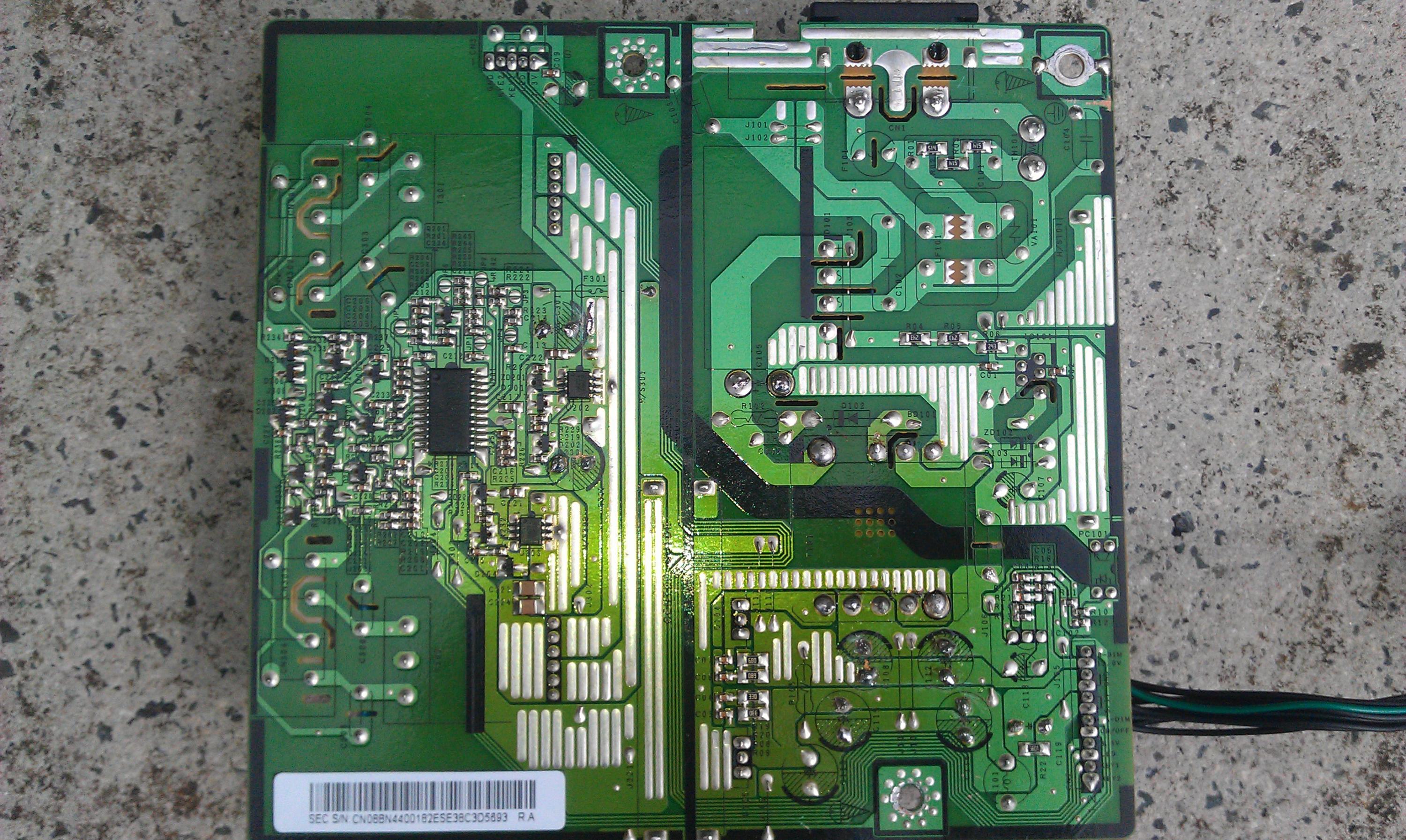

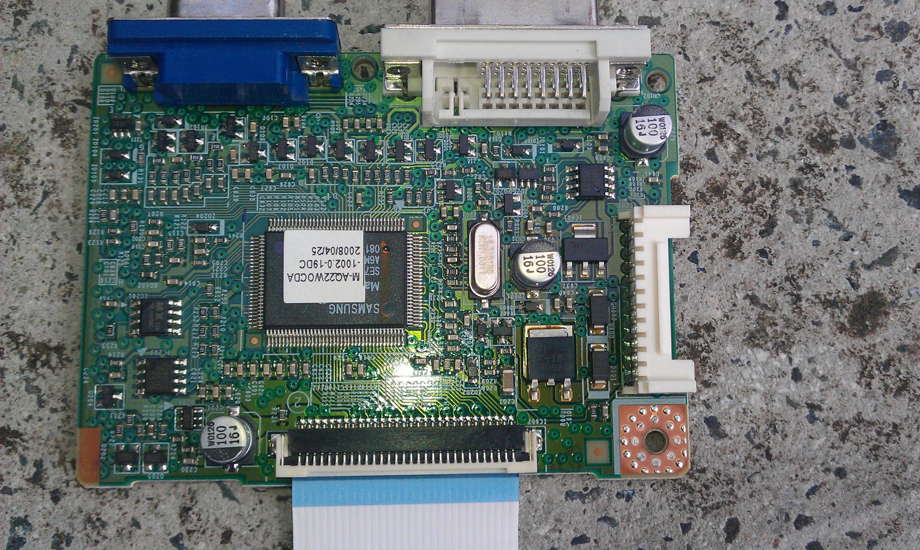

              pics of boards as requested

                    Very good pictures -thanks have you tested the small green fuse in the middle of the power supply board.

                        Can you test the voltage at each side of the F301 fuse use a ground screw for the black probe

                          pin8 is for backlights on/off. 0v = off, I expect it to be >3vdc. It will go high when the monitor is first turn on, it will go low later if it does not detect the video signal from the PC, same thing for the voltage to the T-CON board on the LCD panel. If you remove (do not do it with the connector connected due to output drive may be at logic lo) that connector from the main board and use 1K resistor between pin8 and 5V, that will force the backlights to come on.

                            Board IP-49135B, seems I had one of these in a 743-something display.

                              As suggested Pin 8 switches the Inverter on, and is usually about 3volts Dc from the Logic Board.What you can do is plug in your lamps,switch Power onto the Board leave the logic board not connected and the on off not connected,then apply 3v DC from a Bty between Pin 8 and one of the Ground connections, tha latter being a substitute for the Logic Board 3v, and the Lamps will normally light if all is well with the Power board ??

                                  From your pictures, it should measure about 13-14V, considering that screw hole near the logic board connector.
                                  Possibly your meter was in a wrong scale ? was it in AC maybe ? 94V should have blow the caps in that line.
