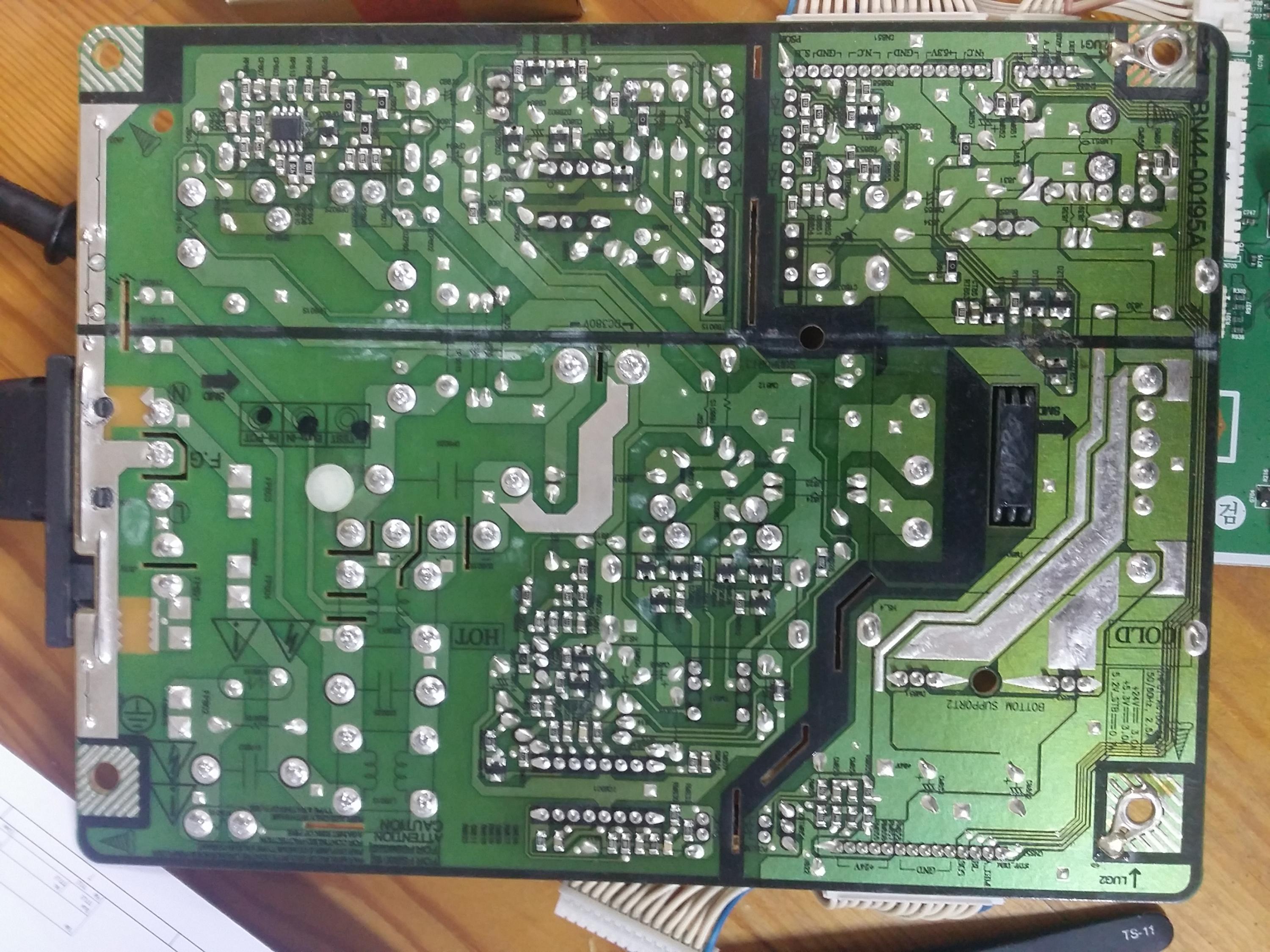

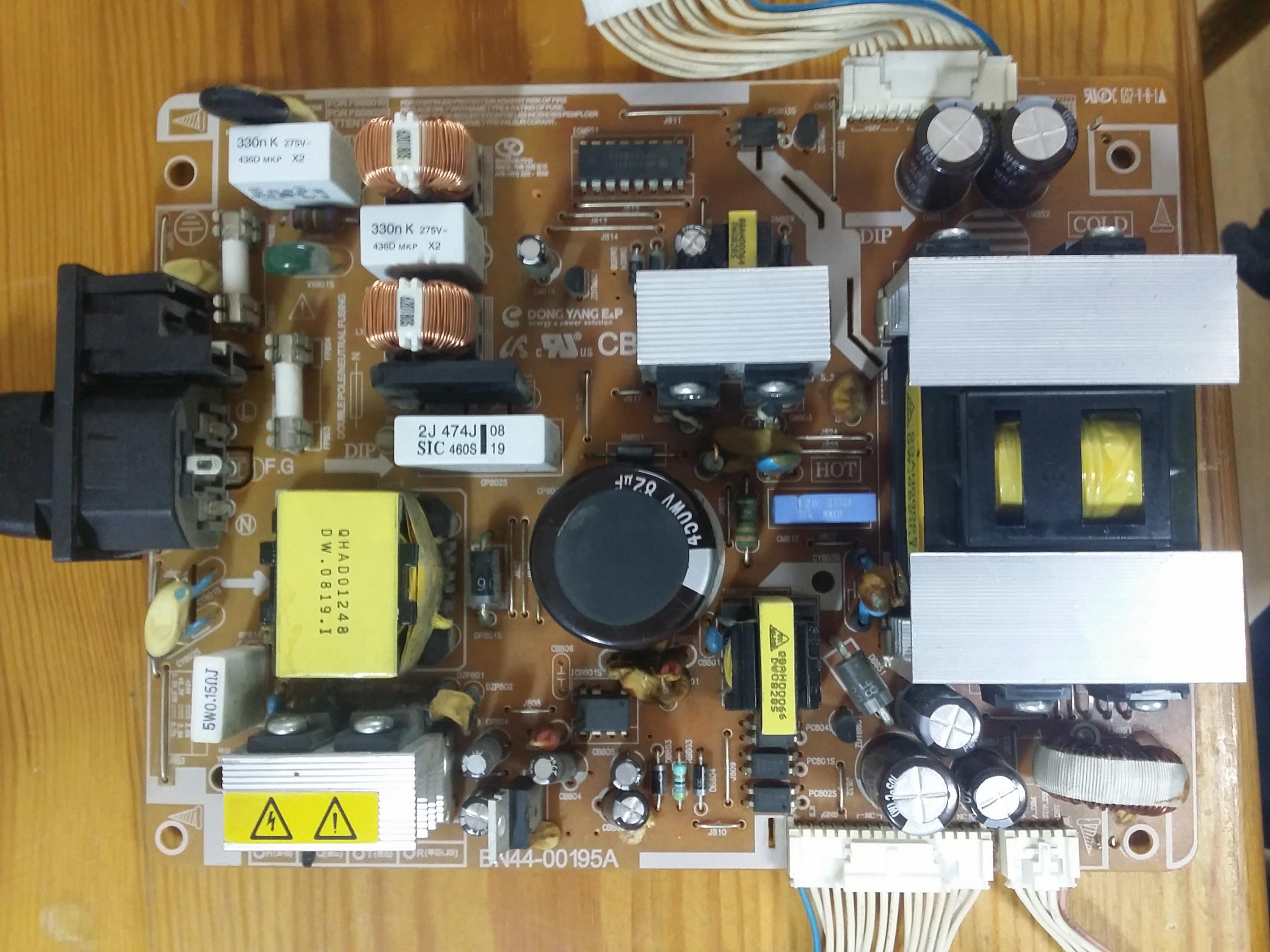

                      • AcsNorbi84
                        • Mar 2016
                        • Hungary
                        #91
                        Re: Samsung 24" power supply BN44-00195A first stage voltage?
                        Hello everyone!
                        I hope this thread is still alive!
                        I have a broken samsung 2493HM monitor with a power board BN44-00195A. The previous owner described that there was a small exploding sound before the monitor went wrong. However I cannot find any broken parts on the board. I have read all previous posts regarding this power board, and this far I have removed the factory glue and re soldered the main parts. All SMD resistors, diodes, the fuse resistor, the FATs are looking OK, but the power LED is blinking, and there is a random sizzling sound coming from the board. Is there any suggestion what I should check, or replace?
                        Two pictures from the board:
                        http://kepfeltoltes.hu/160314/IMAG22...toltes.hu_.jpg
                        Thank you for your help in advance!
                        Best wishes,
                        Norbert

                          check the resistor infront of QM802. I have the same problem but not found the issue yet.
                            Can you measure the voltages and are they there or stable -- i reckon you check the main filter cap.
                              Checked QM802 and QM803?
                              Could have blown without visible signs, or maybe blown on the bottom or back where you can't see it.
                              Sometimes semiconductors can blow with very small holes which are almost unnoticeable.
                              Like Pauldesign says, check all your output voltages and the voltage on the primary capacitor. Write what you get.
                              There are three output connectors, list the connectors, pin names, and what voltage you measured on each pin.
                              -David VanHorn
