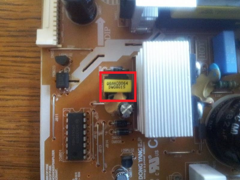

        please excuse my late reply. In this week I bought the alcohol in a pharmacy. Yesterday I've tried to clean the components better. Even so it is not so easy.
        I have a transistor (QB801) unsoldered which was full of this adhesive.
        I do not know if I made him when desolder broken or it was already broken. Anyway, I've tested it according to these instructions Click (sry in german) and therefore the base-emitter is high impedance and thus the transitor is defective. The Part Number is D526-Y.
        In Germany I have not found a way to order one. Perhaps there is an alternative that I can take. Does anyone knows an alternative or a shop where I can order it?
        Did this transistor anything to do with controlling the backlight?
        Slowly, I'm desperate.

          Suggest the full number is 2SD526Y,and these are usually available

                This is the spec sheet for the transistor:
                Higher rating will be OK.
                This transistor supply the regulated B+ for running the PFC IC and SMPS IC.

                    after I couldn't get any compensation from the alleged defective transistor, I have soldered it again. I was amazed when I was able to measure the 24V to the inverter. A few times I made on / off. Every time the 24 volts were there. Then I did connected it again to the panel and had a picture immediately. Apparently, to clean it has helped. The transistor test, I probably misinterpreted.
                    I'll be watching it today and tomorrow, before I finally build it back together. I hope it stays that way. Thank you again.
                    Greetings from Germany
                      #70
                      Re: Samsung 24" power supply BN44-00195A first stage voltage?
                      Glad to hear it working, that transistor supplyies the voltage to run the PFC and the 24V power supply section, so if the 24V went away again, now you know where to check.

                                  Hello, this forum has helped me a lot in debugging.
                                  I also have a BN44-00195A PSU in my Samsung Syncmaster 245B.
                                  For me, however, the error was another.
                                  For me, the transformer TM802 has been destroyed by the bad glue. Thus, the FETs QM801, QM802 and resistance RM801 have been destroyed.
                                  As a replacement for the FETs I used the type IRF840A.
                                  And to replace the transmitter TM802 I used by Würth Elektronik the transformer 749196301. It must always be connected in series two coils. This one again has 3 coils. It has to be absolutely paid attention to the correct polarity (points in the diagram).
                                  For the resistor RM801 I took a normal 0.22 Ohm and 0.6 watts.
                                  The monitor is now working properly again.
