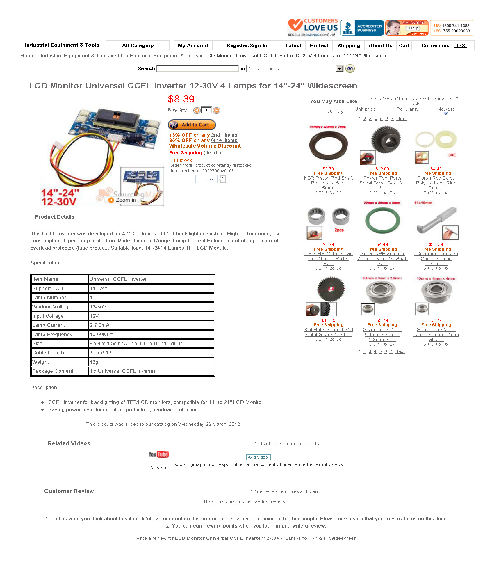

                                    ilikesteel, thank you for finding this inverter.

                                      Re: IBM L170 17" monitor "2 second on then black"
                                      Bud check this one out.
                                      http://www.ebay.com/itm/220807798195...84.m1423.l2649
                                      Of course I think you have made your own, haven't you?
                                        Thanks, yes I saw that one, ilikesteel sent me the link also, but the one for $9 that will drive 4 lamps is ar real good deal for DIY repair.
                                        Yes, I made my one using old guts from broken monitor.
