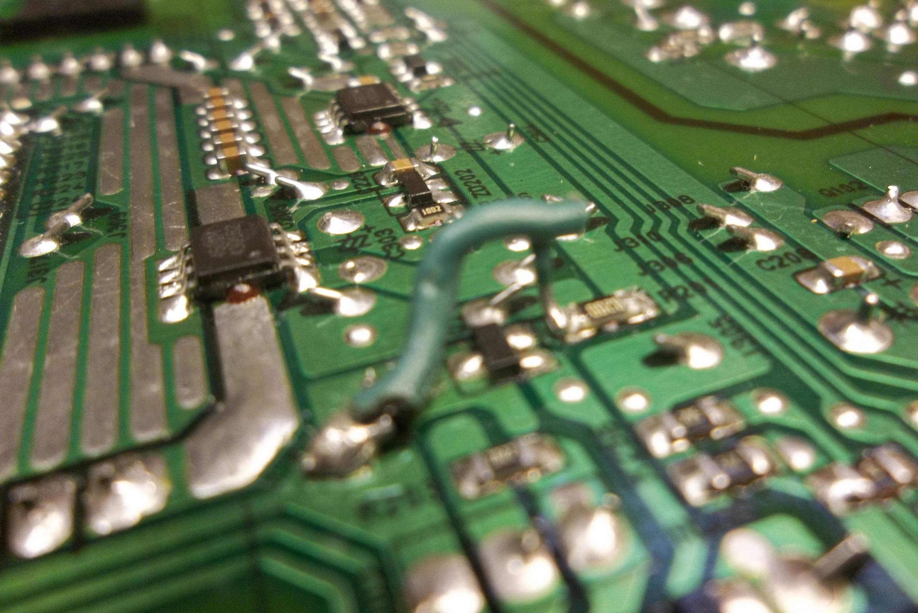

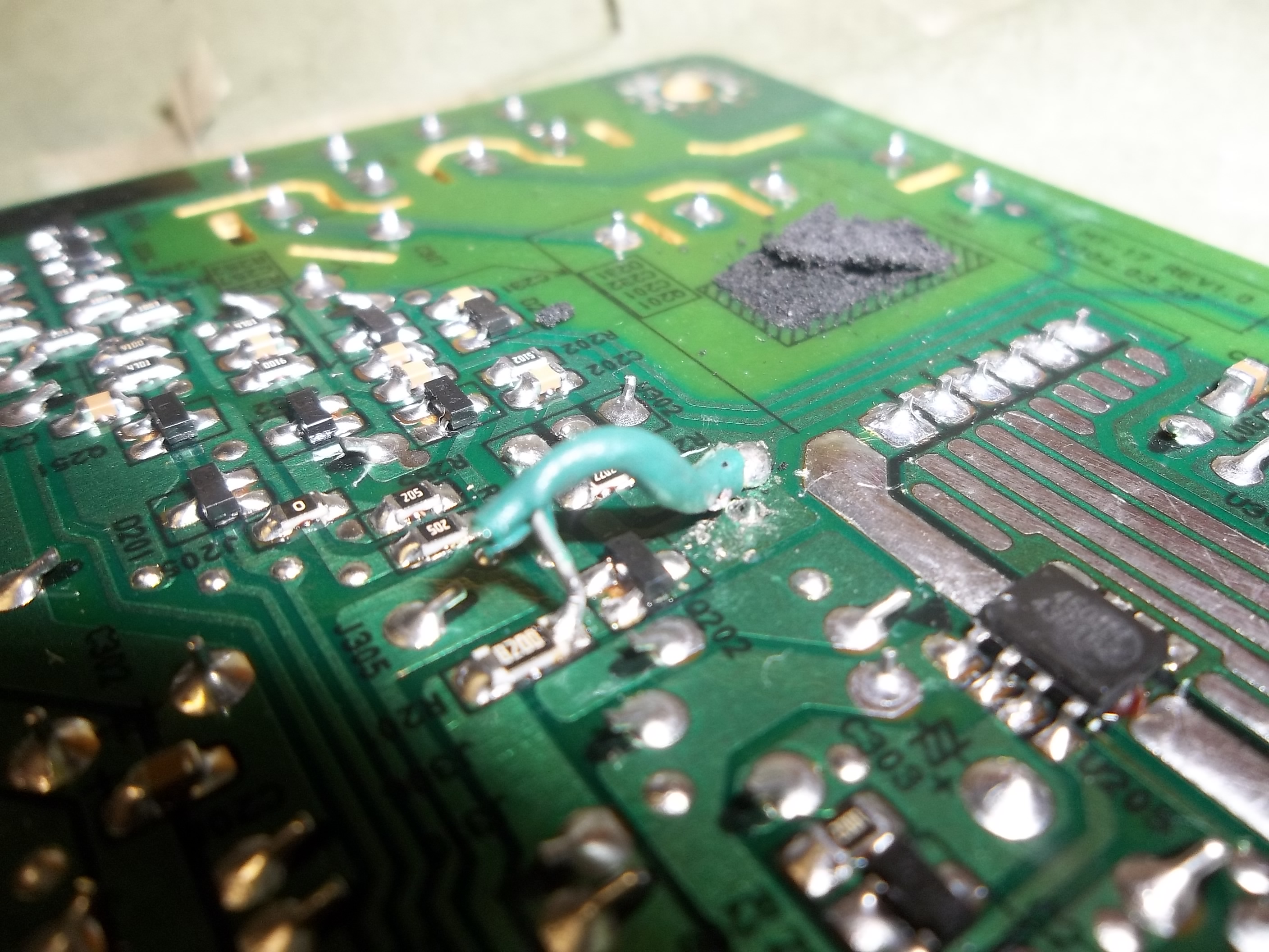

                                    #57
                                    Re: IBM L170 17" monitor "2 second on then black"
                                    budm-adm123-selldoor and company,
                                    attached are two pics of the jumper.
                                    I started from scratch and rechecked voltages.
                                    monitor connected to power. interface cable connected to pc that is powered off. power on the monitor is off. lamps connected to PS.
                                    PS supply voltages at the connector with the one blue wire.
                                    +14.25
                                    +5.14
                                    both are solid, no fluctuation.
                                    at the jumper on the low side (as viewing the picture) of the 8200 ohm resistor, same voltage 14.25. on the upperside of the resistor I get 8.36v, same as where the jumper is attached above the resistor.
                                    at the bit3105, there is 8.36v at pins 13 and 18, and it's solid.
                                    With the monitor powered on and the PC powered on:
                                    16.87V and 5.13V between gnd and the pins on the connector with one blue wire. from gnd to the low side of the resistor 8200, I have 16.87V. the opposite end of the resistor and the end of the jumper there is 8.36V.
                                    from gnd to pins 13 and 18 on the bit3105 there is 8.36V. all voltages are solid no fluctuation.
                                    I don't have a 47 ohm 5 watt resisior on hand to check the 13.V with an external load. If you think this is really the next step, I'll go and find one and make the test.
                                    much thanks and patience....... what a crew.
                                      #58
                                      Post 47 "I checked the voltage as indicated in red markings. yes, there was the 13V at the point you referenced. without the jumper in place there was 0 voltage at the indicated mark to turn on transistors. When I put the jumper in The 13V dropped to about 2.7 to 3.5 and kept fluctuating between those voltages."
                                      Now I am confused, where did you check and see that big voltage drop. in the your last post57, it does not look like you have that big voltage drop.

                                        #59
                                        budm,
                                        reread post #47. I don't know how to answer that starnge occurance. in my last post I doubled checked all voltages as indicated. I did it twice and came up with the same solid reading voltages which were not fluctuating.
                                        is the 8.36V a valid reading at pins 13 and 18?
                                        don't forget the jumper is still in.
                                        could the variying voltage levels I had before be because there was NO pc connection to the monitor? with the pc connected I don't see the flashing LOGO anymore, just a dark screen.
                                        much thanks everyone..... hope we're close.
                                          #60
                                          When that jumper is installed, we are basically bypass the switch (transistor) forcing the inverter to be on (backligts on) all the time when you plug in the power to the monitor.
                                          Since the 13V fed through a voltage dropping resistor, I do not expect the VCC for the I to be at 13V due to dropping resistor.
                                          Do you see any lights on the backside of the panel at all? I think at this point you will need test lamp to verify the Inverter circuit function.
