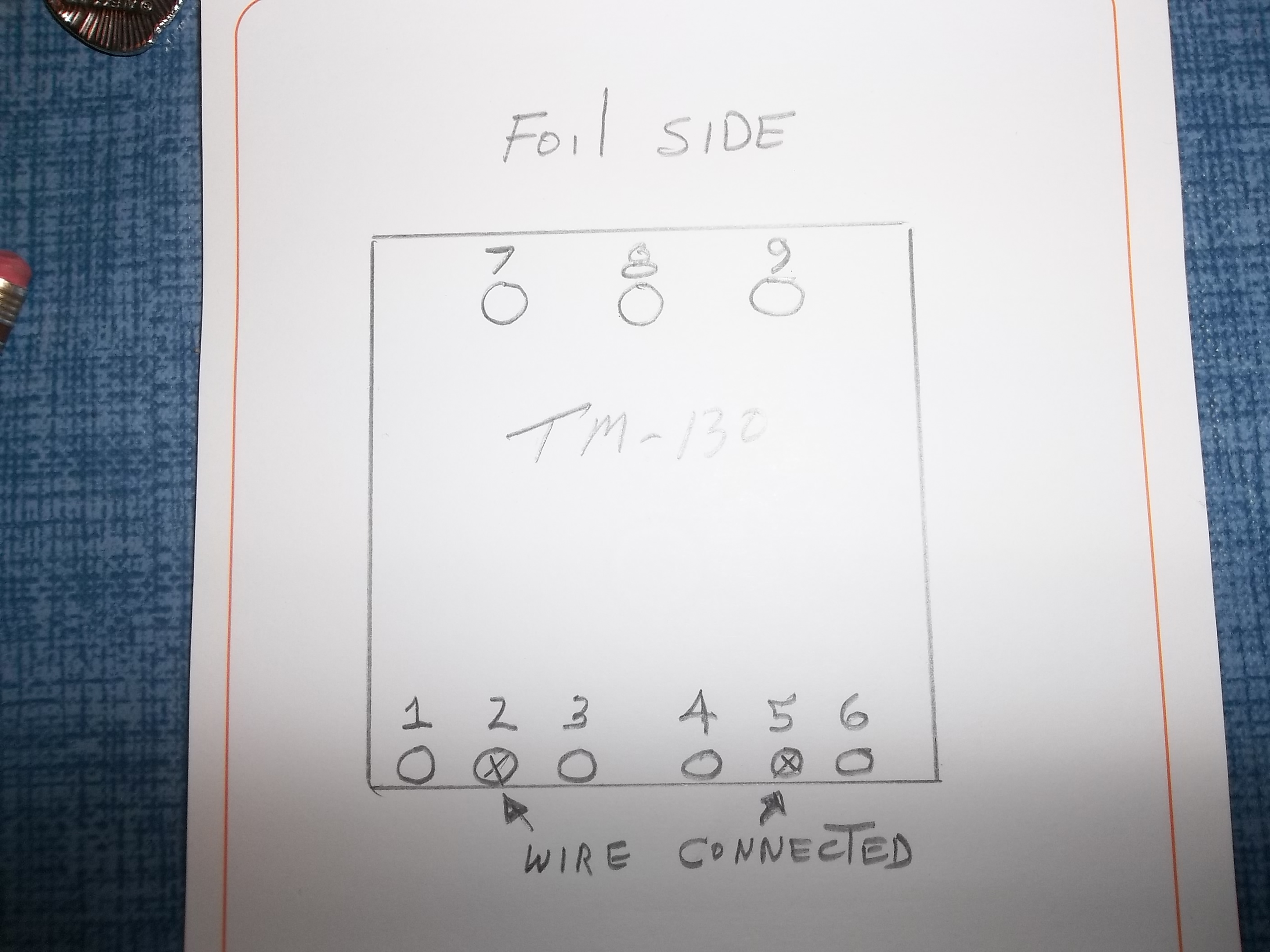

            Re: IBM L170 17" monitor "2 second on then black"
            ok selldoor,
            attached is a diagram of the transformer as it appears on the foil side of the board. This is the way I numbered pins.
            Transformer # 1 closest to input power connector.
            1-2=0, 1-3=nc, 1-4=nc, 1-5=0, 1-6=0, 1-7,8,9=nc
            2-1=0, 2-3=nc, 2-4=nc, 2-5=0, 2-6=0, 2-7,8,9 nc
            3-1=nc, 3-2=nc, 3-4=0, 3-5,6,7,8,9=nc
            4-1=nc, 4-2=nc, 4-3=0, 4-5,6,7,8,9= nc
            5-1=0, 5-2=0, 5-3=nc, 5-4=nc, 5-6=0, 5-7,8,9=nc
            6-1=0, 6-2=0, 6-3=nc, 6-4=nc, 6-5=0, 6-7,8,9=nc
            7-1,2,3,4,5,6,7,8=nc, 7-9= 1.043 ohms,
            8-1,2,3,4,5,6,7,9=nc
            9-1,2,3,4,5,6=nc, 9-7=1.043 ohms, 9-8=nc

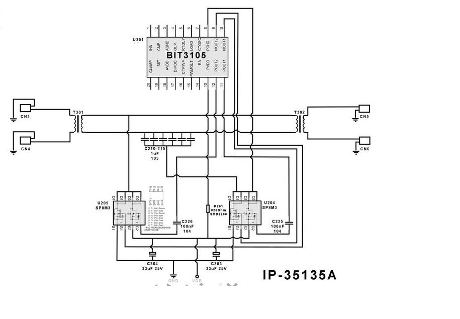

                              #34
                              I thought the inverter transformers were good the circuitry may not be.
                              I attach a picture which actually shows the BIT3105 wiring in this PS Board so that might help.
                              Have you access to any ccfls (Old screen broken laptop) or a working screen you could try these ccfls in?

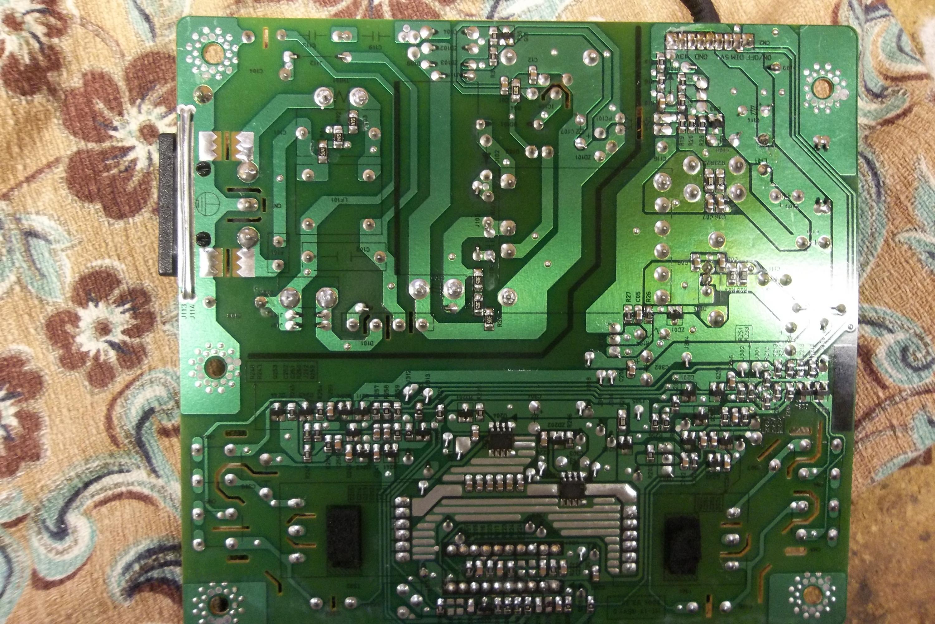

                                #35
                                So far we do not get to see the good clear pictures of both sides of the board to be able to trace out the connection to the VCC pin of the PWM IC yet. So far the picturs of the board had palstic shiled covering the the board, plus the glare from the flash.
                                • ilikesteel
                                  • Jul 2012
                                  • 284
                                  • usa
                                  #36
                                  ok, thanks guys,
                                  here are a couple of photos of the foil side.
                                  are ccfl's expensive? is it worth buying 4??? I have no access to any damaged monitors with good ccfl's.
                                  I appreciate all you efforts.
                                    #37
                                    OK, that is a big help, now I can try tracing the VCC lines to the PWM IC.
                                    • selldoor

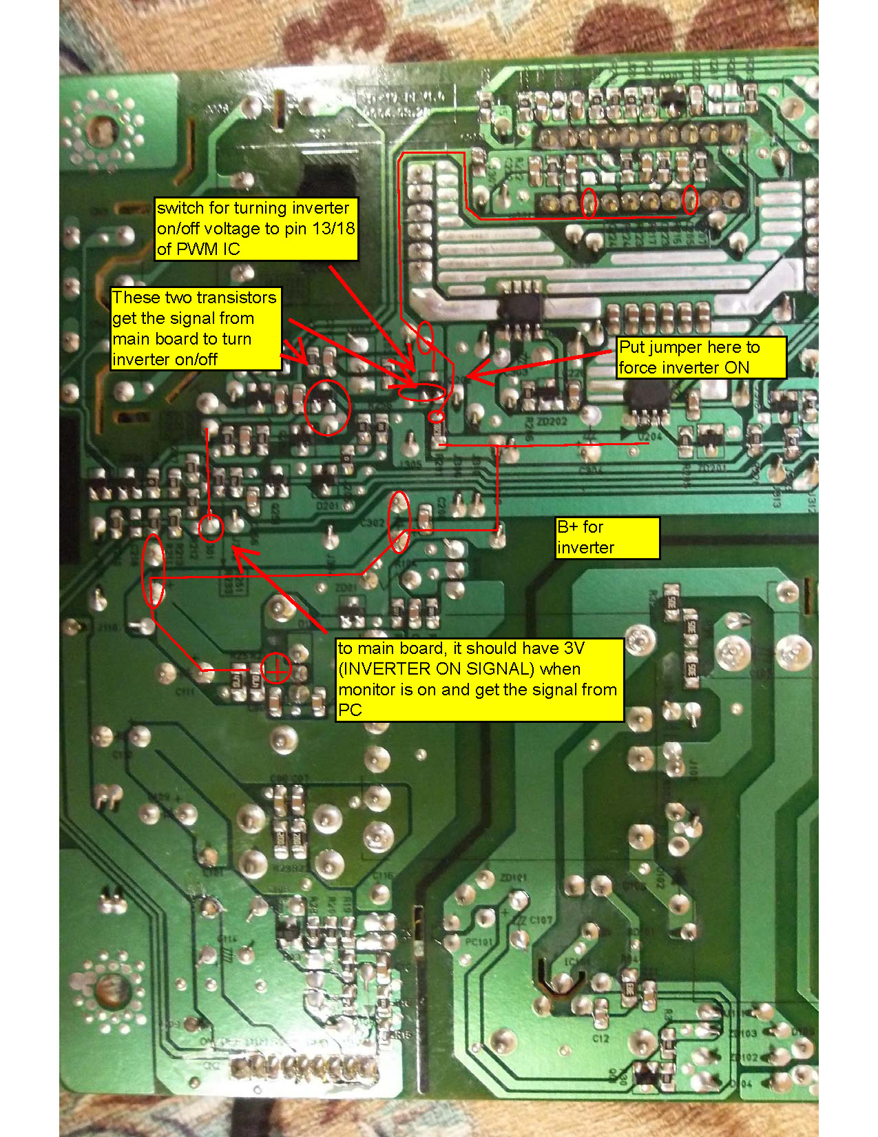

                                        #39
                                        OK, see the redline: You need to see if the Inverter ON is still present when the lamps turn off.
