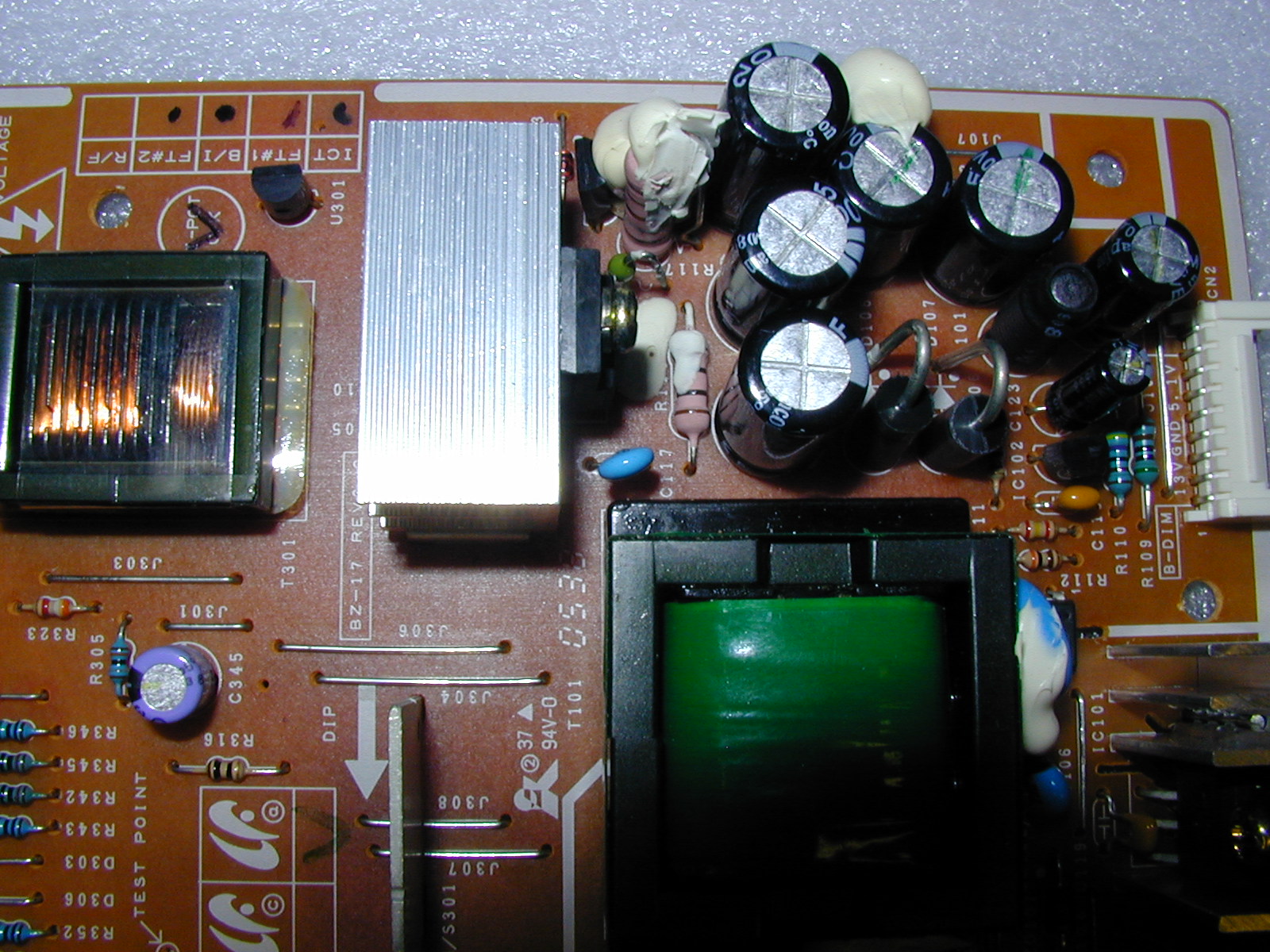

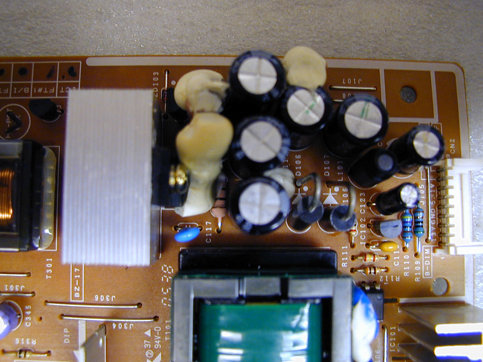

                      Originally posted by jetadm123
                      I believe those two pins are fed off the 13V rail and now we need to find out why the 13V is not reaching the inverter section. The power supply is made by Samsung and used in several models. Some versions of this power supply did use a fuse between the 13V output and the inverter section. And in most cases they hid the fuse using white silicon adhesive. In your second photo, lower right side, above the wiring harness with the blue wire, there are two caps and a inductor with white adhesive between them. Carefully, remove some of that adhesive to see if there's a fuse there. It should be green in color.
                      I had replaced the caps in this model and tested just about every component I could see. I had to put this one aside for awhile and came back to give it another try. I saw what jetadm123 had posted and decided to go back and take a 2nd look. I normally just trim the adhesive away from the capacitors and replace them. I started to trim away the adhesive. And sure enough, there is was! That little green hidden picofuse! And sure enough the fuse tested open. I replaced the fuse and the monitor fired right up. Thanks jetadmin123!
                      • retiredcaps
                        • Apr 2010
                        • 9271
                        #91
                        Re: IBM L170 17" monitor "2 second on then black"
                        There is where silkscreening both sides of the board would help. You would have found the fuse from the pcb designation on the backside.
