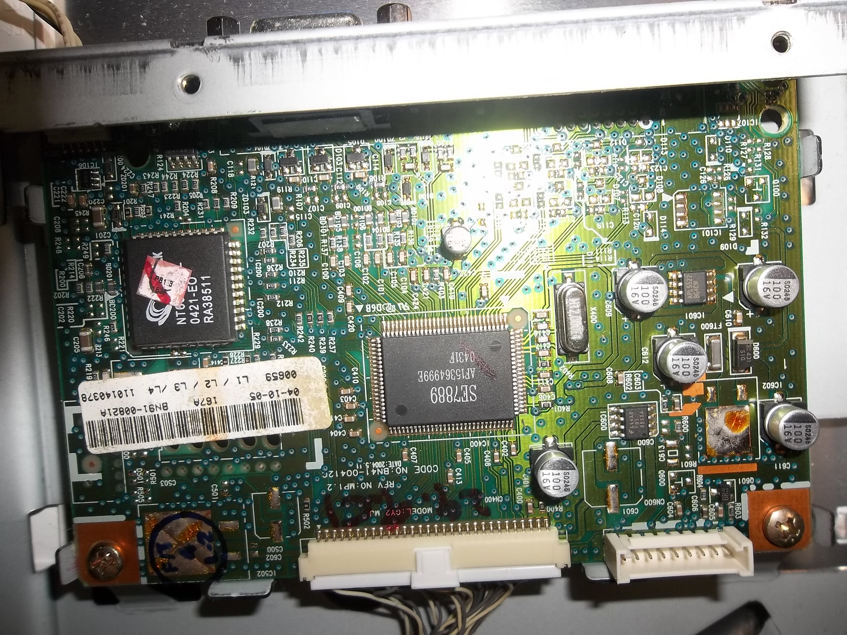

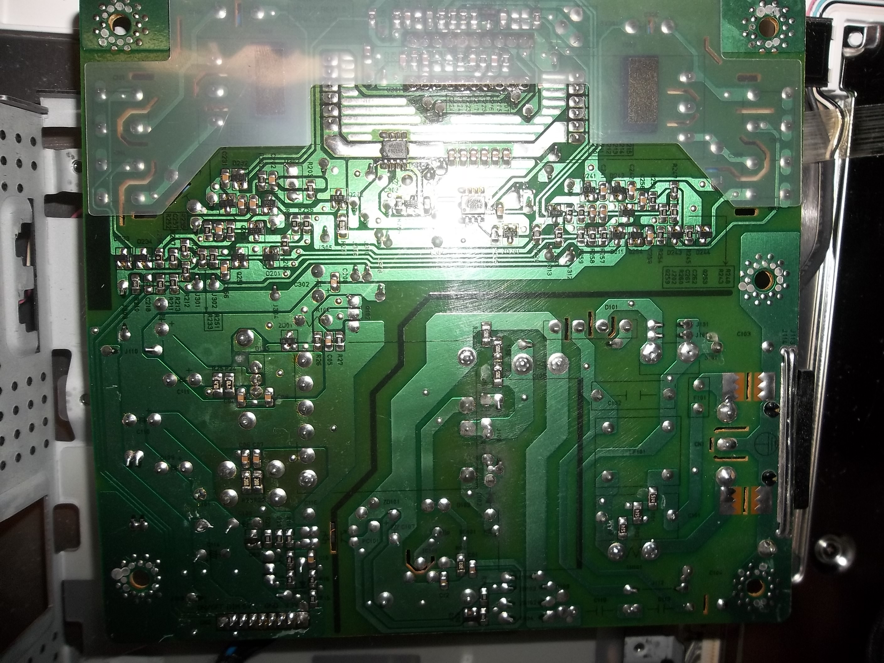

        Re: IBM L170 17" monitor "2 second on then black"
        ok, took some pics, hope they're viewable. I also download the so called service manual for the schematics. the schematic of the power board doesn't show input power and the bridge and filter circuits. If they're on that schematic, I couldn't find it.
        hope pics help. thanks.
          In your 3rd photo there are two 8-pin surface mount devices marked 4501M. I believe these are AP4501M dual mosfet devices containing both N and P-channel mosfets. With your meter set to resistance, check for shorts across:
          G1-S1
          G1-D1
          D1-S1
          G2-S2
          G2-D2
          D2-S2
          Perform the above test for both AP4501M.

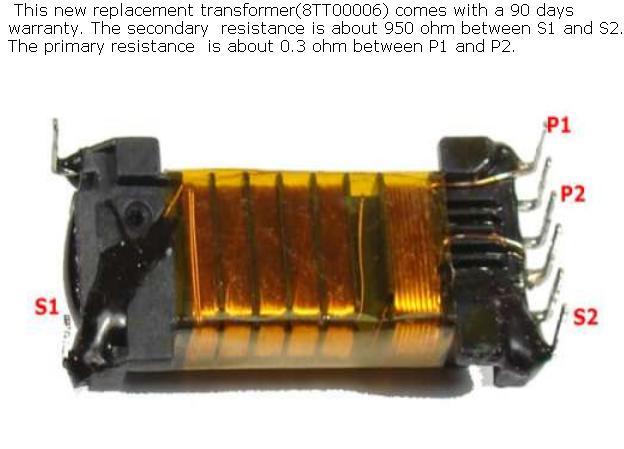

                                Yes you can test on board - I have been looking for a TM-130 but have struggled so far, so if one is faulty it could be a problem to replace.
                                I have been trying to find a pinout for the secondaries may just be the
                                outer two joints at the end where there are three (under the plastic)
                                or it may be as in the attached pic.
                                If not you will just have to work around all the pins in sequence.
                                Meter on 2000 ohms.

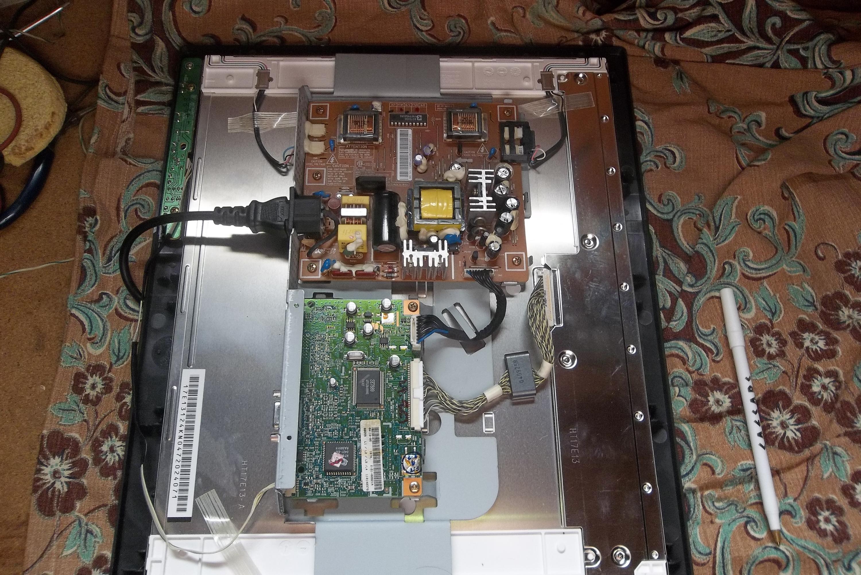

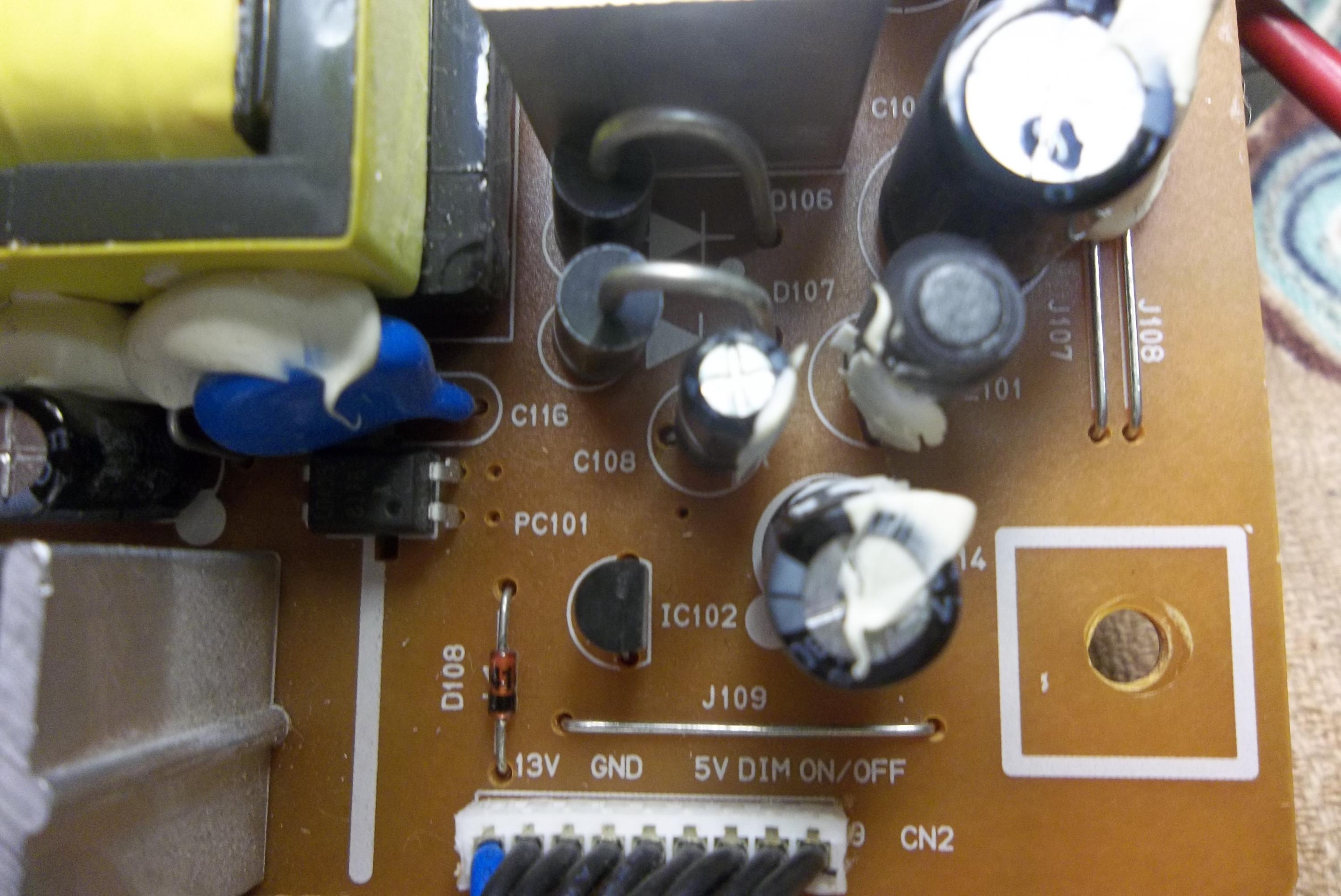

                                  selldoor-adm1213-budm,
                                  ok, I checked a few things and here's what I found. attached are more photos, one is a view of the transformer pin view and the other of the power supply board indicating NO fuse where the two caps and inductor are located. on the pin view of the ransformer looks like there is a wire attached to first inside pin from each end of the 6 pins. opposite end of transformer shows 3 pins. both transformers are identical.
                                  I rechecked my voltages again. with the monitor connected to the ac power, at the 9 pin connector ( all black wires except for one blue) that has the cable going to the scaler board, I read 5.14V for the 5V and for the 13V it reads 15.47V.
                                  turning power on, the monitor still flashes the IBM LOGO at normal brightness for 1 second and then goes blank for about 2-3 seconds. this keeps cycling until I turn power off.
                                  While the cycling was going on I checked the 5V and 13V at the same connector and found this: the 5V reading was 5.14V and would drop to 1.3V as the cycling continued. 5.14V~1.30V.
                                  the 13V reading was 16.8V and would drop to 10.8V as the cycling continued. 16.8~10.8
                                  also noticed that all the electrolytic caps were CapXon and looked original to the board.
                                  BIT3105 still did not have any voltage on pin 13 or pin 18.
