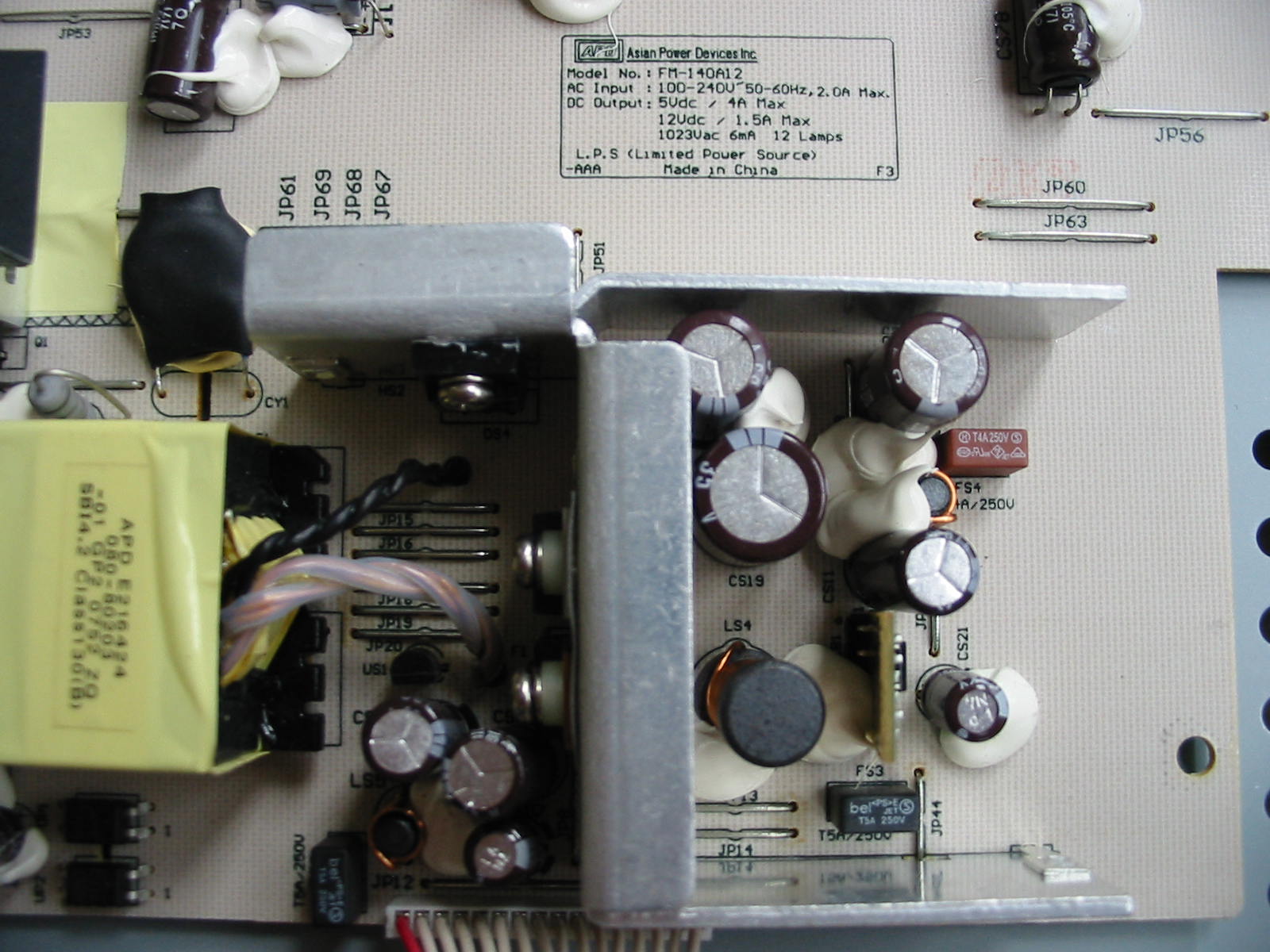

    Main pcb; APD logo = Asian Power devices inc. model FM-140A12

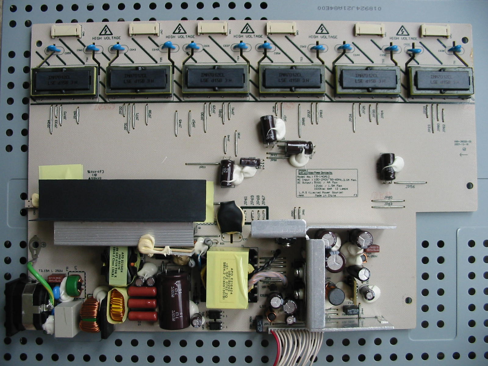

          • rogerk
            • Jul 2012
            • 17
            Re: Westinghouse L2610NW 26" 16:10 LCD backlite problems

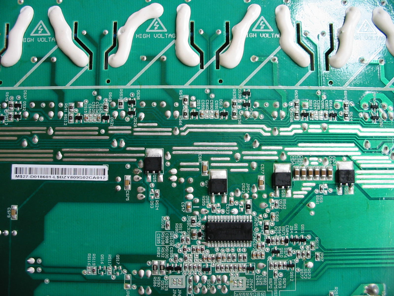

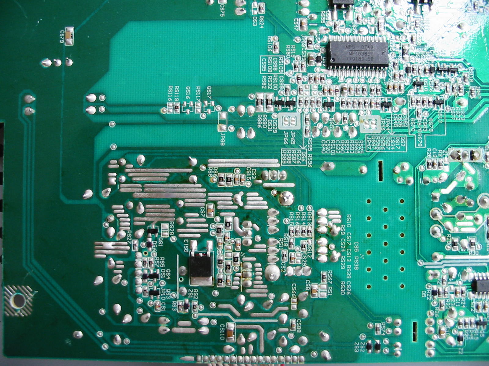

            PCB pics added.
            • selldoor
              Slow Learner
              • Dec 2010
              • 7870
              Pictures are poor too much flash. You need to work out what are the secondary windings on the 6 inverter transformers. I cannot find your transformer -They could be as in this
              http://www.lcdparts.net/TransformerD...ProductID=4175
              or as in this
              http://www.lcdparts.net/TransformerD...ProductID=2796
              Power off meter on 2000 ohms you need to measure S1>S2 S3 >S4 for each
              transformer. and post the results

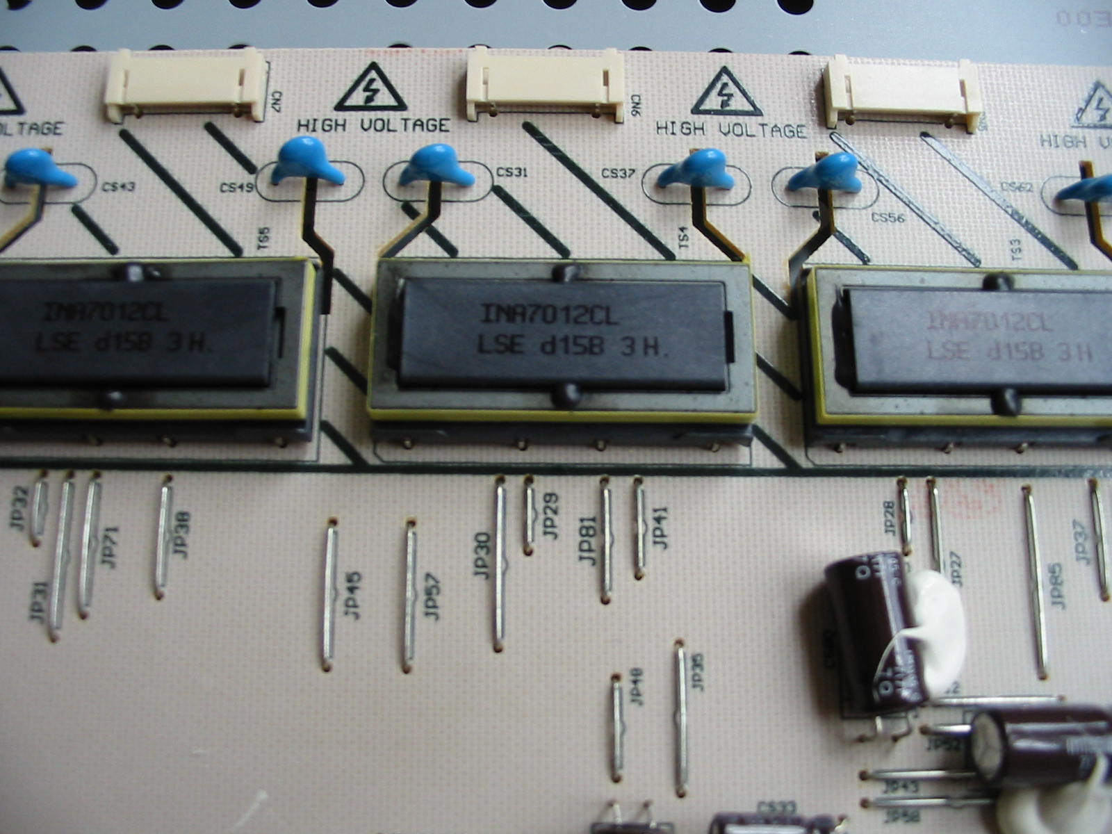

                This form factor transformer may have pin out like this:
                http://s807.photobucket.com/albums/y...t=DSC00191.jpg
                • rogerk
                  • Jul 2012
                  • 17
                  selldoor your links are inop.
                  Any of my TMS92859CT's ?
                  Going by budm's pic
                  pin1 1350 ohm
                  pin2 .8
                  pin3 .8
                  pin4 1340
                  Xfomers OK ?

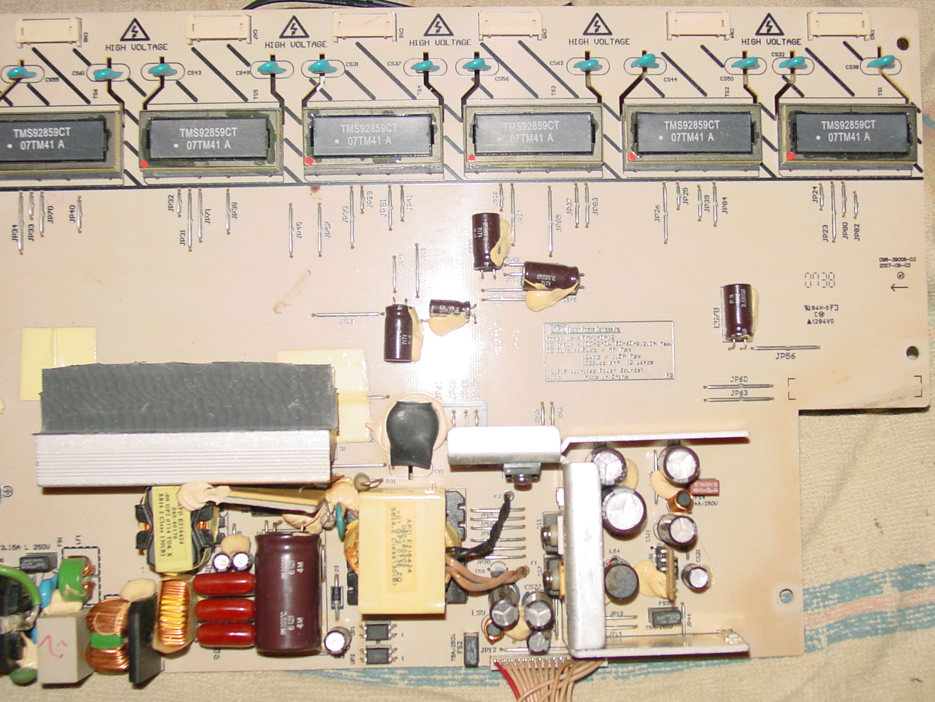

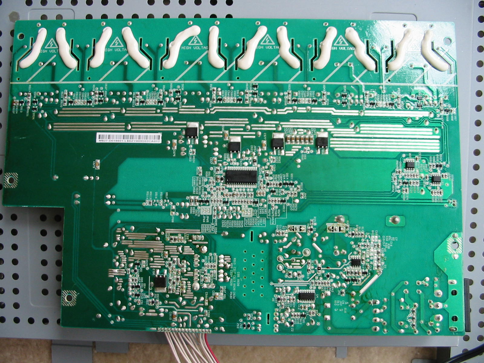

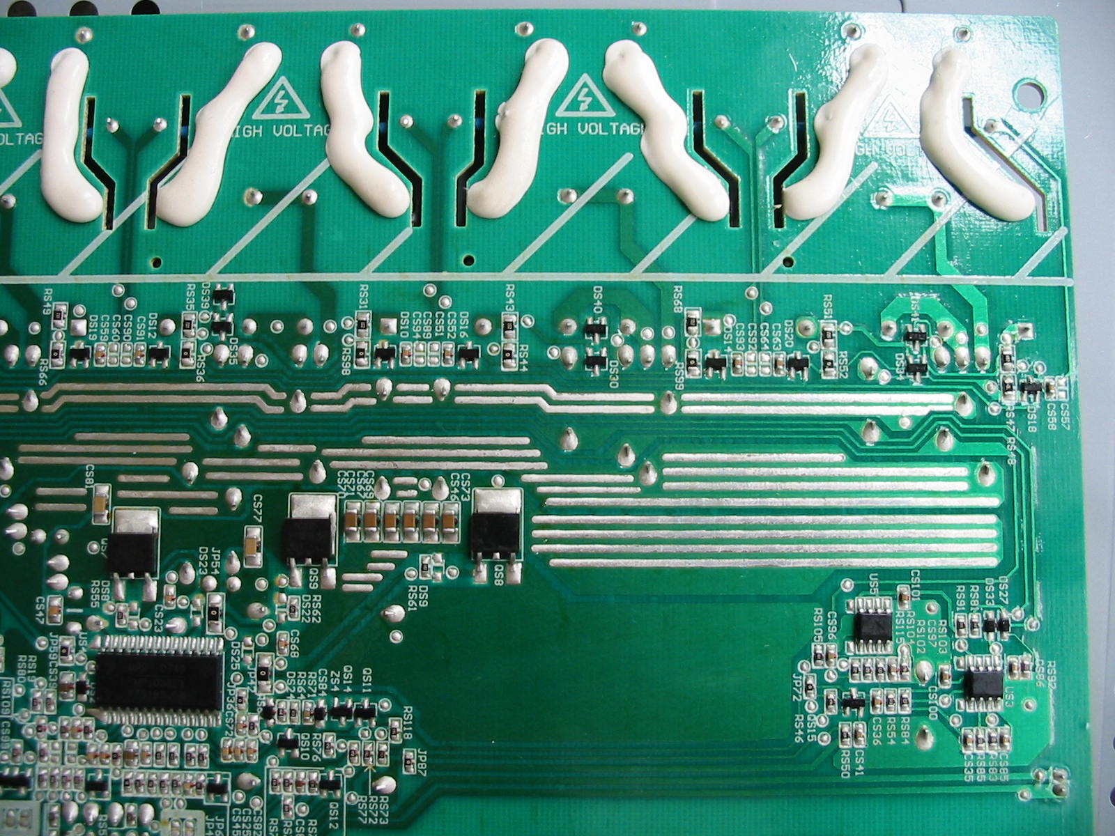

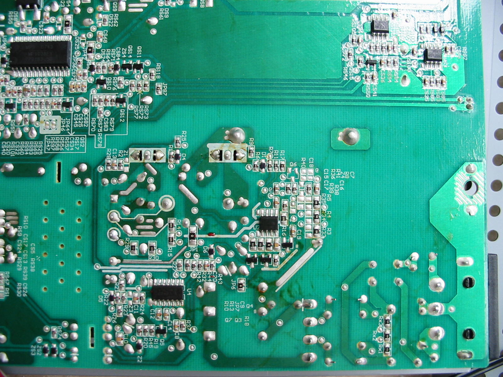

                      And it does.

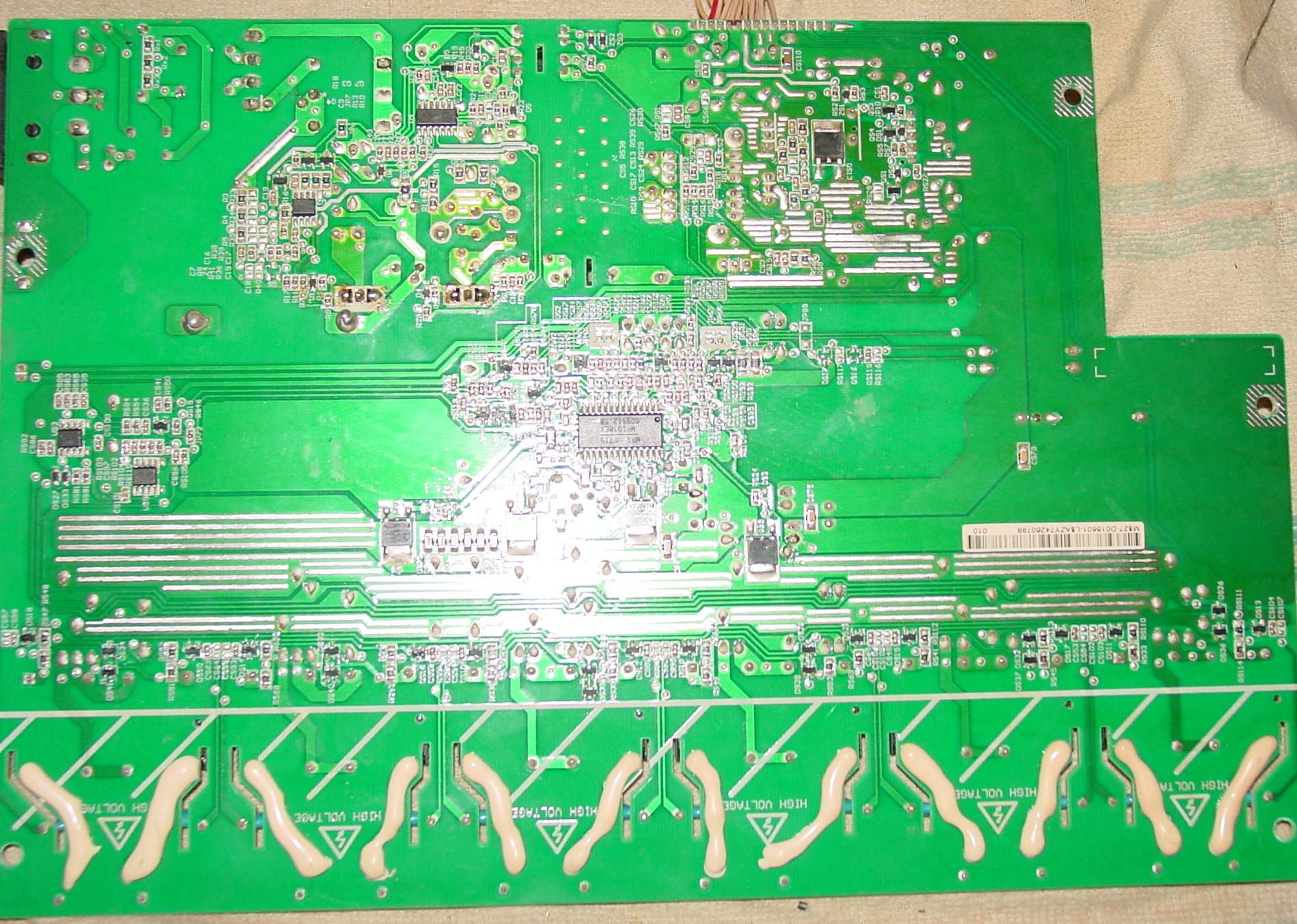

                      I uploaded some pictures of when I took mine apart. Just used that monitor last week for an hour or so and it still works, though it was quite loud (lots of buzzing from the inverter).
                      As I mentioned before, I suspect that the design of this inverter is not the best when the CCFLs and inverter transformers become unevenly worn. I think the only 2 possible solutions are to either replace the CCFLs/inverter transformers or tweak/fiddle with the feedback circuit (and maybe disable some of the CCFLs after doing this).
                        Thanks for the Pics. Way better than what I took.
                              You did it correctly, I never seen that high (>5K) resistance for 26" TV.
                              But since all your transformers reading are within 3% from each other, then we need to look somewhere else for the problem, I just hope it is not the lamp problem, but you will need to verify them.

                                Can you do a close up of the caps on the inverter board.
                                With it all connected up can you unplug all but the first lamp lead switch on and see if it flashes. its difficult but try and remember how bright and if it has any colour. Switch off
                                Unplug that lead and plug in lead 2 Switch on and see if it flashes etc. Switch off.
                                Repeat for all six and report result. High voltage 1200v so remember to switch off.
                                  They are all Chemicon KY on my board. His seem the same too. Overall, this PSU board is built quite well IMO.
