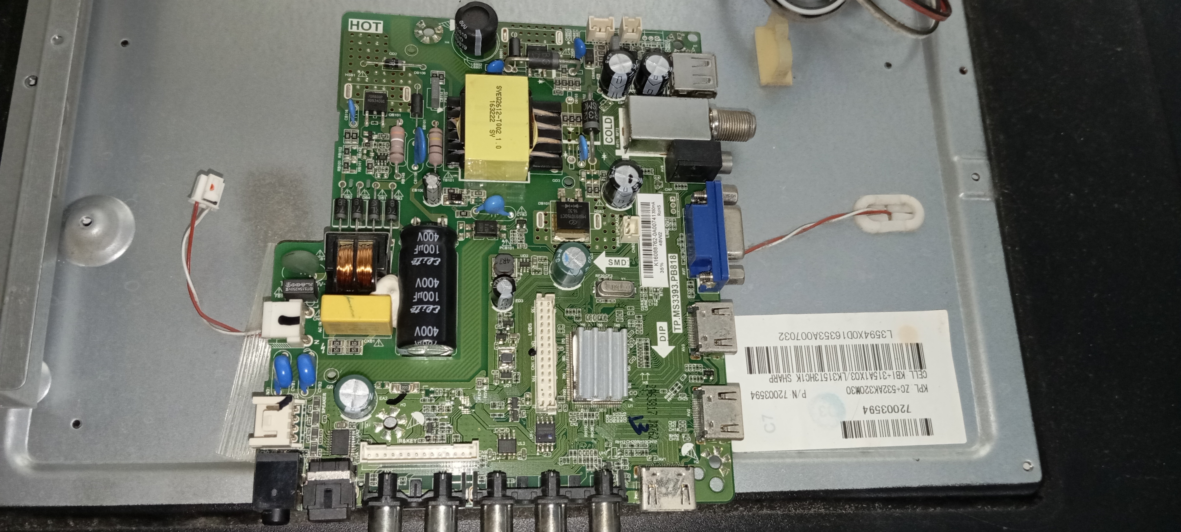

    Hello, guys!
    I have this Westinghouse 32" LCD TV that turns on, standby led lights up (blue) but no image. If I knock on the screen there's no backlight present. I took the back cover off and injected voltage on the led connector using a Led TV Backlight Tester, and no light at all, so... it must be that there's some bad Leds, right? Or there is some another testing that should I have to do? Any guiding I'll appreciate it very much. Thanks in advance!
    Alex.

    Seems so, try the flashlight test if you have not. if you see an image that that's probably further proof of bad leds.

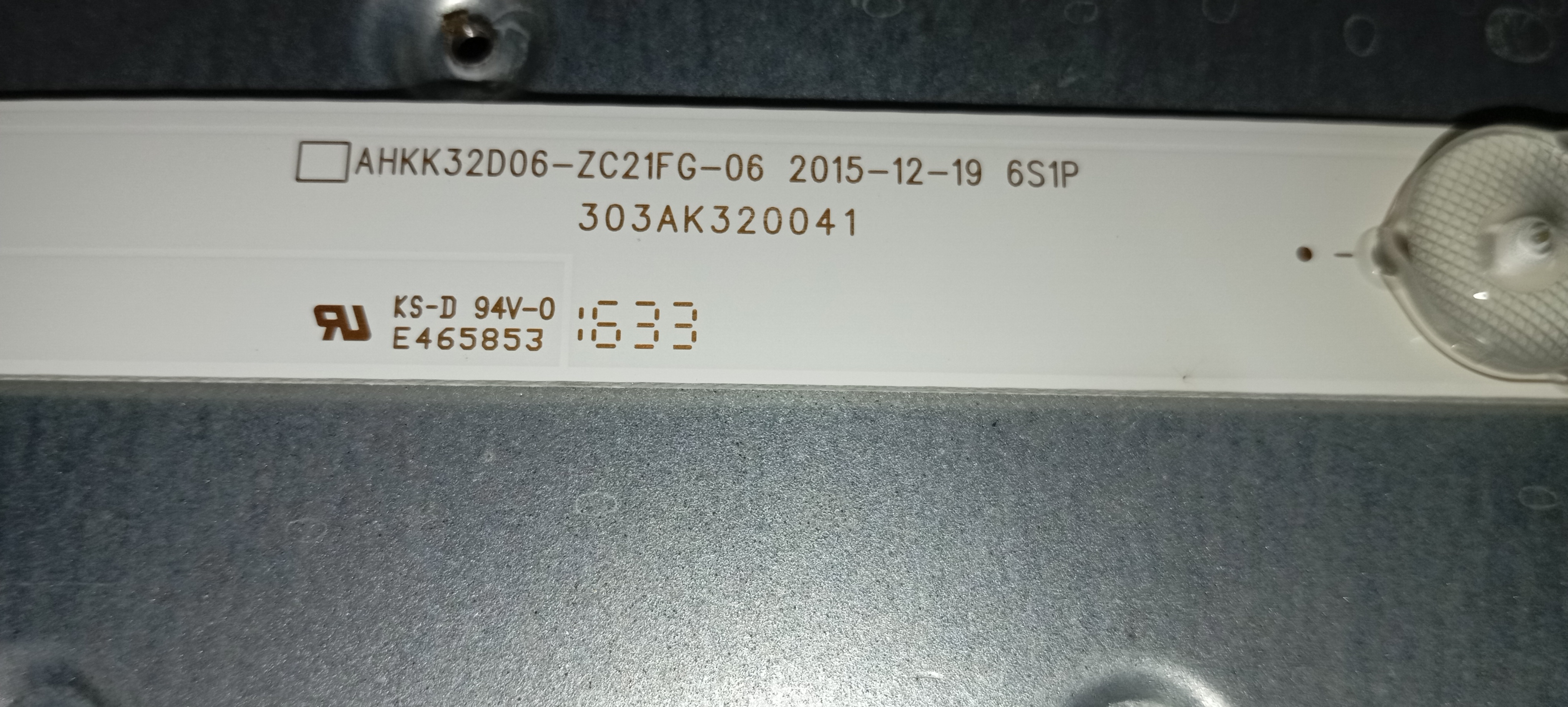

        Try ebay, just be sure to go with one with good feedback. They shouldn't cost much. You want to go by the numbers on the strips to insure a match. I'd tear it down, confirm strip numbers, store in safe low traffic area til strips arrive. If ever in doubt there's some very helpful people here to help you through it.

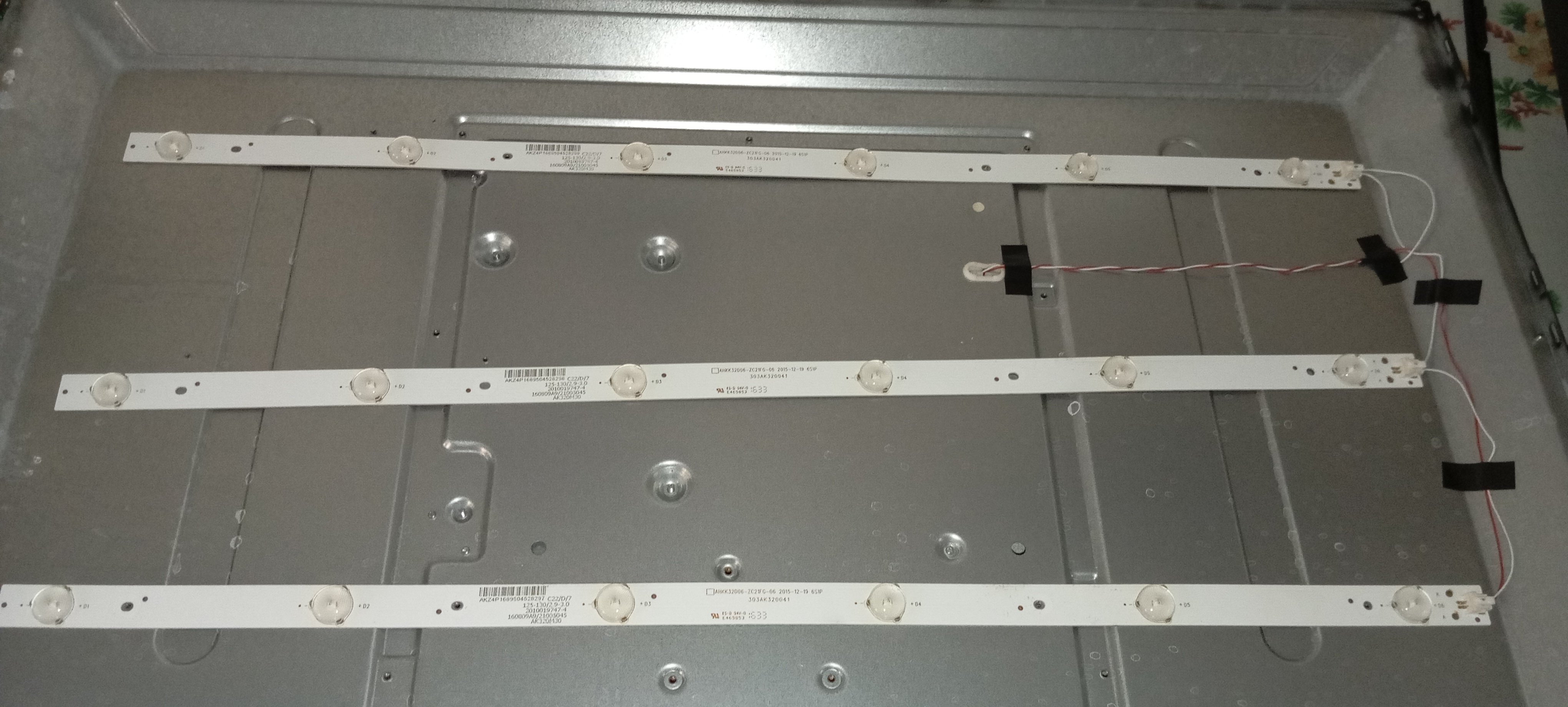

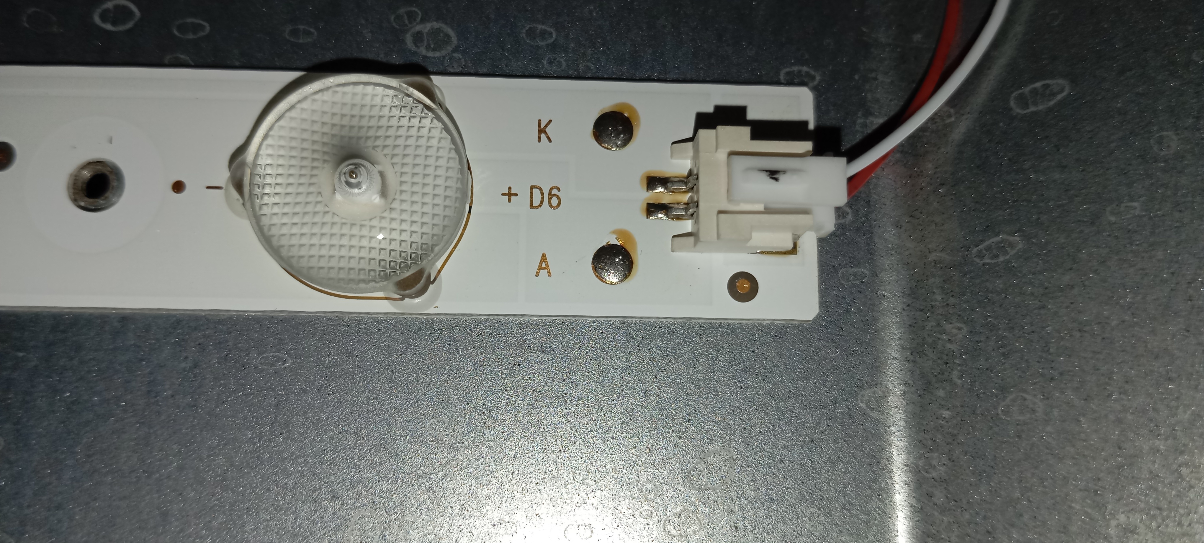

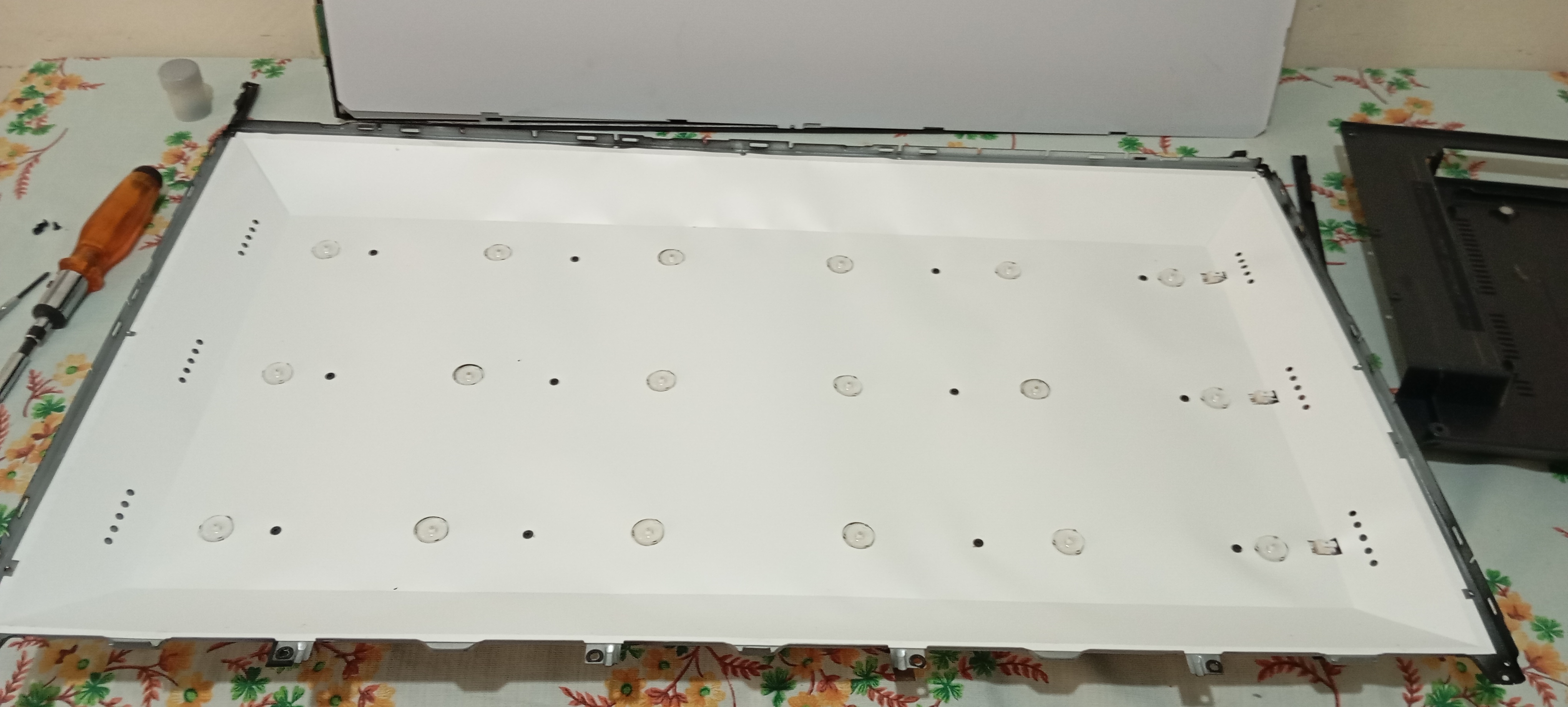

              A few things I found after tearing apart the layers of the back cover to get to the LED stripes:
              1. The TV has 3 LED stripes with 6 LEDs each
              2. The LED stripes (3) are in series
              3. I tested out each one of the LED stripes, and one of them is working good entirely, another one is half good and the last one is totally bad.
              I'll attach some pictures I took so I can start searching for buying them.

                  EDIT: Before doing the purchase, I tested the voltages on the LED connector of the mainboard:
                  1. In standby mode is 28v approximately.
                  2. After pressing the power button, the volage starts to increase up to 58v approx. and then drops down to the same standby voltage; I suppose is due to not having the LED stripes connected, right?
                  After having this behavior, can I be confident that putting a new set of LED stripes the problem will be fixed?
                  Thanks in advance!

                    Everything is correct, this is how it should be. If you install a new, working backlight kit, everything will work.
