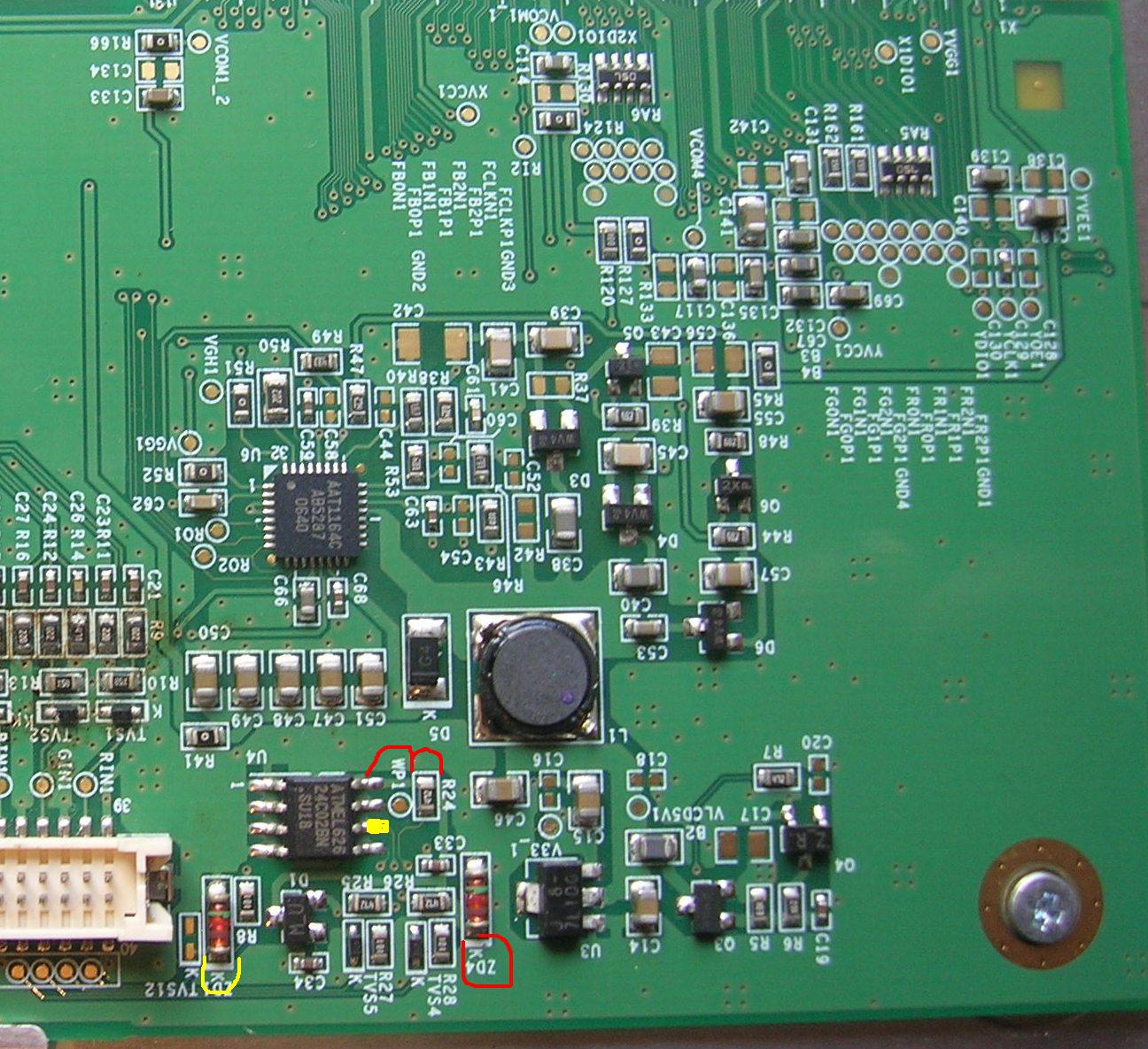

        That voltage for U3 input is generated by that U6 AAT1164 chip above that inductor, you can down load the spec of that chip and start checking the voltages on those pin.

          Hi
          no power to U6 at all .
          On picture i have attached
          ZD1 is pulsing 0-3.1v
          ZD4 is pulsing 4.56-4.62v
          R24 is pulsing 4.56-4.62v

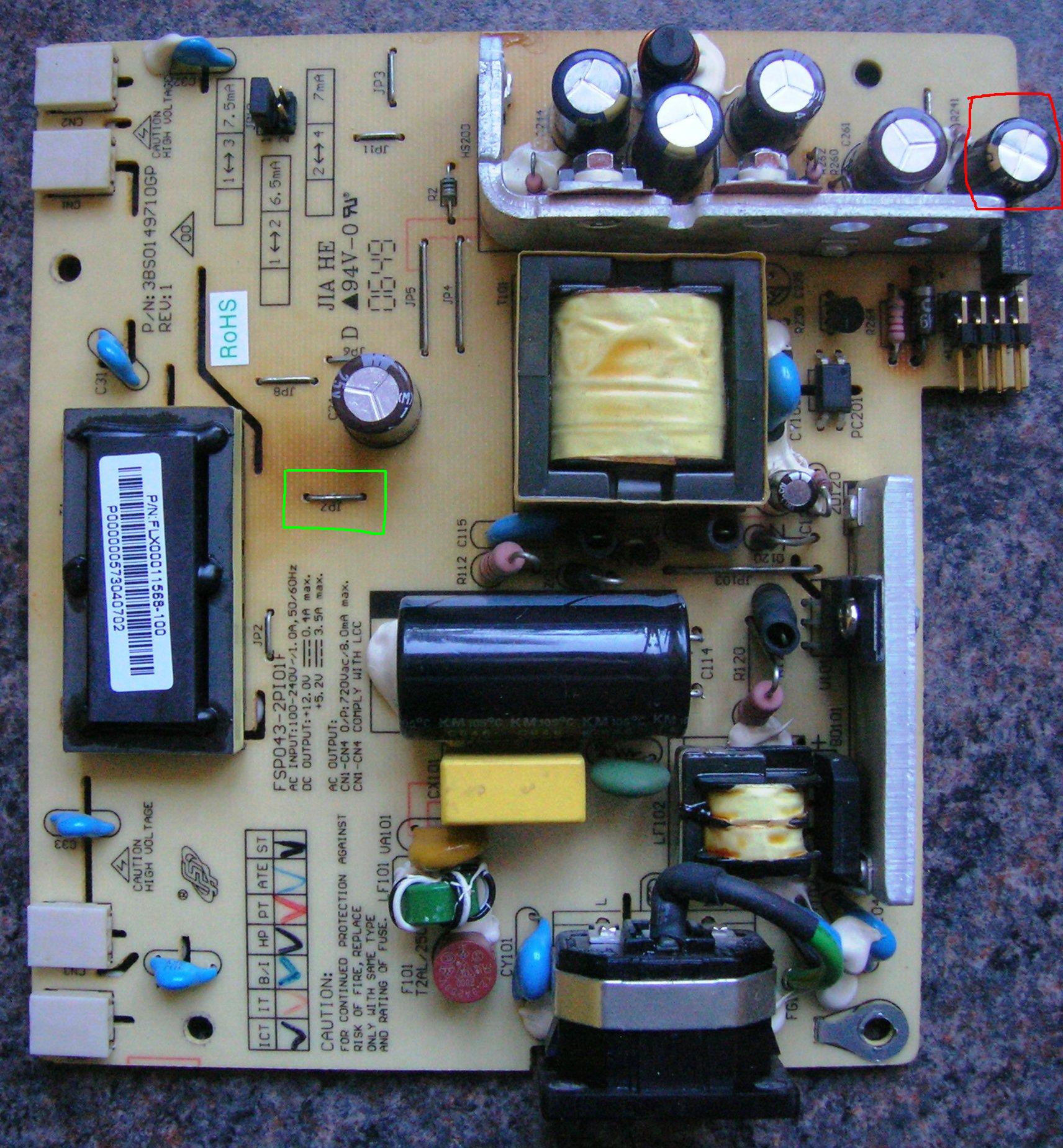

          Also rechecked the psu with no load 5v output is steady at 5.21v
          but in picture of psu the jumper ringed in green shows 11.8v no load but when connected to the screen it fluctuates betwwen 12.01 and 12.33v .
          Cannot borrow the supply i originally used to test as it appears it is not working so maybe my supply still has a fault so am going to change the
          dm0565r green mode power transistor (one of the few bits not been replaced yet ) and then go from there

            Have you checked D5 and also R41 despite a number of people telling me no
            I am sure I once read that 0 rated resistors could be used as fuses.

                  If you find that R41 is still OK, try removing it, and see if the switching smps comes up to voltage.
                  Also, those mlcc's do go short sometimes, perhaps one of them (C47,48,49,50,51) is bad.

                    Pulled D5 off the board and measures ok .
                    R41 ok no difference when not in line to PSU .
                    C47-51 all measure the same so assume ok .
                    Changed dm0565r still the same issue .
                    The Tvs not sure what they are so just checked them on resistance and they all measure the same too .
                    Also reflowed the whole of the board just in case any bad joints .
                    I now have laid the whole thing out on my bench and connected it all together and have noticed that the inverter trans is buzzing in sync to the power going up and down ,whether that is because the power is fluctuating or thats whats causing it i am not sure.

                      Still seems odd there is nothing in that whole area. I'd test R166 as a fuse then with the power on see what voltage was on every test point in that part of the board.
                      Did you diode test the two zeners.

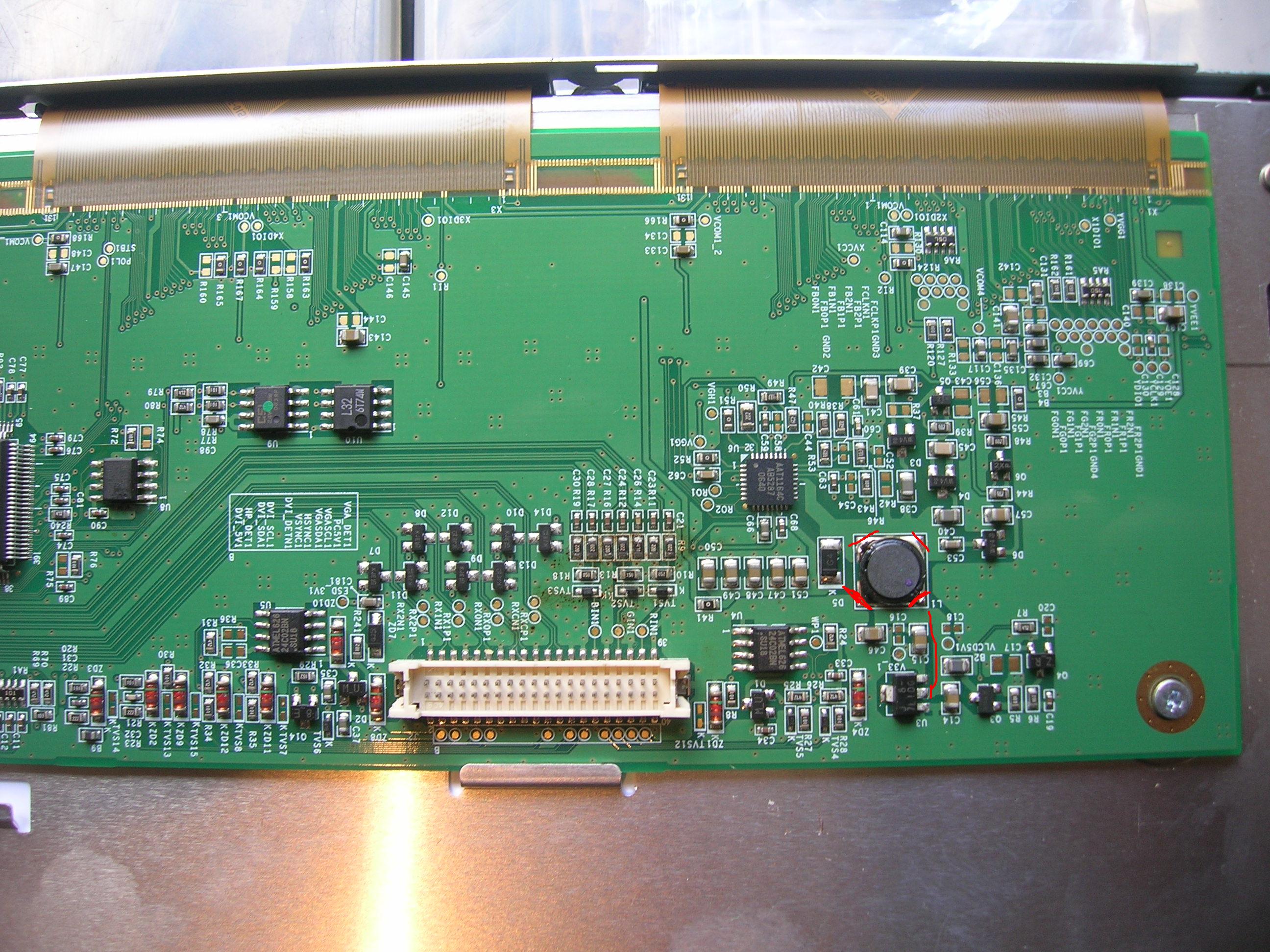

                        Thought i would check all the ic chips but cant find any spec sheets for
                        U8
                        PS25LV010
                        EO553
                        CN1FJW
                        or U10
                        L32
                        6T74W
                        Wondered if anyone had an idea or dealt with them before

                          PS25LV010
                          Likely serial flash.

                            U10 is a eeprom (BR24L32).

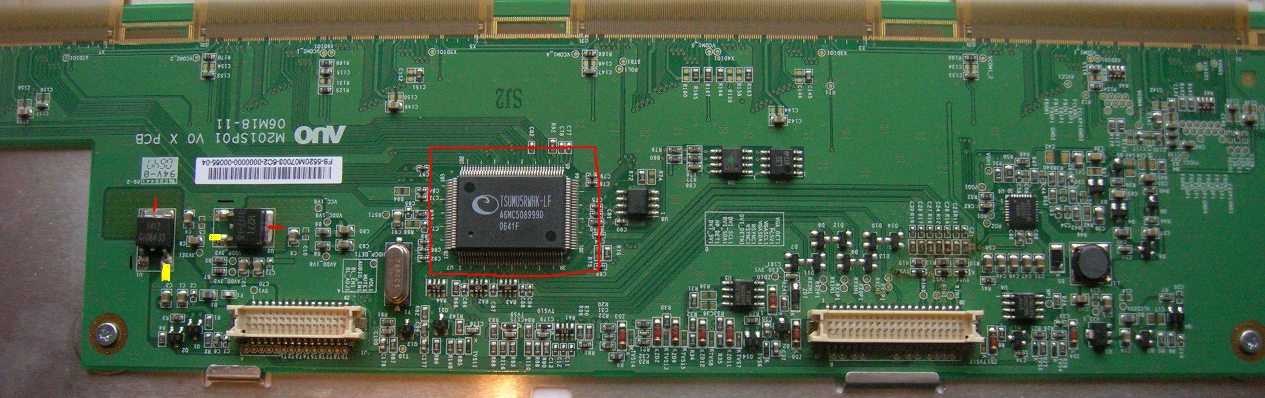

                              U10 and U10 are both getting voltage in at a steady 3.2v and i cannot find any shorts .
                              Managed to find a sheet for the main logic ic controller and think this may be the problem as 3.3v are going in but the outputs fluctuate from 0 - 3.2v and should be at 3.3 steady

                                I have removed the large chip U7
                                Now the screen and power are no longer pulsing .
                                Not to say this is the problem but until new chip turns up in a couple of weeks and fitted (again ordered from Hong Kong as cant get here ) will have to see what happens from there .
