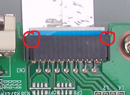

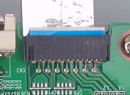

Hi..I am trying to open this cable connector..Its connecting the OSD board to the Main Board on my monitor...I would be grateful if any body could tell me how to unlock it so as I can remove the main board.. Thanks..

Ok..Many thanks ..I thought along those lines as the two ribbon cables feeding the OSD board ..the latches opened that way...I did try but obviously never applied enough pressure so will have another try...So have tried but it does not want to lift in fact it broke one of my fingernails so I am not sure it opens that way as with the pressure I applied it should lift open releasing the cable ...HkLast edited by hairykiore; 07-20-2012, 09:47 PM.

I think that is the slip fit connector.Never stop learning
Re: Ribbon Cable Disconnecting
You just pull it to slip it out of the socket, and slip it back in, just make sure to go in straight.

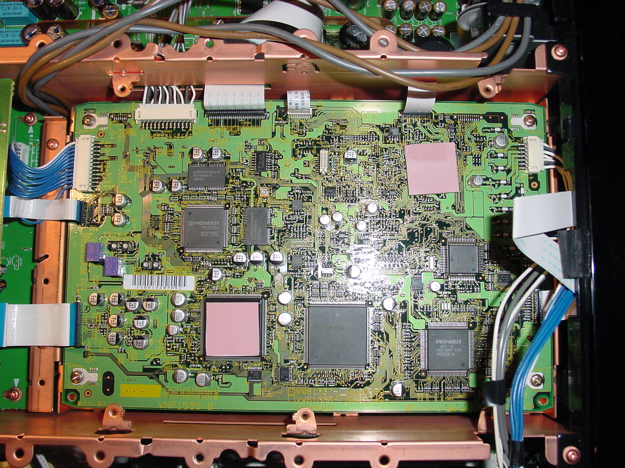

You can see a lot of them on this board.
http://s807.photobucket.com/albums/y...oneer%20DV-09/Last edited by budm; 07-21-2012, 12:22 AM.Never stop learning
