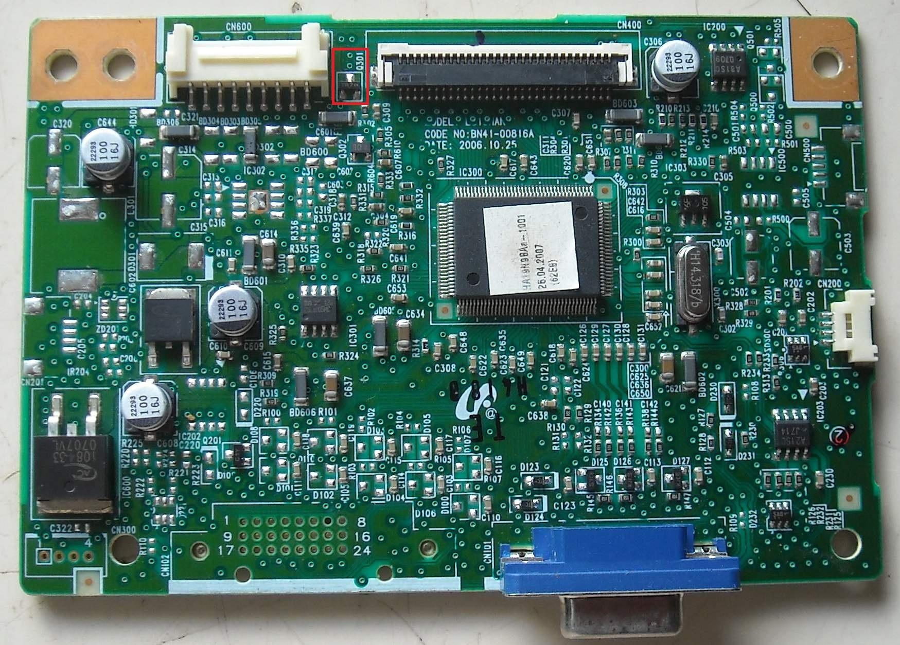

            Hello there, i have the same problem with my samsyng synchmaster too, but i noticed on logic board the piece marked in red square being fat, i mean isnt flat...
            So, what kind of SMD is that? And with what i can replace?
            Because when i power on, backlight work but the screen is white, like there is no cable connected from logic board to lcd screen.

              Re: Samsung Syncmaster 940BW White screen
              That is a good picture - can you re-post it using "manage attachments"
              found by scrolling down in "go advanced" under quick reply.
              I thought there should be a q400 on the board as mentioned earlier in the thread but there is not.
              Can you decipher the part number?
              White screen is often a blown fuse on the panel board - can you do a picture of that?
                The part number is not listed in electrical part list of the board.
                On the board the part is noted in a square with Q301, and on it is coded TR2 or TA2, like in the picture above, but the Q301 is not listed on electrical part list.
                The fuse on the panel board is good i`ve checked it with a multimeter.
                  Is there something after the TR2?
                    You can thank to obscure colleague from China, who had published the following Service Manual: According to this document Q301 is P−Channel MOSFET NTR2101P(8.0V, 3.7A, ).
                      Yes is a 3 but turned down, i think is the lot number
                      I will, because i guess that part is a NTR2101P-D mosfet.
                      Thanks very much.
                      I`ll keep in touch if the problem is solved..that device on my board is blown, like a half expanded popcorn :P
