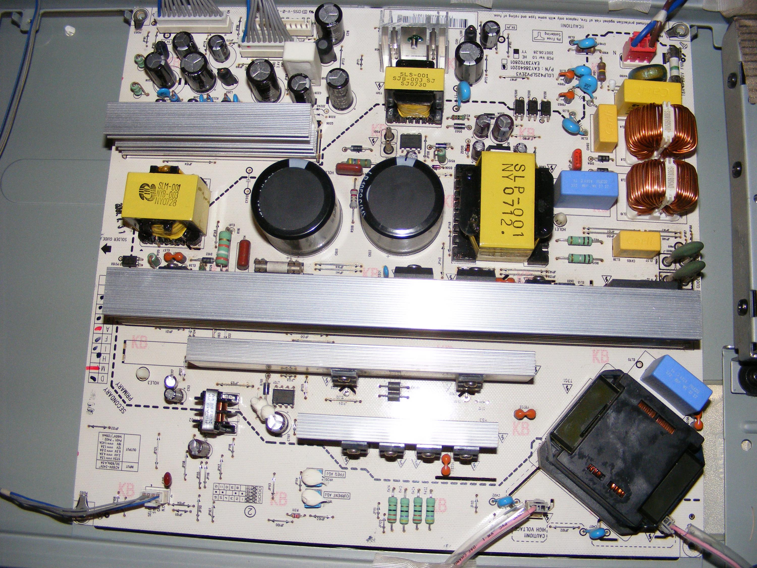

    Can I use this method with a CFL to test this inverter? It's from a 42 inch TV. There's one transformer driving all the bulbs. Would I just hook one CFL up between the two inverter outputs?
