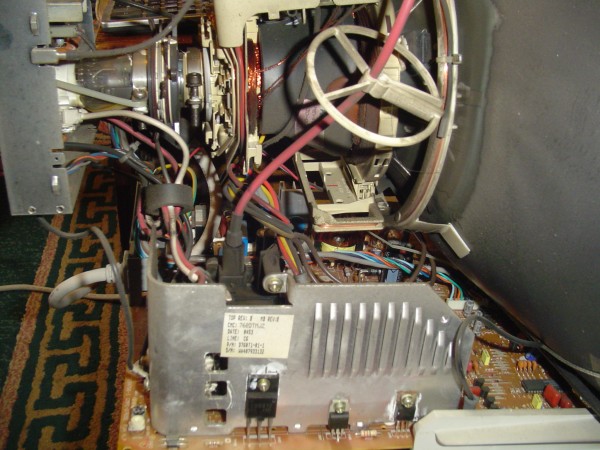

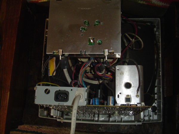

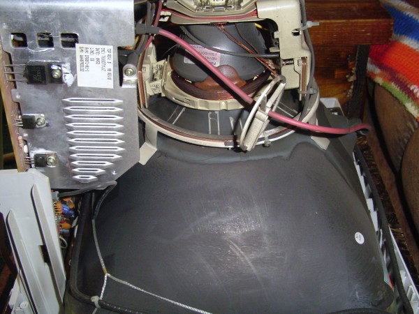

              I have some pictures to see if we can resolve this problem.
              Yesterday the screen was working better the screen did not shut off. This morning I got on and after 20 mins the screen was gone.
              selldoor It was a silicone glue and I was told to use it on spot that needed it. The top of capacitor and any area were I found arcing.
              Thanks for the help and good ideas
              • Th3_uN1Qu3
                Believe in
                • Jul 2010
                • 6031
                • Romania
                Re: Picture squeezed in then died
                The HOT is the big transistor in pics 3 and 5 ie crt4.jpg and crt1.jpg. The deflection is the coil mounted on the neck of the tube, follow the wires coming out of it and you'll find its connector.

                • NormanSaxon86
                  • Mar 2012
                  • 64
                  Yes I think I found the deflection it is near the copper coil aka scan coils near the neck of the tube. I understand it is all internal and will try to take it apart. So I can check the connection. I also will be looking for wires for the horizontal deflection.
                  I applied silicon gel to the neck coil area before from what I think was a vacuum leak.

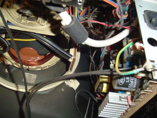

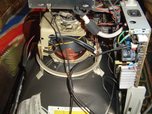

                          The first picture is where the wires on the side of the board go into a closed box. The solder joints are not visible. They are under sheet metal and I see another board I assume the wires are conected to. The problem is all the copper use seems it might get destroyed if I want to resolder the joints. unless any one has had this problem.
                          The other end of the wires going to the deflection area to the main board is in picture 2. It is a simple plug looks like it is in good shape.
                          The 3rd pic is a top view of the wires and deflection.
                          Crt neck board (Covered by Shield) you can see in my first post has some wires and plugs is this the Neck you were referencing? Th3_uN1Qu3
                          4th picture is of the back of the crt the neck board.
                          The last picture is the board on top of the coil it is a bad picture but I wanted to use it to see if this is where I should check for problems.
