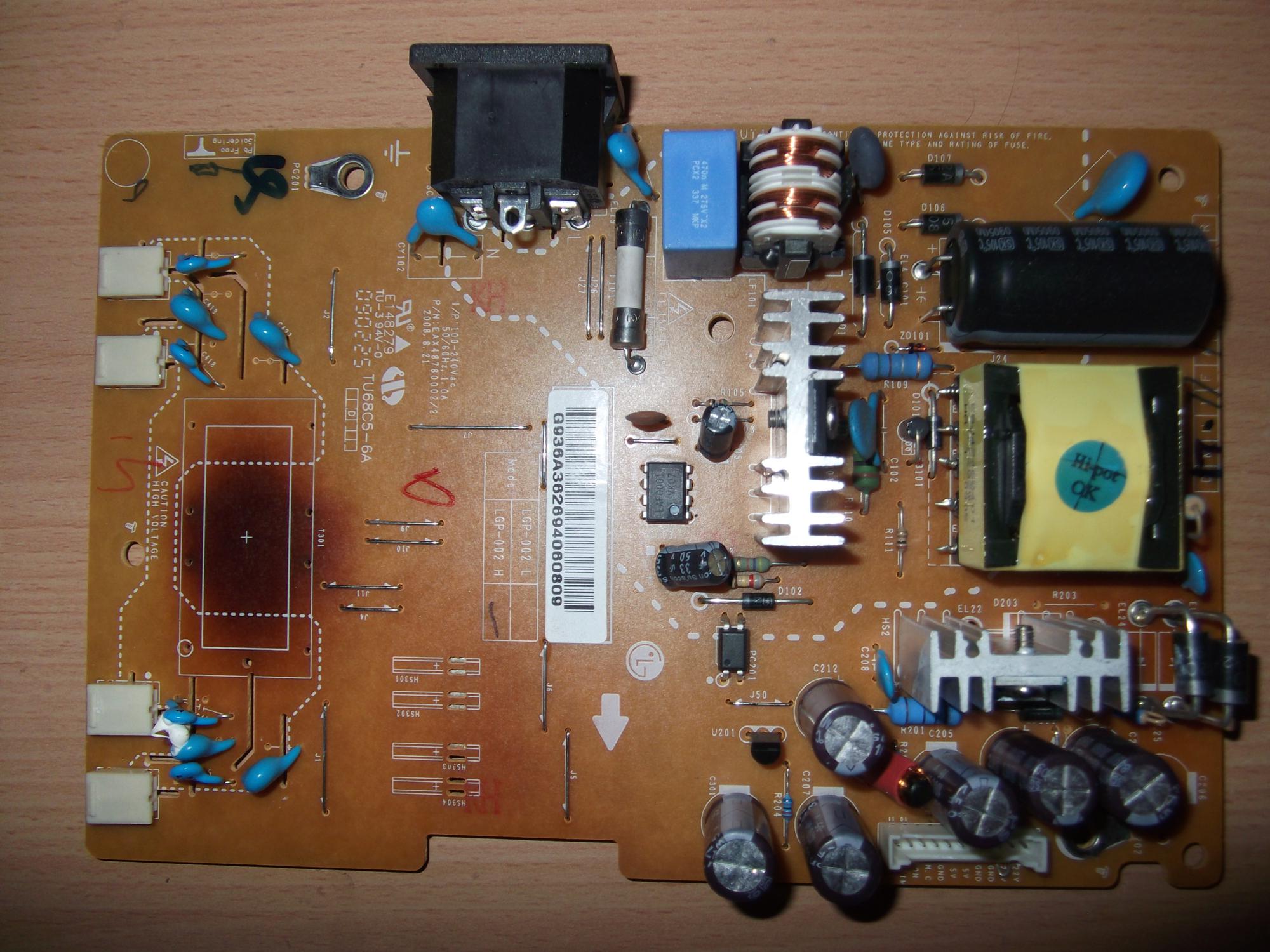

    I picked up a cheap LG LCD monitor (model W2242S) on eBay and was hoping it'd be a simple job of replacing some obviously faulty capacitors, but I think there's a little more to it than that.
    The screen powers on for a couple of seconds, displays the LG logo and then the display turns off. The power LED stays on. The classic "2 seconds to black", I believe.
    The problem (or at least part of the problem) seems to be the inverter transformer as it looks like it's got very hot and left burn marks on the PCB. I'm no expert, so was hoping someone might know what could have caused this, so when I replace it, I can ensure it doesn't happen again.
    Any help would be greatly appreciated. I've attached some pictures of the board, and a close up of some possible problem areas? You'll notice I've de-soldered the transformer (I wanted to take a look at it separately), but I can always take pictures of it if anyone needs them.

    Discoloration can be simply from prolonged heat exposure of the board to the transformer. It does not necessarily mean the transformer is bad. Actually, the fact that it works at all sort of precludes a faulty trafo assumption.
    The real culprit is likely those Su'scon caps.

      Since you already removed the inverter transformer, check it for shorts. With your meter set to 2K ohm resistance, measure across each of the secondary windings. You should read no more than 3% difference between the two.

            I replaced all the electrolytic caps on my board with new Rubycon ones and it's made no difference. I've taken readings from the transformer (in circuit) but I'm not sure how to interpret them. They are as follows (multimeter set at 2000ohms):
            1 & 2 - 1037
            3 & 4 - 003
            3 & 5 - ~005 (approx. as reading kept jumping about, and usually settled at a figure <10)
            3 & 6 - < 010 (same as above. Reading was often different, but usually <10)
            4 & 6 - < 010 (same again)
            5 & 6 - 001
            I took readings between each of the pins, but only the ones above gave a reading. I'm guessing this means something's popped inside?
            I've attached pics for reference to show how my numbering convention correlates to each pin.
              Re: LG W2242S with burnt out inverter transformer
              Hi - You have either missed measuring or missed posting the most important
              7-8. In your picture the secondary windings are 1 to 2 and 7 to 8.
              The others are primary windings and are not often at fault.
              7 to 8 should be within 3% of 1 to 2 ie 1006 to 1068 ohms.
              If not it is probably bust but always worth taking out and checking again.

                        Update: bought a new transformer (one selldoor linked to), which arrived the other day. Fitted it and monitor is back up and running!
                        Many thanks to all for the help
