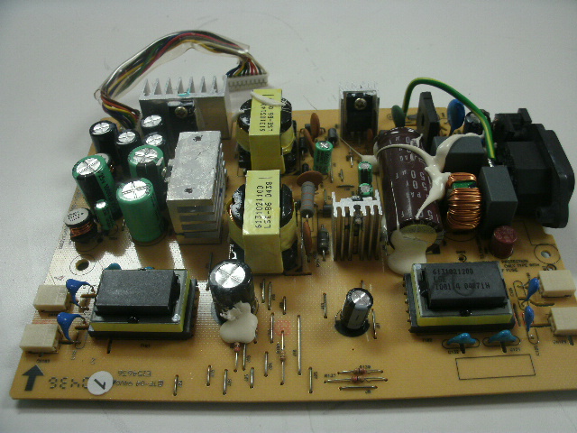

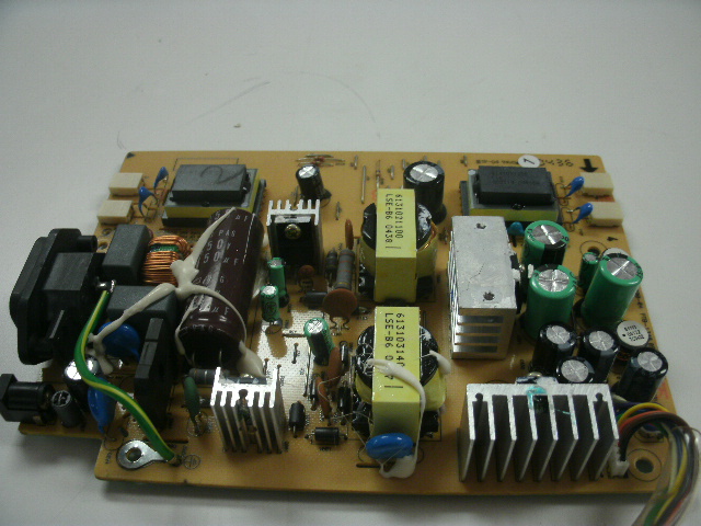

    Dell 1703FPt Flashes on then off
    I have a Dell 1703FPt that will flash on for a second then off. The image is still there just the inverters appear to be shutting down.
    With an ESR meter I found c809 to be bad. I have also replaced the caps that are green (this was before the esr Now I am stumped would appreciate the help.
    No apparent burns on the inverter xfmers
    This is the one piece psu/inverter design. See attached pics.

      Have you checked the pico fuse ?

        Re: Dell 1703FPt Flashes on then off
        I agree .read the guide. Personally I would try and check the inverter transformers first. I was trying to read the numbers off the one on the right to advise you which were the secondaries but couldnt quite make it out. Nor could I read the power supply board number. It is usual to have pictures looking straight down so that these can be read along with other board information. You should also post a picture of the underside.
          I found it!!!!! shorted wire on one of the CCFL's
          Thanks for the input guys!!!
