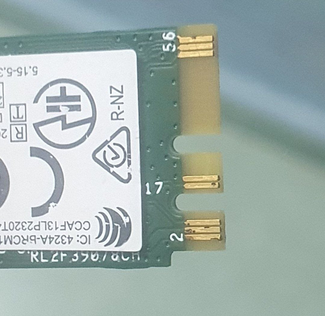

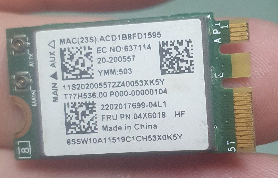

            Originally posted by OntarioTL
            Hey Flea,
            I realize the build configuration from Dell states no BT. The wifi card that was installed does have BT built in, but I have read on other posts outside of this forum that Dell can grey out this option at the factory and assuming it was put into the default bios firmware. I've even swapped out wifi cards and verified BT is fine. Even the one verified I installed on this laptop, the BT was still greyed out.
            There was another forum member whom had the same issue with a different Dell model and I think it was Hoaca who helped him out as well with a fixed bios. According to the member, the fix had worked. I have a couple of units like this and was hoping it could be removed.
            I encountered this error on Dell Precision 7560 and Latitude 5520. I replaced the wifi card as described and received bluetooth normally. The signal pin on the wifi is different from the Wifi AX201 card, so maybe the error is due to the signal line on the mainboard, you can try Click image for larger version
ID:	3692386 Click image for larger version
