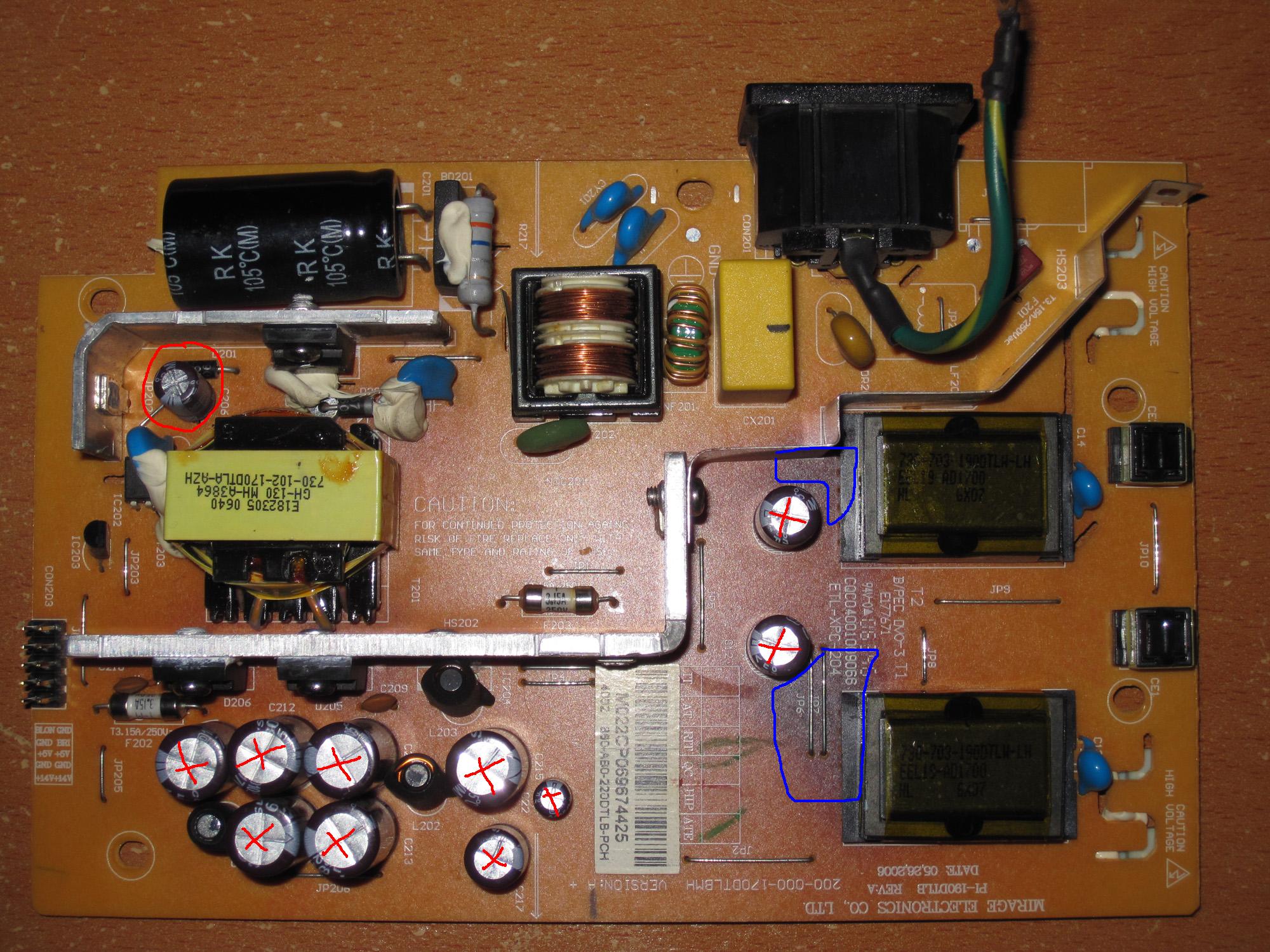

    Good evening/morning everyone!
    This is my first post on this forum even though I've already spent hours reading it. It's passionating!!
    Since last saturday my 5 year-old 22" screen wouldn't turn on for more than 2 seconds.
    I've read multiple posts which were stating the exact same problem as mine and at the beginning I thought that one of my CCFL bulb was dead (causing the other one to shutdown automatically). Going on with my investigation, I've figured out that both CCFL bulbs were functioning correctly when plugged to one of the two pairs of connector. (each at a time, obviously)
    I suspect my Mirage PI-190DTLB powerboard to only provide current to only one pair of the CCFL bulb power connector (the bottom one, on my pictures, which corresponds to the upper CCFL bulb of my monitor).
    The pair of connectors on the top, "CN3" and "CN4" doesn't seem to have current going out, as they don't lid their attached CCFL bulb.
    I have limited knowledge in electronics and circuitry, as the only soldering lessons I had were about 12 years ago in junior high. I can solder basic components though!
    My question, to the wise and experienced community, is about what I can do or test, as I find it very odd that this board only provides current for one bulb. I've eye-checked every components on the PCB very meticulously and none of them appeared to be leaking or blown.
    1) The inverter transformer secondary windings for those 2 connectors could be open. You will need a multimeter to verify.
    2) 2 seconds to black is described in detail starting with posts #19 and #20 at

      Hi this is the same psu as used in the Phillips PHP-X19 so threads on that monitor will help you .
      I have marked in reds the caps that usually need changing (even if they look good) and in blue i have marked scorched area under the transformers .

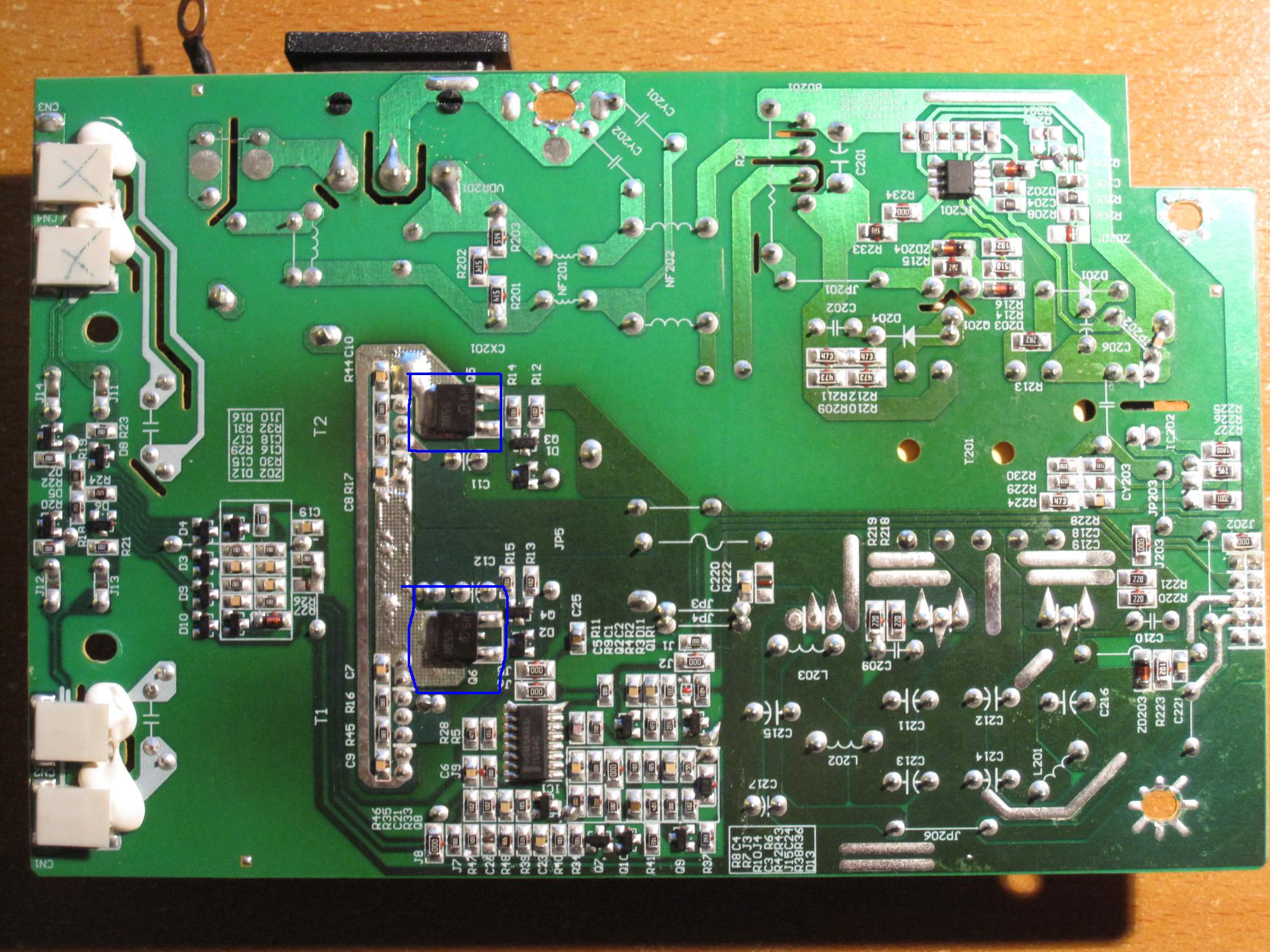

      If you look on the underside (pic 2) i have ringed in blue 2 chips
      MTD3055VLT4 N-Channel Power MOSFET 60V/12A, DPAK
      these may be failing due to onerheating hence the scorch marks on the upper face

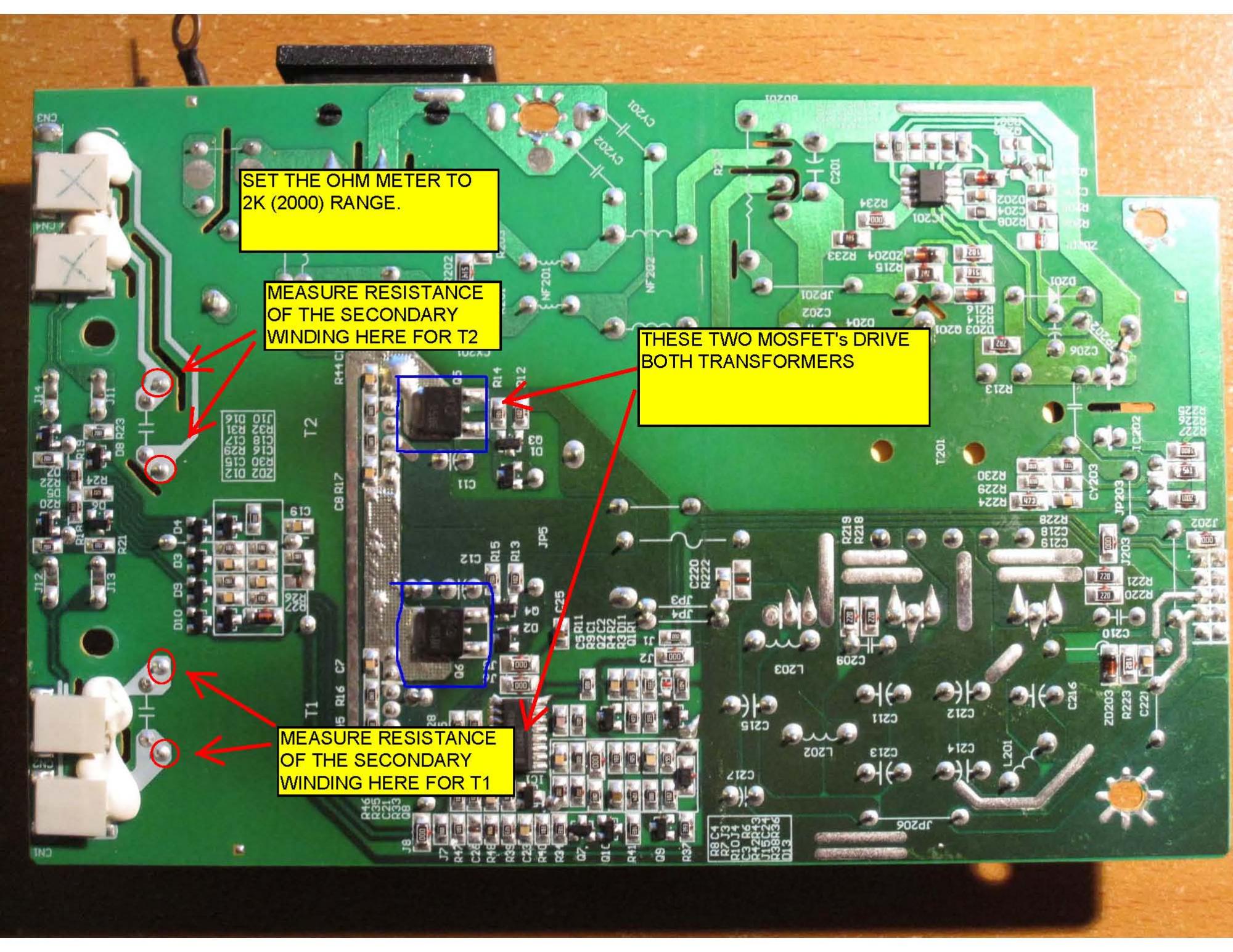

                  From your statement "I suspect my Mirage PI-190DTLB powerboard to only provide current to only one pair of the CCFL bulb power connector (the bottom one, on my pictures, which corresponds to the upper CCFL bulb of my monitor).
                  The pair of connectors on the top, "CN3" and "CN4" doesn't seem to have current going out, as they don't lid their attached CCFL bulb."
                  I looked at the board layout, the two inverter transformers are driven by the same two MOSFET's on the bottom side of the board, as you indicate that only one set of transformer wil light up the lamps for seconds, so it means that the one without output will more likely to have open winding or open circuits. You need to check the continuity as suggested by retiredcaps in the #2 post. See pictures, take the measurement and tell us what you read.

                    Thank you budm for your message.
                    I've tested them and here are the results: (budm's drawing)
                    - transformer exit on T1 : 780 Ω
                    - transformer exit on T2 : OL / 1
                    I have tested the said transformers at their entries too:
                    - 0.5 Ω to each pin (which is the same as the 3 fuses resistance)
                    I've also tested the two corresponding MOSFETs with the diode test mode of my multimeter:
                    - gate(black) to source(red) : 1195 Ω (T1) & 1191 Ω (T2)
                    - source(black) to drain(red) : 1500 Ω (T1 & T2)
                    - drain(black) to source(red) : 689 Ω (T1) & 687 Ω (T2)
                    - source(black) to gate(red) : OL / 1 for both
                    These MOSFETs figures being identical, I think we can rule out a MOSFET malfunction.
                    Does this necessarily mean that the transformer on T2 is faulty and therefore that it should be changed?
                    I appreciate your help guys!
                      Re: Fujitsu-Siemens L22-1W - PI-190DTLB board (2 sec to black)
                      T2 has open winding, need a new one.
