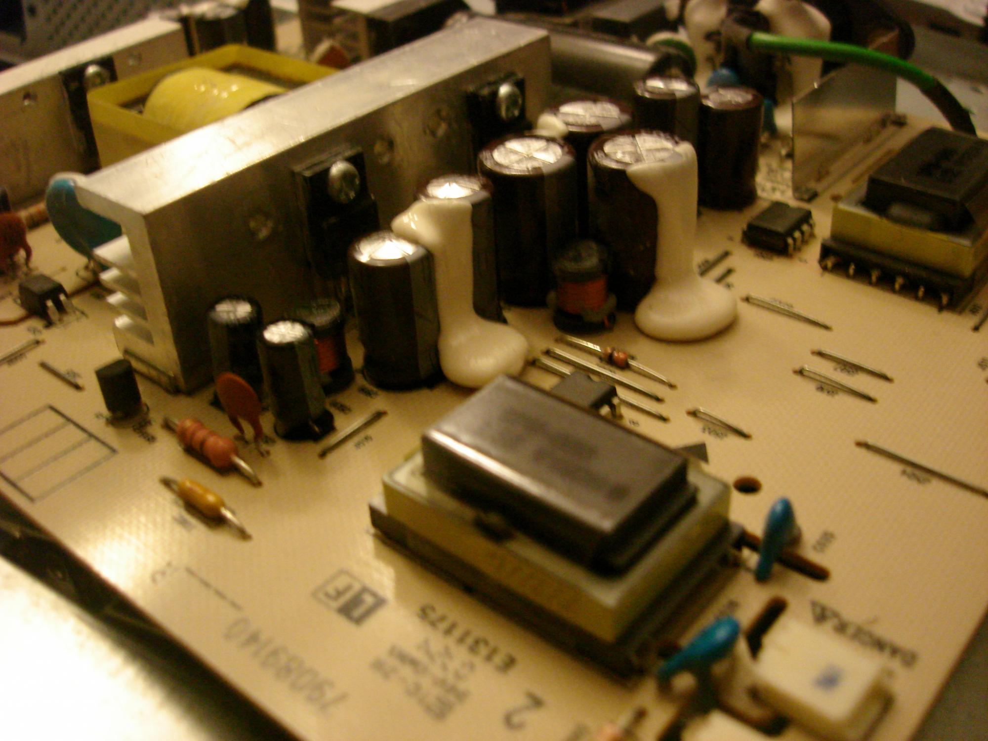

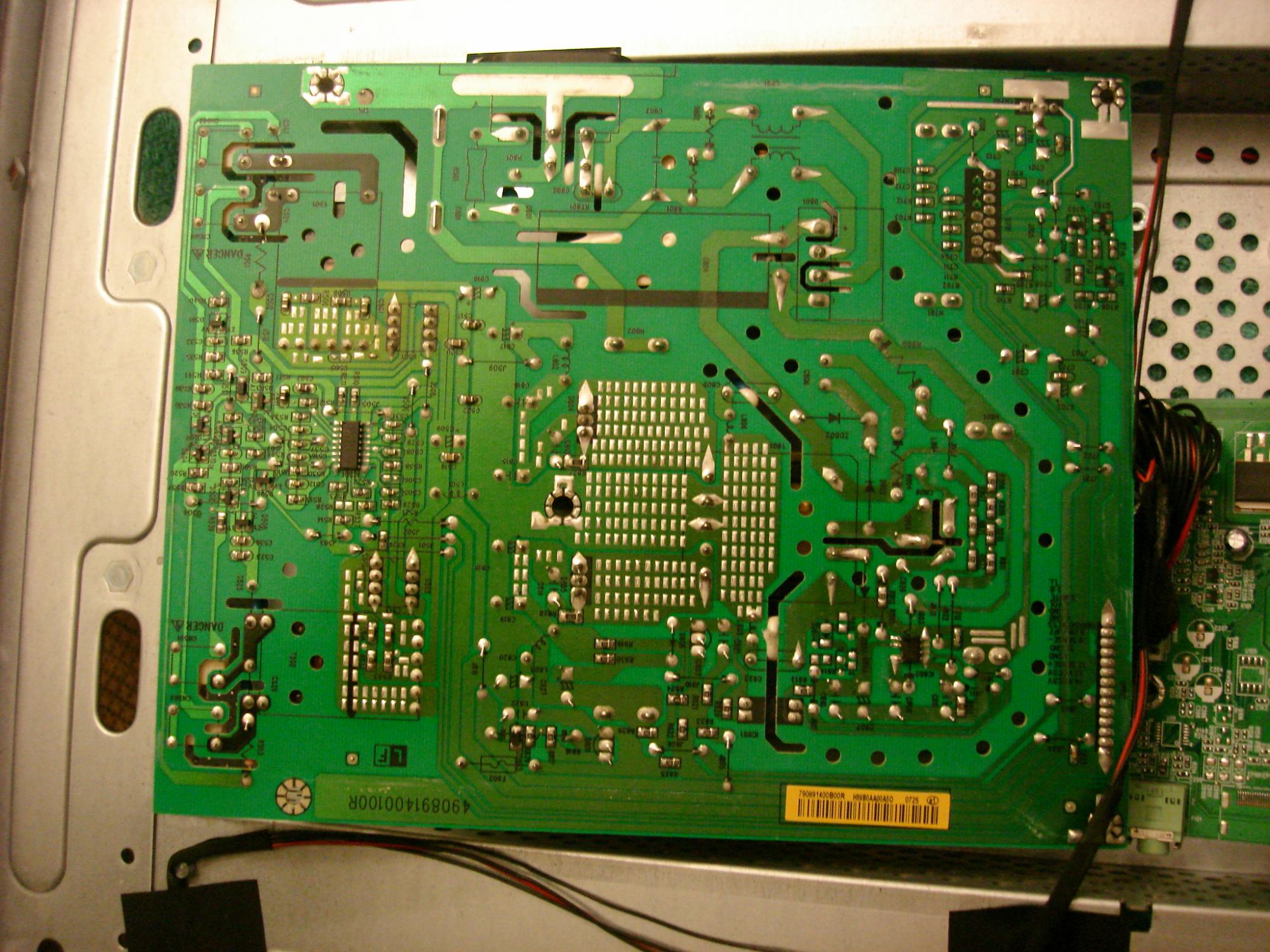

    Hello
    I recently picked up this monitor for cheap and am now trying to get it back up and running. I have spent the last 2 days browsing throught the forums with problem, but have not found anything like it.
    When I first turned it on I could see the screen switch from 3 diffrent colorl. It went from Balck to Gray to a lighter gray with lines going through it every .25 inch or so. There was a hum in the back sounding like maybe a mouse??
    Today I was going to take some pictures of the screen colors and post them up here but when I plugged it in all I got was the mouse hum coming from it and no power light that I could see.
    I took the unit apart thinking I was going to find some bad blown caps, but everything in there looked fine. ( when I had it on, I could not smell anything burning or smoke)
    I have hooked it up to the computer with both kinds of cables and could not get it to work. I did a reset and still nothing
    Thanks for the help
    Andy

    Re: HP W2207 no screen no power buzzing!

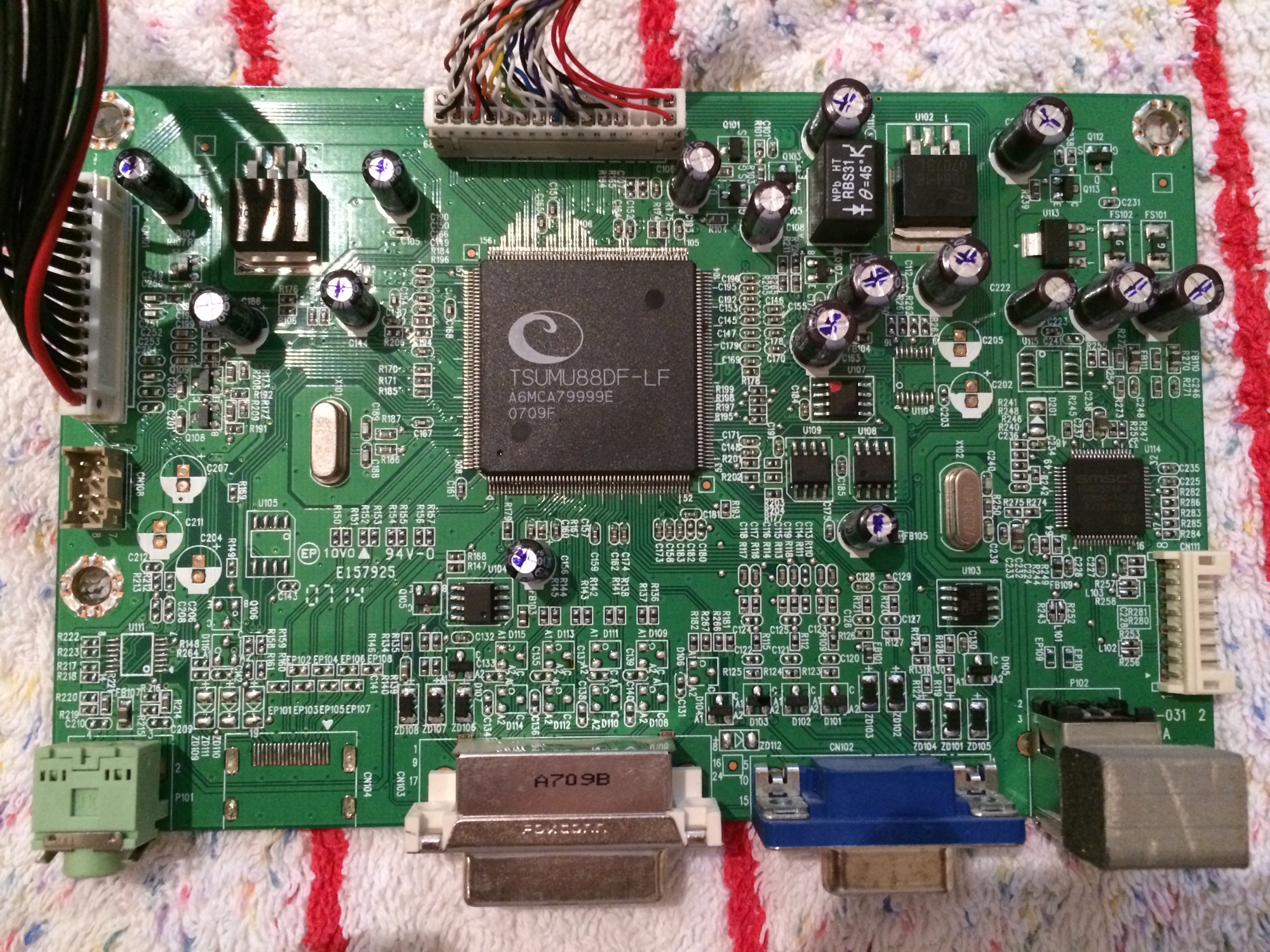

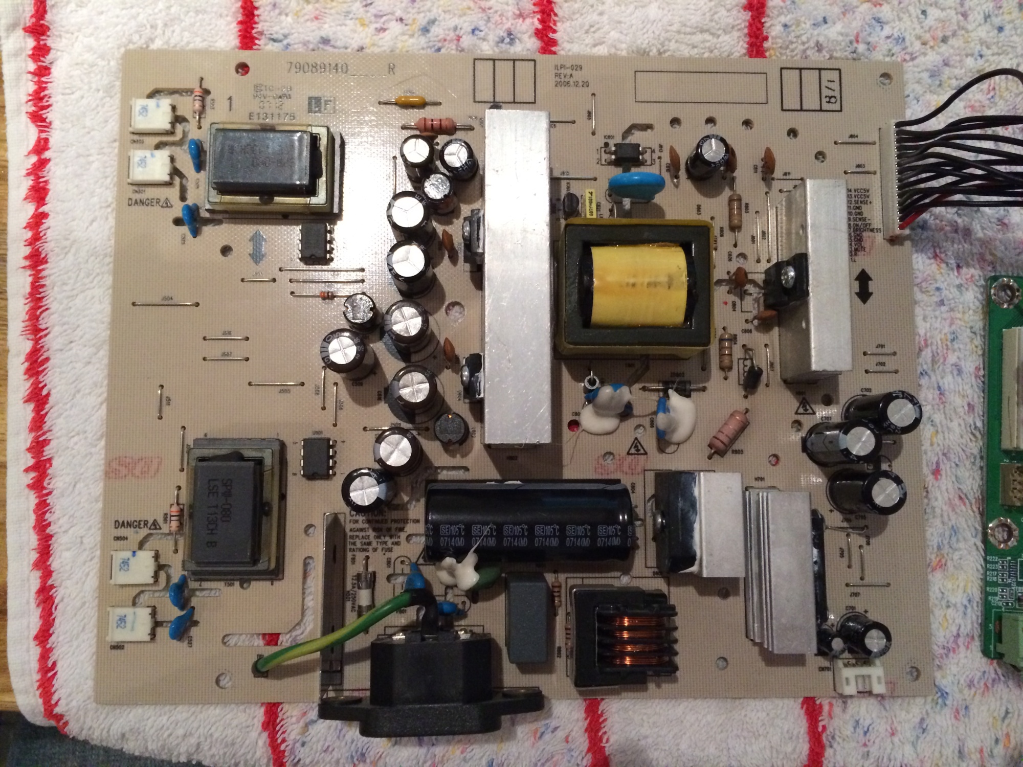

    I guess I have never seen a blown cap. I just checked some pictures and it appears I have a few. What are the chances that is the problem? What kind of caps are recommended on these devices???
    • Scenic
      o.O
      • Sep 2007
      • 2642
      I can see at least 2 bulging capacitors in those photos.
      The two to the left of U502.
      They all look to be Su'scon, which are known to be complete garbage (much like HP in general these days, but that's another story..)

        ^ yeah, those 2 at least - closer, well focused pics of the boards makes all the difference.
          So would I be safe to assume that the caps are my problem??? Should I replace all of them on both boards???
          • retiredcaps
            • Apr 2010
            • 9271
            I have this exact same monitor with the same 2 caps bloated. I recapped the monitor back in June 2010 and it is my main monitor. I suspect those 2 caps are dried out due to the heat from the IC mounted on the heatsink.
            You should recap all the caps on the power board as they undergo the most stress.

                  Well

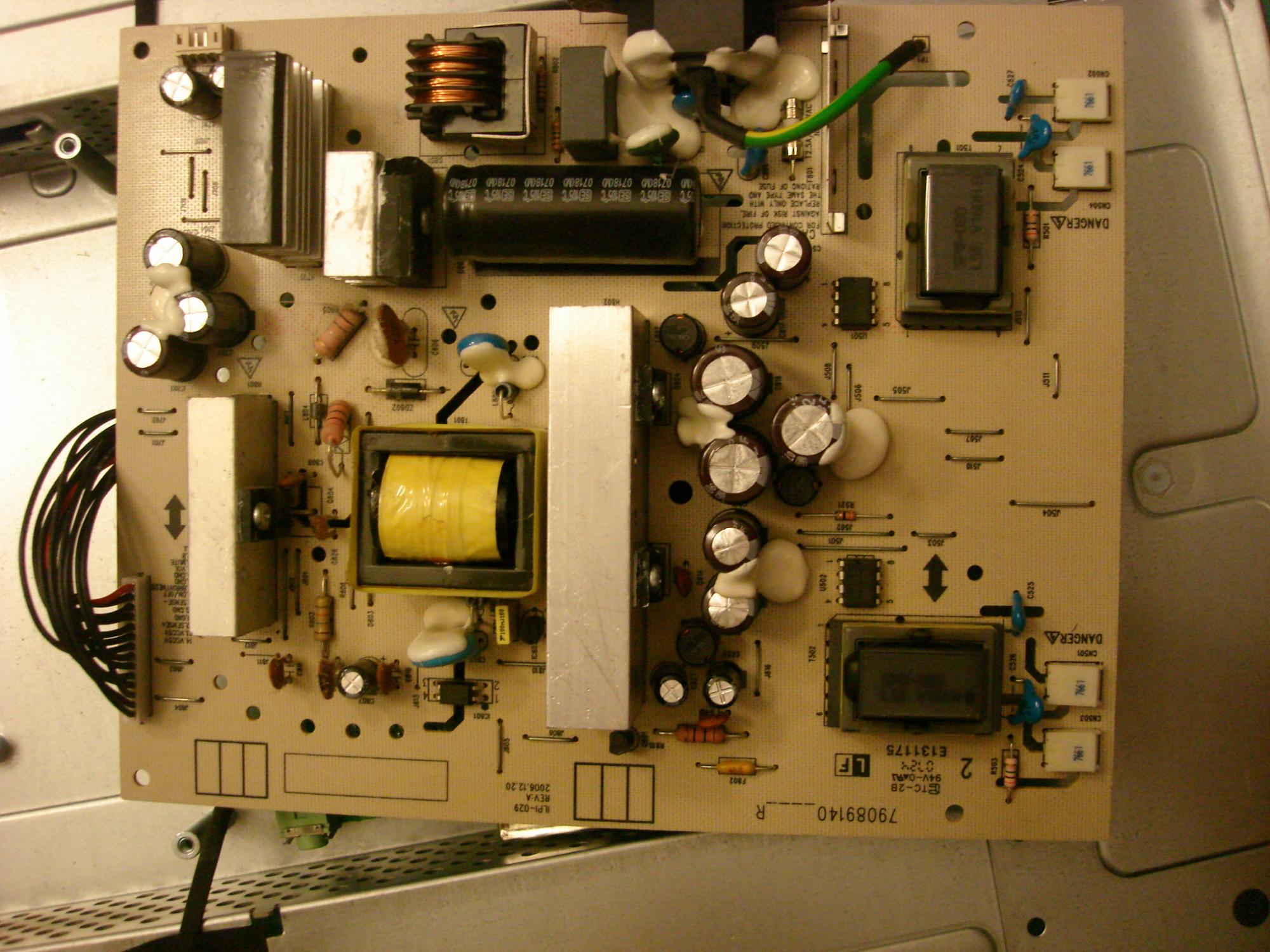

                  I recieved all new caps and replaced them. The monitor is doing the same thing. It flashes from a white to grey to a darker grey and keeps doing this. It switches colors about every second. I have tried diffrent cables and get the same. What would be the next most logical reason for this, and how would I go about testing it????
                  Thanks for your time!!!
                  Andy
                  • retiredcaps
                    • Apr 2010
                    • 9271
                    1) Post a picture of the newly recapped power board.
                    2) Reseat and clean every connection on all the boards including the ones to the top of the panel board. I use isopropyl alcohol.
                    3) Try a factory reset to defaults from the menu.
                      OK I tried sll of those things, and still have the same result. I did take the pictures of the recaped board.
                      Andy

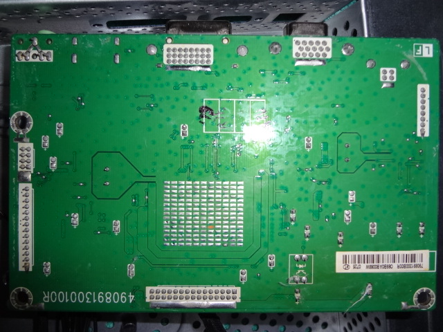

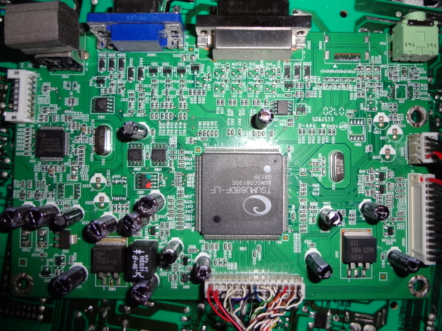

                        1) Post a picture of the main board.
                        2) Do you have a multimeter? If yes, are you familiar with using it to take DC voltage?

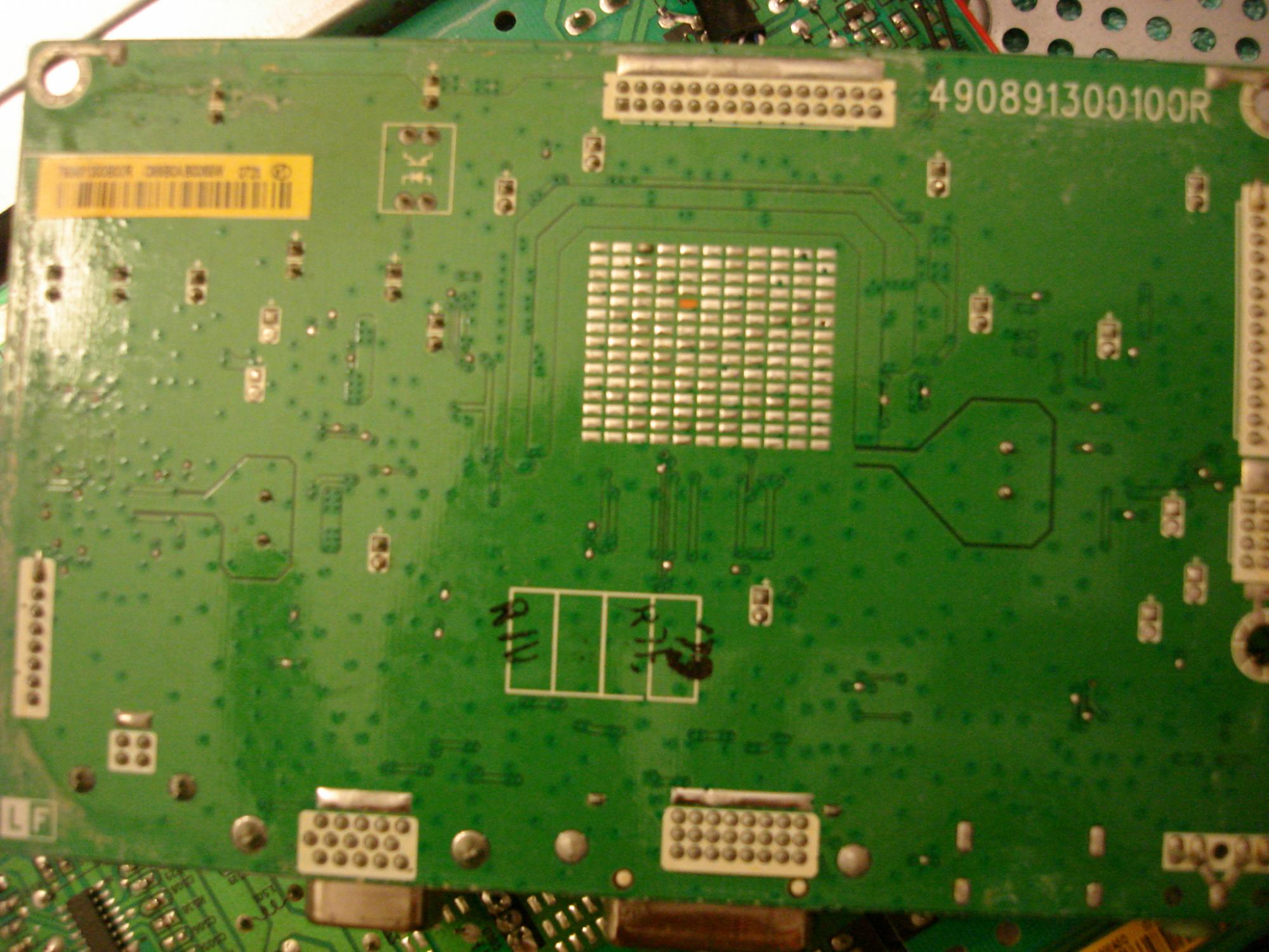

                          ok I believe this is the main board? It is the only other board in the tv except for the one on the bsck of the screen. Anyways yes I have a multi meter and I can read it.
                          Thanks!!!
                          Andy
                          • retiredcaps
                            • Apr 2010
                            • 9271

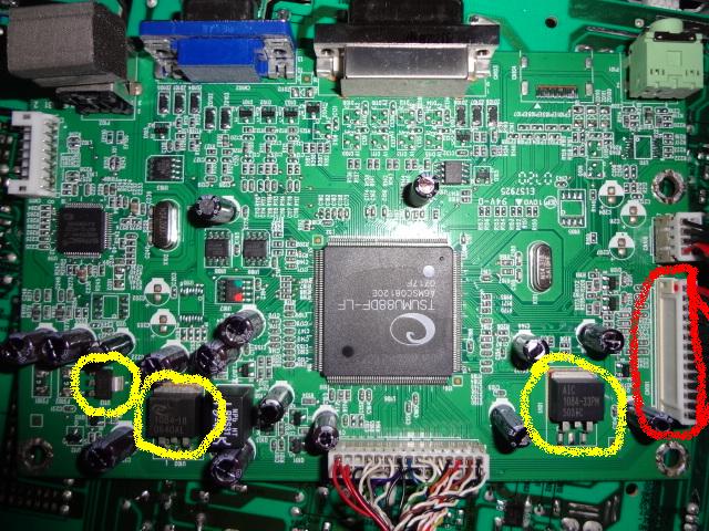

                            1) Marked in yellow are 3 voltage regulators. Report the DC voltage on each pin. You don't have to measure the fat tab. Report the part number as well. For example,
                            U1
                            part AS1117-33
                            pin 1 = 0.0V
                            pin 2 = 3.31V
                            pin 3 = 4.99V
                            2) In red is the connector to the power supply. Measure each pin and see if all the voltages are stable or fluctuating. Report the voltages in a similar format as above. Make sure to include the legend from the power supply so we know what the expected voltage should be compared to the actual.

                              OK
                              I took my meter from ground on the 14 pin power plug and here are my results
                              U113
                              LD1117A
                              L33AUC
                              All voltages 0.01
                              U102
                              1084-18
                              0640AL
                              Pin 1 .013
                              Pin 2 1.8
                              Pin 3 5.19
                              U101
                              1084-33PM
                              503IC
                              Pin 1 .013
                              Pin 2 3.321
                              Pin 3 5.03
                              On the 14 pin connector pins 5 6 10 and 11 are all ground
                              from ground to pin 1 .012
                              pin 2 .012
                              pin 3 .690
                              pin 4 2.27
                              pin 7 3.3
                              pin 8 .049
                              pin 9 .009
                              pin 12 5.03
                              pin 13 5.03
                              pin 14 5.06
                              Andy

                                1) U101 and U102 are good.
                                2) U113 may have failed. If you measured it correctly, pin 2 should have been 3.3V DC.
                                3) Check the dimensions, but this should work
                                http://search.digikey.com/us/en/prod...28-1-ND/586228
                                4) In #2, I say "may" because there are 2 SMD fuses on the main board (circled in blue). Check both. A good fuse should measure less than 1.0 ohms. If one or both are open, it could affect the readings U113.
                                5) In post #12, I asked you to post a picture of the main board, but neglected to see that you already provided that in post #1. Sorry, my bad.
                                Probably lack of sleep that day.

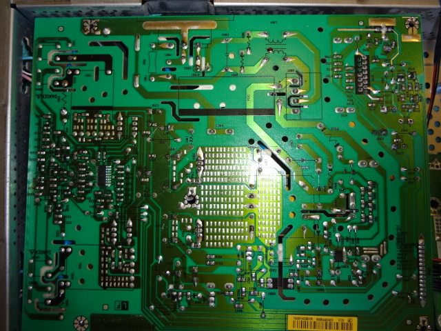

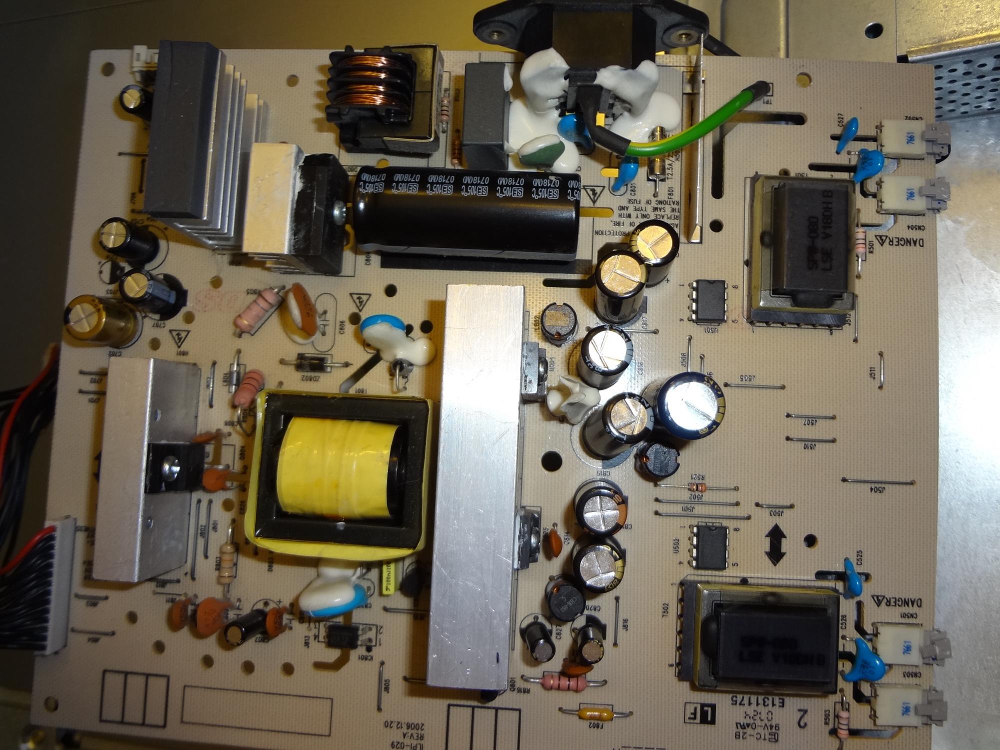

                                        I hope somebody can help me - I've recently bought the HP w2207 monitor and I'm now trying to repair it.
                                        The issue is: It won't turn on. Only the signal LED from power button is blinking.
                                        I disassembled it and replaced all caps from the power board (except the huge cap), but the issue reamins -> Only blinking LED.
                                        I did some measurements with my multimeter & I get fluctuating voltages out of U101 and U102 / U113 has 0 volts.
                                        I used pin 11 from 14-pin connector power board as ground.
                                        U101
                                        AIC
                                        1084-33PM
                                        Pin1: 0v
                                        Pin2: 2.7-3.2v
                                        Pin3: 3.9-7.3v
                                        U102
                                        AC
                                        1084-18
                                        0707BL
                                        Pin1: 0v
                                        Pin2: 1.7-1.8v
                                        Pin3: 3.8-6.9v
                                        U113:
                                        A1
                                        AS1117L-33
                                        80652 84
                                        Pin1: 0v
                                        Pin2: 0v
                                        Pin3: 0v
                                        My problem is that I'm a newbie in electronics & I don't really understand what this measurements try to tell me...maybe someone of you guys can tell me? :-) I'd very much appreciate it!

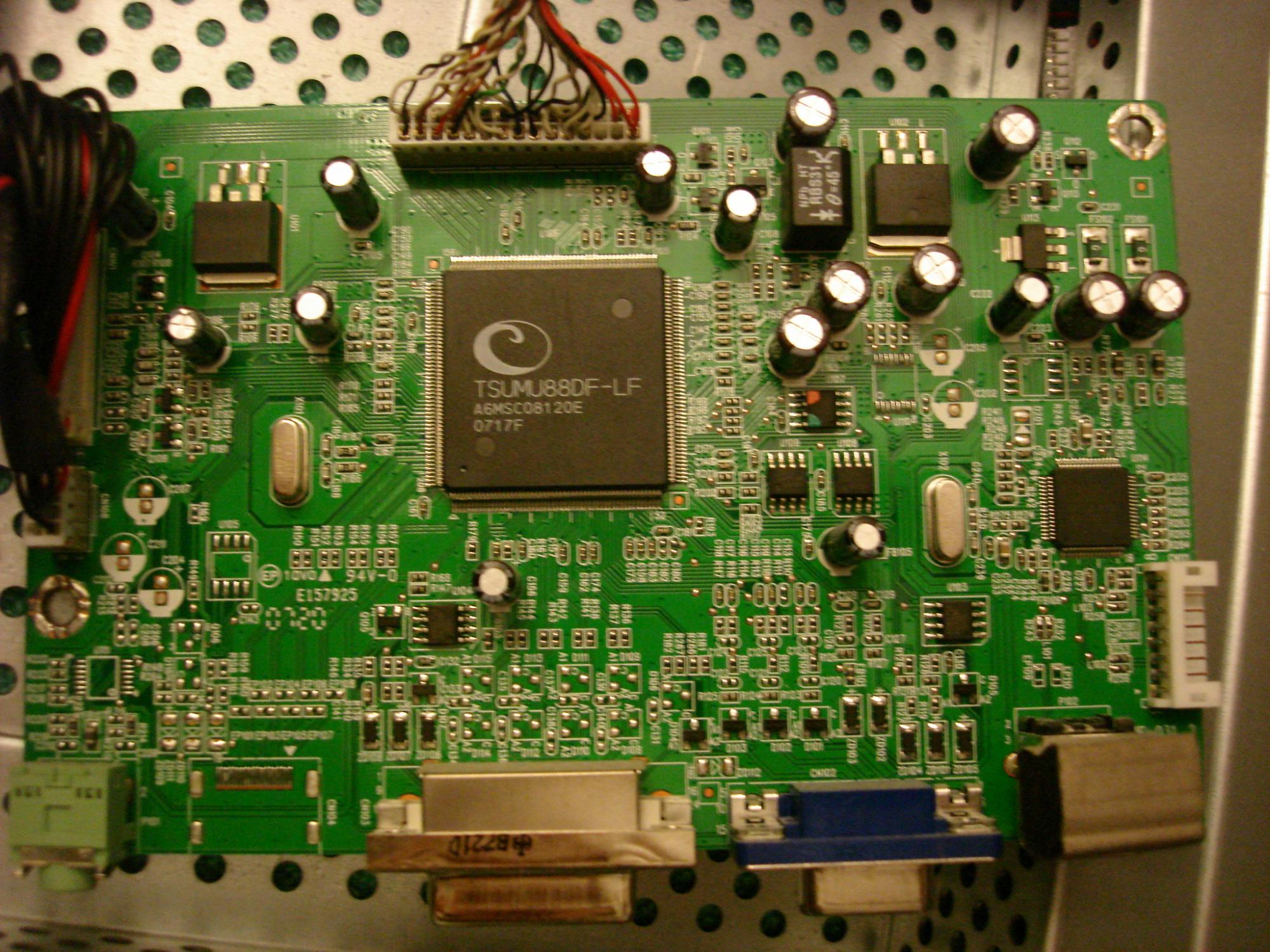

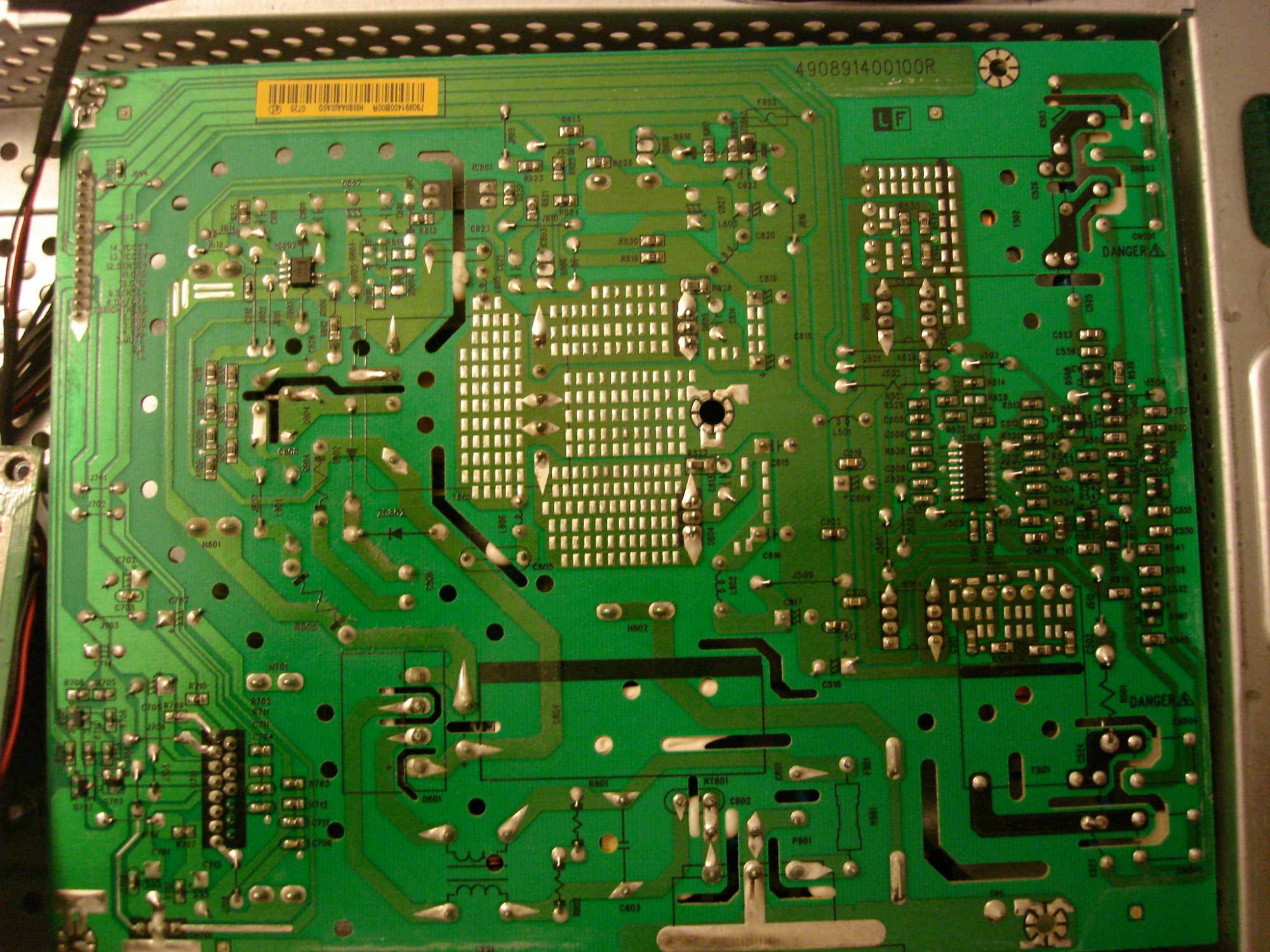

                                        I attached pictures from the main and power board.
                                        Many thanks in advance!
                                        Matthias
