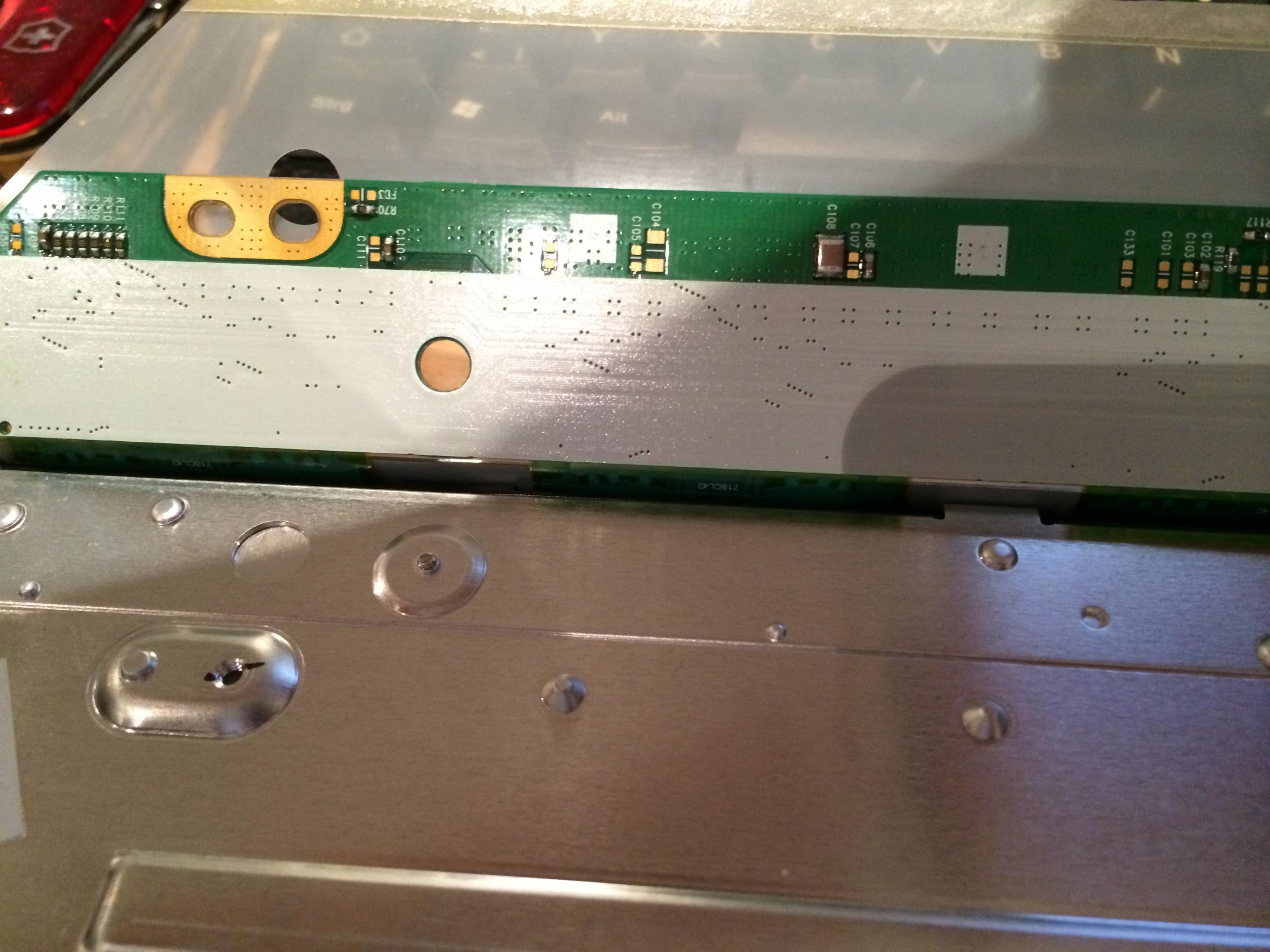

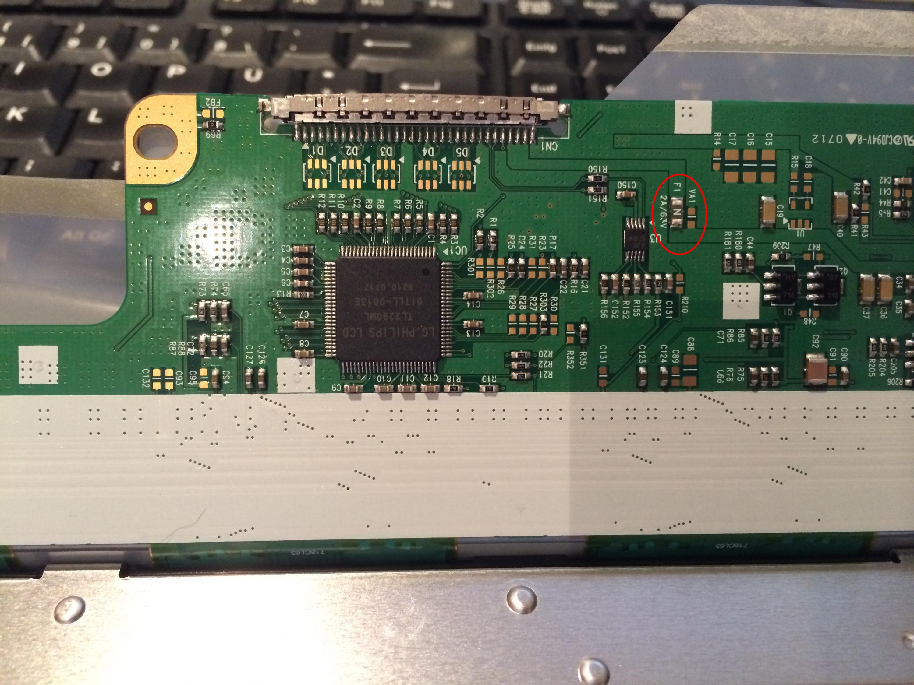

                              #34
                              Re: HP W2207 no screen no power buzzing!
                              You need to check the SMD fuse on the T-CON board of the LCD panel assembly, there should be either 5V or 12V which is supplied by switched transistor on the logic board.
                              • mgaa80
                                • Jan 2014
                                • 9
                                #35
                                The only fuse I found on the T-Con Board was the one in image 2 - it was ok, showed 0.4 Ohms. Attached pictures of the T-Con board.

                                  #36
                                  Budm was asking what was the voltage on the fuse.
                                  Other possibilities for checking are the "0" resistors - like R24
                                  Just test for continuity like a fuse.
