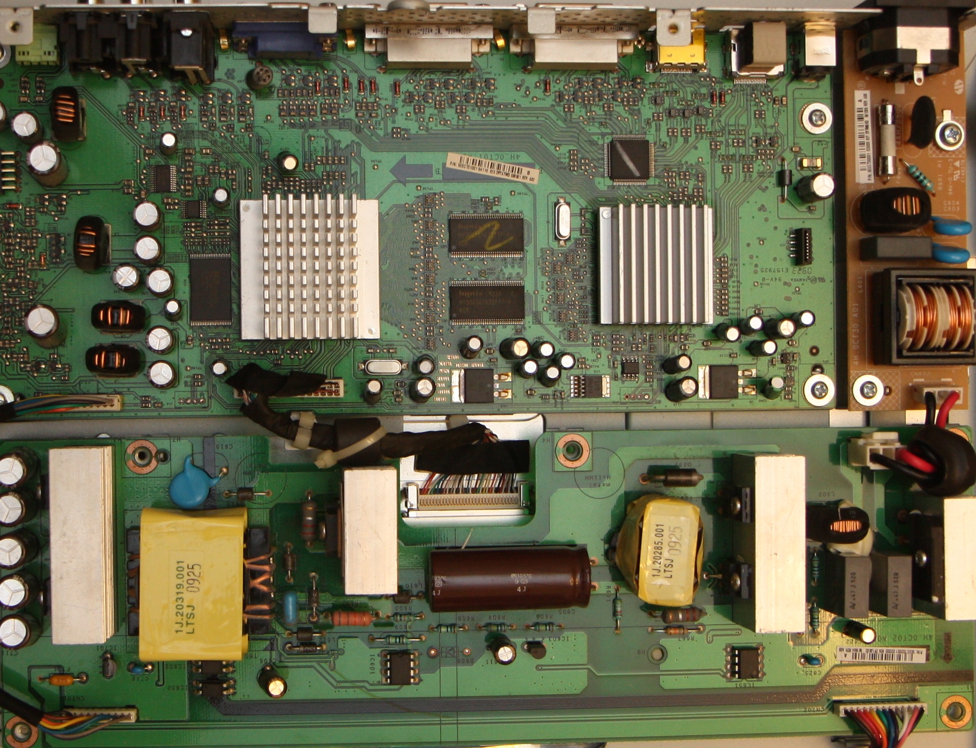

    Greetings fellow badcap'ers... been awhile!

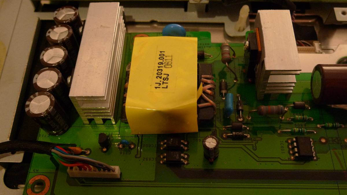

    No bulged caps, nothing out of the ordinary, can't find any schematic to see if I'm getting the appropriate power. I did trace it to a transformer where there isn't any power going past it, but when I google it, nothing comes up.
    On top it says... "1J.20319.001 / LTSJ
    Thoughts/comments on where to start?

    1) What is the DC voltage across that small cap (right of IC652)? Is it stable or fluctuating?
    2) IC601 is likely your SMPS chip.
    a) What is the part number?
    b) Find the datasheet.
    c) Is there DC voltage on the Vcc pin?
    d) Is it stable or fluctuating?
    3) I assume you have mains x 1.414 DC voltage across the large filter cap? That is 120 V AC x 1.414 roughly 165 V DC?

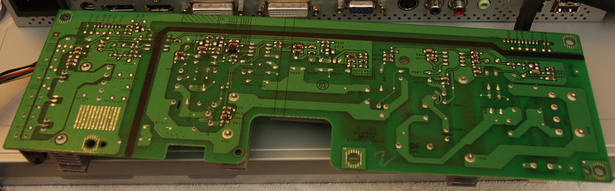

        We can sometimes help a lot more if you post good clear pictures of the whole chassis, and then pictures of each board, front and back (in the same orientation) and close up of connectors, (max resolution 2000x2000 and 2MB) using the manage attachments button, which is found by clicking "go advanced" under quick reply.
        Examples of what is needed
        https://www.badcaps.net/forum/attach...7&d=1280167246
        https://www.badcaps.net/forum/attach...6&d=1280167246
        https://www.badcaps.net/forum/attach...4&d=1280167246
        It will be useful if you can say a bit about yourself - skills tools etc.

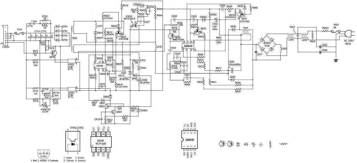

            Replacing the shunt regulator, IC701 in the attached schematic, fixed my Dell 2408WFPb power supply.
              Re: Dell 2408WFPb / 2408WFP - No Power
              Well done bicycle6228 that is a good fix and the schematic will help others.
                  Thanks for posting the SCH. Where in the world did you find the SCH?
                    >Did you check every component to get to that one or ...
                    There was nothing obviously wrong via visual or resistance checks, and I could hear the ticking in T601, so I guessed the SMPS was trying to start, and I knew it wasn't an excessive load issue. I bought another 2408WFPb with a working power supply, put the two power supply boards side-by-side, focused some resistance checks on the feedback/isolator area and found differences associated w/ IC701. Out of circuit, the KA431 shunt regulator did not behave right per simple VOM checks. Swapped in a replacement KA431, and voila!
                    It is hand drawn, by me, from scratch. Yeah, I'm retired and have many hours to kill.

                      Yes, it was very generous of you to share that schematic. However, I noticed that some of the resistors and diodes on the schematic do not have values associated with them. It would be great if someone that still has the board out can fill in those missing part numbers/values for future reference.

                            The PSU output is 24v, or 23.8v on my board - I found the culprit:
                            Referring to bicycle6228's schematic, D602 (EGP10D) was duff, measured 47R both ways.
                            That would explain why there was low voltage (7-8v) on C606, solely due to the chips internal start-up current source from the HV. The NCP1203 was trying but.....
                            I replaced it with an UG2D (all I had in my scrap box) and it fired up.
                            Again thanks to bicycle6228 for the schem.
