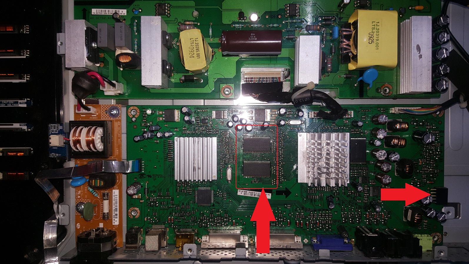

                          He everyone,
                          This thread was already too old but since I found the material useful in my case, thought that my follow-up would be useful for someone else...
                          This was my case:
                          Whenever I unplugged my Dell 2408wfp, there was a 50% chance it wouldn't turn on with a half dim power LED. So I had to unplug and re-plug a few times to power it on.
                          Finally it got really bad and didn't respond to this trick and wouldn't turn on at all...
                          1st step: Disassembled and checked PSU: ALL RIGHT
                          2nd Step: Heated main CHIP to about 60'C with a Heat Gun: power LED flashed once and after half second turned on and stayed on forever. So I thought BINGO! that's it! and applied sirzur's trick to preheat the CHIP with resistors. BUT surprisingly it didn't work . It would heat the chip but it didn't power up!
                          3rd step:I realized that it is not the main chip that was faulty and the reason it worked with Heat Gun but not with localized Resistor Heater, was that Heat Gun heated the adjacent elements too. I started examining those elements and found out that the faulty elements are U20 & U21 chips (marked in the attached image) that were quite close to main chip and responded well to heating. So I decided to reflow them. I used Heat Gun set to 300'C without any insulation for nearby elements! (I know, I could toast capacitors beside those chips, but fortunately it didn't happen). and VOILA.
                          Know no matter how long the monitor remained unplugged and in what temperature the device or it's components are, it turns on like a brand new device without needing any warming or anything else...
                          PS: for those for whom this trick doesn't work and might want to stick with the preheating method described by sirzur, the better calculation for the resistors:
                          15*10ohm 1 watt resistors arranged this way:
                          First group them by 3 and connect them in series => result is 5* 30ohm resistor.
                          Then connect those 5 resistors from previous Step in parallel => result is a 6ohm resistor that draws slightly less that 1 amp connected to 5v supply.
                          There is a connector on the mainboard that supplies power to the USB hub with 5 pins. the two outer ones have 5v deference. You may use them without concern about current overflow cuz it is designed to supply power to the whole HUB that has 4 USB ports and three memory sluts. But you should put a switch on the way to turn the heater off afterwards.
                          Two important considerations:
                          1-Be careful when pushing resistors in the heatsink, if you damage the thin layer of insulation on the resistors you might cuz a short circuit and damage the power supply, so check the insulation between the heatsink and heater before connecting it to the power supply.
                          2-use some SILICON GEL to facilitate heat transfer between heatsink and resistors.

                                  Hi All
                                  Update for you. Had to move rooms at home during lockdown so my problem monitor was switched off and unplugged. It got cold and now will not power up even if I heat the same area as before. I also managed to short the control ribbon cable against the power supply ( like the last poster ).
                                  Not wanting to give up I've purchased another monitor for £20.00. Powers up ok but it's got the very common black vertical line 2 inches from the left hand edge.
                                  So the question is. Can I combine these 2 monitors ( 1 dead / 1 blackline ) and produce a working one with zero defects ?
                                  Main issue I have is i'm not sure what the various boards do inside the casing. Do you think the best bet is to swap the LCD panel over ?
                                  Thanks again
                                  Wert
                                    #97
                                    Re: Dell 2408WFPb / 2408WFP - No Power
                                    You have two small PCB on the left ( they are the power supply ) and a bigger PCB which is the main "motherboard".
                                    The first power supply in which you plug the electricity is an isolation transformer and the second one is the AC->DC transformer.
                                    I would just put the working motherboard you just bought on your old monitor, that the easiest and the only solution.
                                    Personnaly I made the same move : I bought a 2048 with a defective LCD panel for 10 € but it was at least displaying something.
                                    I put the motherboard on my 2048 and at first it was working.
                                    ( Before that I could warm the old motherboard with a dryer and it would work ! )
                                    The only problem after the exchange is that the monitor would switch off after a while.
                                    It was probably a power heating problem with the power supply I fixed not as good as necessary.
                                    As I was not having the use of the 2048 anymore, I gave the two to a friend who swapped the power supply too and voila, it works again !

                                      Thanks for the advice. I'm trying to take it slow and no break anything. Removing the old motherboard from the dead monitor. This is the board with the 2 large heat syncs on it. Removed 4 flat head screws holding it down. Doesn't want to budge. Do I need to remove the hexagonal bolts securing DVI & VGA sockets to the socket plate? ie that also secure the plug/lead.

                                          Update - thanks again to nabla666 for the advice.
                                          All worked out ok. Had to swap the main board ( 2 large heat syncs ) and the first smaller power board. I think I damaged that earlier. New combo screen works well. I also have a few spare parts ;-)
