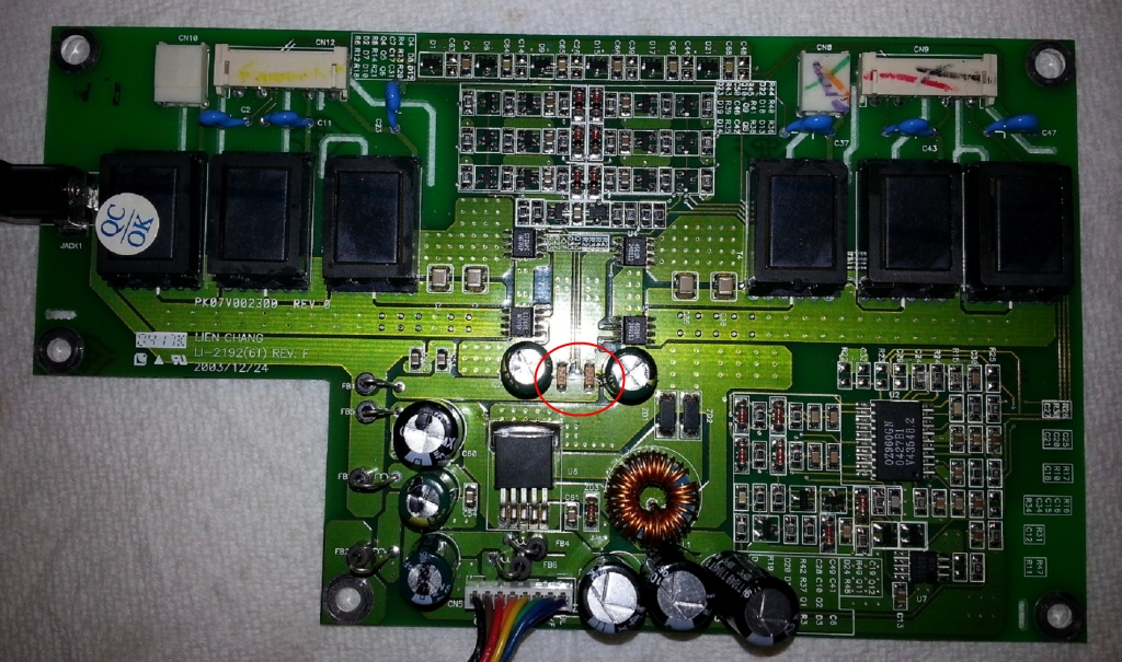

              Re: Planar PL2010M-BK -Black screen
              .. The monitor acted different with the 2 different power supplies .
              The one that came with it was no longer putting out power so the guy tossed it after I bought a new one . The one I tested it with was one I had that was lower on amps then what the original had .
              That is the Power board .. The red circle is where I replaced 2 of the three.
              470 uf 10 volt .. I only had 470 uf 25 volt available to use.
              the under side of the board shows that they were all connected parallel .

                      #30
                      Six fuses? This unit has six lamps so even one or two are broken, at least you should see the working lamps flash on for seconds before the inverter goes into protection mode.
                      We need the straight shot pictures of the inverter board top side and bottom side, the pictures must be clear enough to see traces on the traces.
                        Can we have good clear pictures of your boards posted using manage attachments
                        not posted off site.
                        They need to be like the original posters so we can see what you are talking about.
                        Mark up the board with the six fuses you have tested.
                        The problem you are having probably relates to fuses on the inverter board I think I see 1 fuse - its pretty blurred the original poster has 2 so please check They will be labelled F1 and F2 in all probability

                                    #37
                                    OK, check and report the DC Voltage readings at both ends of these two fuses which feed the B+ to the inverter transformers drive circuits.

                                      #38
                                      I got voltage on one end of both fuse's and none on the other with unit plugged in
                                      2.0 = .. 2 amp fuses?
                                        #39
                                        They should have 12VDC at both ends of the both fuses, so it means that those 4 SMD POWER MOSFETs (8-leg SMD) above those two fuses may be shorted out that caused the fuses to blow. We will need the P/N as printed on top of those 4 devices.
