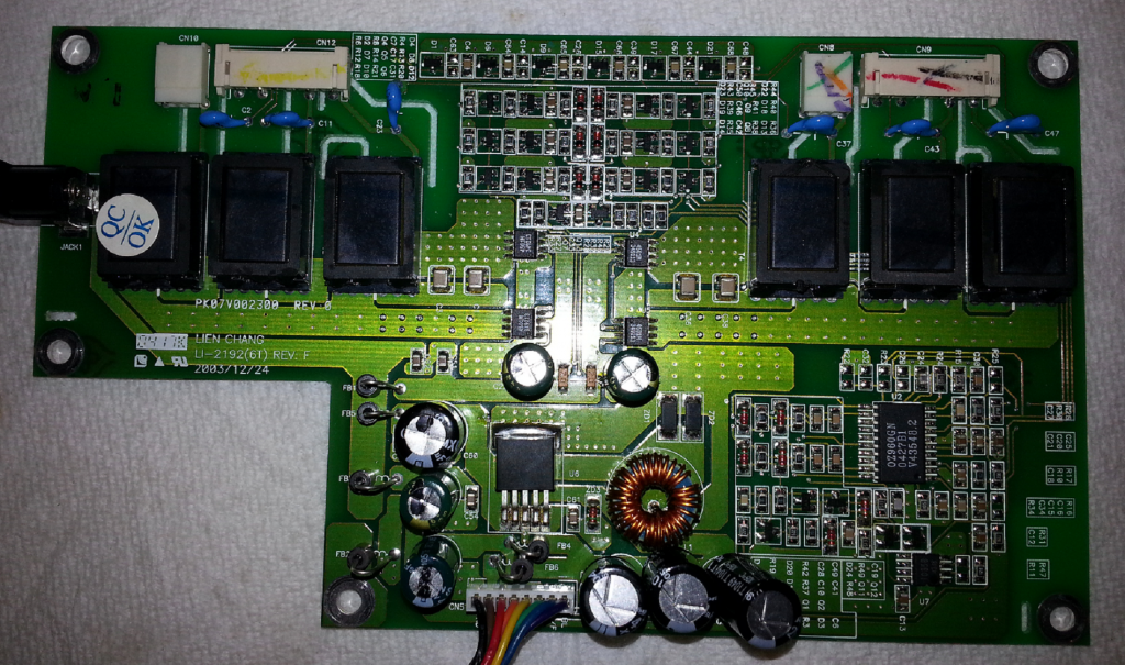

    I did replace 3 bad caps .. could they have blown the fuses?
      #42
      Re: Planar PL2010M-BK -Black screen

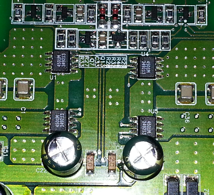

      Unless you created the solder bridge when you install the two new caps which are connected after the fuses. Those 3 caps you have circle are for the buck regulator circuit to power the main logic/scaler board.
      OK AP4501, see spec sheet.
      Check the RESISTANCE between S and D pins of all 4 devices.

        ok there are S 1 and D 1's as well as S 2 and D 2's on the diagram
        one one side S1 and D1's pass ohms
        the S2 and D2's don't
        on the other side the chips are flipped , and I get the opposite
        S2 and D2's pass ohms s1 and D1's do not
        Are the bad or is that normal ?

          #44
          "Pass Ohms" is not really accurate enough
          We need to know that actual results of the test - do it like this
          Mosfets
          If you have a manual range multimeter, set it to 200 ohms (two hundred). This is for 3 pin ICs only. You can test a mosfet (Q, IC designation) "in circuit" by (power off and unplugged)
          a) black on pin 1- red on pin 2 - record ohms
          b) black on pin 1- red on pin 3 - record ohms
          c) black on pin 2- red on pin 3 - record ohms
          If any reading is less than 30 ohms you might have shorted mosfet. Remove from circuit and repeat the tests to verify.
          Some mosfets are more than 3 pins. To test those, identify the part number and search for its datasheet. Once you find the datasheet, the pins will be designated source (S), gate (G), and drain (D). It will probably be documented as S1, S2, G1, G2, D1, D2.
          Simply test
          a) black on pin S1- red on pin G1 - record ohms
          b) black on pin S1- red on pin D1 - record ohms
          c) black on pin G1- red on pin D1 - record ohms
          Repeat for the "2" pins. That is S2-G2, S2-D2, G2-D2.
          and post the results - some may be "OL" "OF" or "1"
          These fuses blowing seems a common fault so hopefully the mosfets will be good
          Check that the caps you replaced are the correct way round (polarity)
