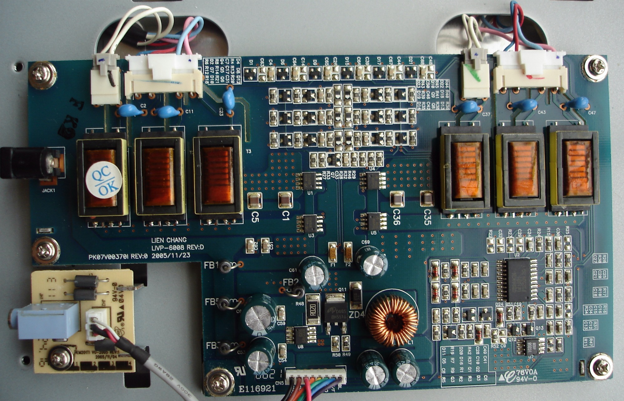

    Re: Planar PL2010M-BK -Black screen
    Check the fuse and transistors or mosfet in the inverter part of the board
    Also would help if you could post a few photo of all of your boards in this monitor

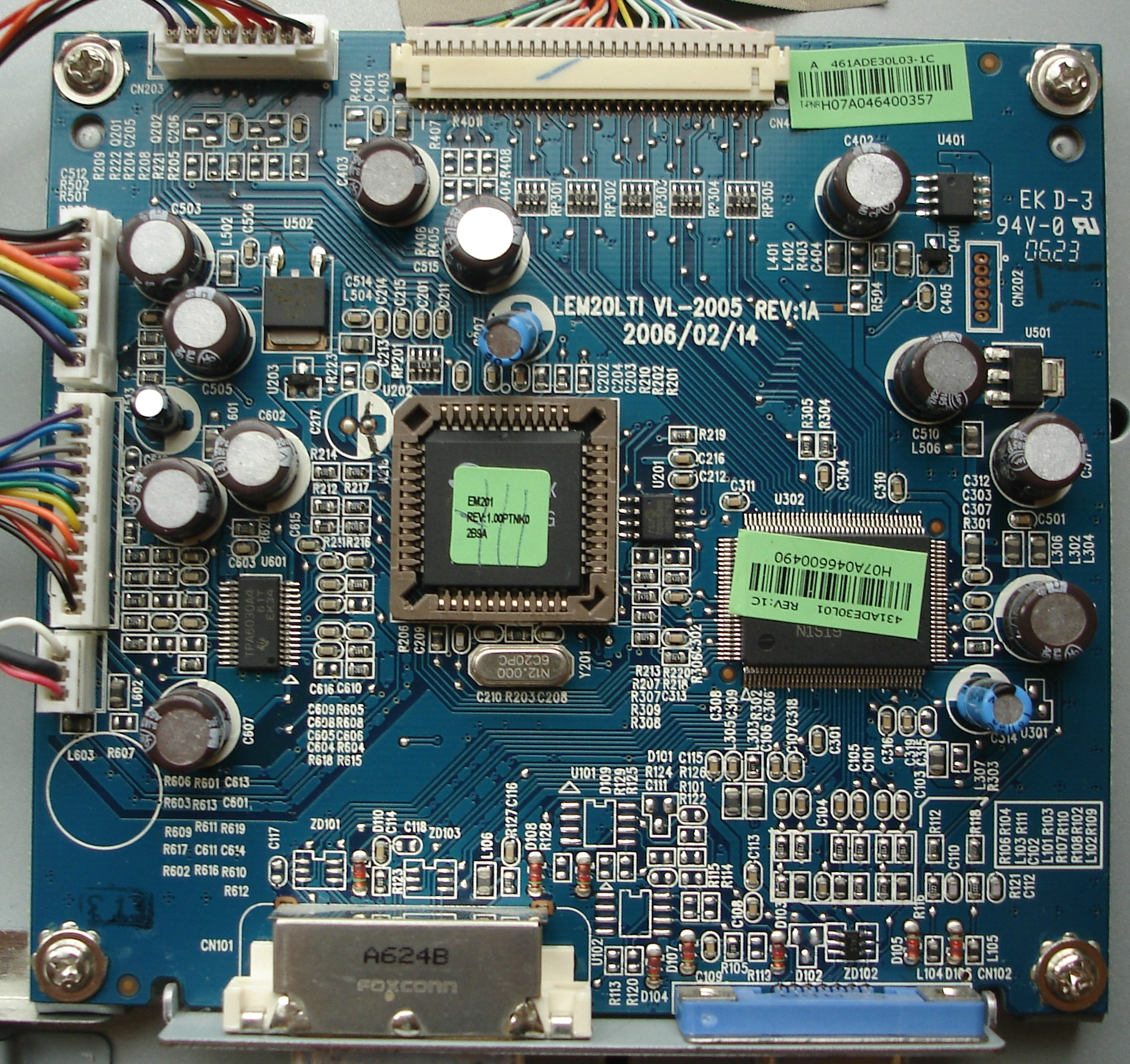

        Pictures attached.
            Also I tested all transformers. Result is OK.
            • jetadm123
              • 2169
              Did you try checking fuses F1 and F2 on the inverter board as samX3 suggested?
                Fuse F2 is open. Thanks.
                  Thanks a lo to all of you. It is working now.
