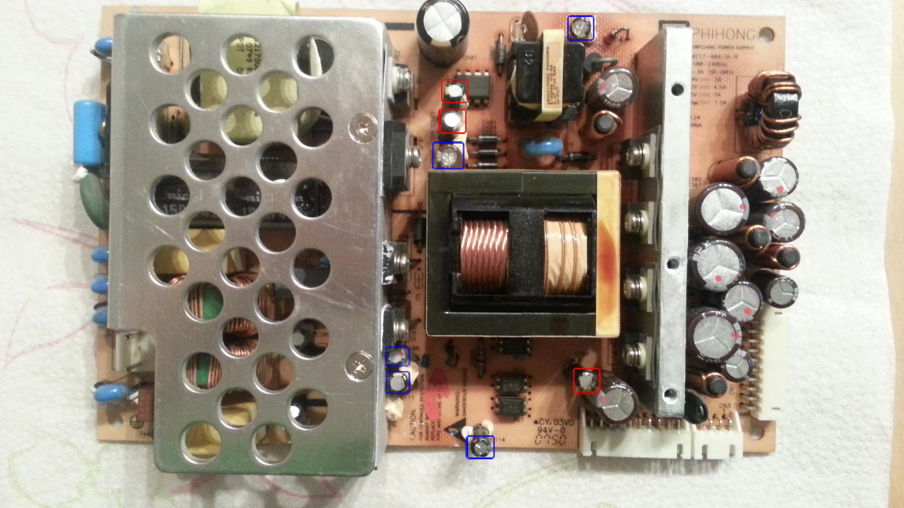

        same sort of Problem here with HD281D and PSM217, but there is no voltage on the Output rails, just 5V stand by (~5V, blue LED is on, react on power button, screen works with another power supply). All recapped, but the 400V parts (150muF and 22muF). Checked main capacitor (150muF), round 320V, soldered it out, 140muF, is that ok? Same on the 22muF cap, measured 20muF, both looking good.
        Any idea why it stays in standby?

          Can we good close up of the power supply board connectors? We are looking for the PS_ON signal to see if the signal (>2.75vdc) is present, also the voltage on that 450VDC main filter cap should go up to 380Vdc measure AT the two LEGS of the cap when power is switched on. Pictures of the main board also.
            Re: viewsonic vx2835wm no power
            thanks for your help. I soldered all back together and measured the given points. PSON is always 0, but blue LED react on power button... Voltage on main cap is 320V, after blue LED is on it drops to 319V, voltage is constant.

              OK ,the main board is not sending the PS_ON signal to turn on the power supply and the PFC Voltage booster circuit to boost it up to around 380~390VDC.
              We need to test the main board next.
                I thought the main board is ok, because if I replace the power supply with a compatible FSP217 (from another HG281D) it works. But when standby has 5V why there is no PS_ON? I think I get it. But why the blue LED reacts then and why ist goes in standby (blinking) after a while (think at the time where it shows the ‘no signal' screen). Oh, I didn't mention, there is no input connected while testing.
                      I might be able to save you some time here. That appears to be the same power supply used in the Hanns-G 28" monitor. Some of the smaller caps tend to dry out. I normally replace the 3 caps circled in red, and everything fires back up again. You could optionally replace the ones circled in blue, but they have always shown low esr for me; even after years of use. But the 3 in red definitely need to be replaced, and it will probably work.
                        #31
                        Hi Lumberjack777,
                        yes the power supply is from a HG281D. All caps are already replaced with Matsushita (Panasonic) 105°C LowESR types, seems you use the same, thanks for the pic. Just the two 400V are original, I tested them and they are ok. But maybe you can help me with the right sizes. I got the power supply with replaced caps and didn't check them, because I couldn't get a schematic for the board.
                        Input
                        C3 150muF/400V main cap (ori)
                        C203 2.2muF/50V
                        !C205 10muF/50V !1muF/50V
                        Middle
                        !C108 10muF/50V !22muF/50V
                        !C111 10muF/35V !22muF/50V
                        C114 2.2muF/50V
                        C403 470muF/35V
                        C406 10muF/50V
                        C601 22muF/400V (ori)
                        C603 22muF/35V
                        C606 1muF/100V
                        C605 47muF/50V
                        C701 1000muF/35V
                        C707 22muF/35V
                        Output
                        C301 1000muF/35V
                        C302 1000muF/35V
                        C306 470muF/35V
                        C401 1000muF/50V
                        C502 470muF/35V
                        !C505 470muF/35V !1000muF/10V
                        C506 470muF/35V
                        C702 (470muF/35V?)
                        Please check values of caps marked with !

                          after reading some more, I changed C111 to 22muF and C505 to 1000muF. C205 I replaced with 2.2muF, because I have no with 1muF in Stock. So far so god, it's not working at all, but the blue LED doesn't come up anymore... :-( Main Cap is on 318V, 5VSB is on 4.99V, PS_ON between 0.02 and 1.2V, there are 3.3V at power buton. Could the C205 make such a differents? Is C108 10 or 22muF? Any hints, any spots to measure? It has to be the powersupply!

                              yes thats right. I got the TFT with replaced caps, but it neither starts. So I took the power supply from another HG281D and it works! Put back the PSM217 and the Problems were back to. That is the reason why I wrote in this thread for the PSM217, also knowing it's ViewSonic related. Either at the Moment I havn't the caps for the main board. So first I want to concentrate on fixing the power supply.

                                  Ok badcapass: fortunately I did get an hg281d in the other day and I just opened it and its untouched
                                  The cap values you requested are.....
                                  C205 = 1uF 50v
                                  C108 = 10uF 35v
                                  C111 = 22uF 35v
                                  C505 = 1000uF 10v

                                      thanks for the input, that are the same values I have read across the net. I measured a voltage at main cap (C3) of 320V. Ordered the missing caps today, waiting to replace the last wrong part (C205 1muF). Hopefully it will change the situation.

                                        just replaced C205, but nothing changed. I ordered the caps for the main board to and since the blue LED doesn't react anymore I want to recap the mb as well. But as you know, I am not sure about the right dimension. They should fit, but...
