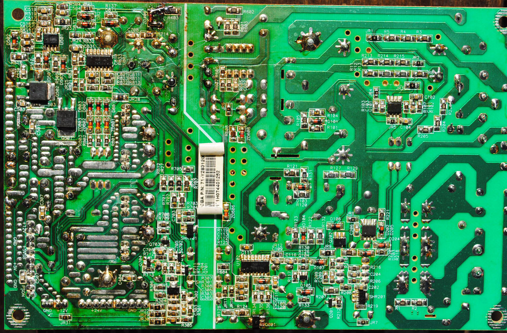

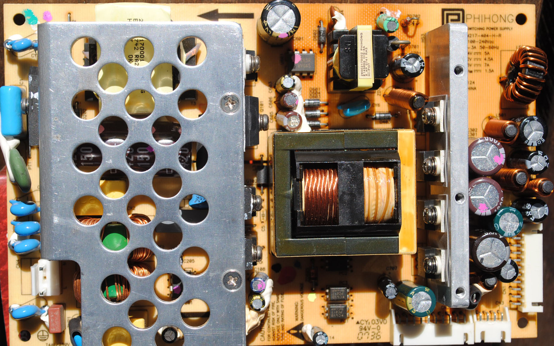

    This is my first post so I will try to give as much information as possible.
    I have a viewsonic vx2835wm with no power, no lights, nothing, it has a phihong psm217-404-h-r power board (seems to be the same as a hanns-g hg281d). I have replaced all of the secondary cap (two where swollen) but no change. I have a constant 338v across the main primary cap. With the controll board unplugged I get 5v at 5v rail but nothing else, with the control board connected I get 3.2-3.6v at the 5v rail 9-10v at the 12v rail & 21-23v at the 24v rail all fluctuating.
    not sure where to go from here

    The first thing I can think of is what brand and series of caps did you use as replacements?
    The second thing is there are a number of small (<100uF) caps on the primary side. Those should also be replaced.
    The third thing is - excellent pictures.
    And the last bit of advice - it's a minor problem when done the way you did it, but use 'Manage Attachments' below the text entry area to attach pictures.
    PlainBill

      thanks for the reply
      I've used a mixture of caps (all I can get from my local store) they are jamicon, suntan, samxon & ky they are all low esr 105 degree, I repair lots of smaller monitors & they have been ok in the past. I will try replacing all the small caps (but some may be a little harder to get, getting your hands on components in Australia is hard half the time I have to order them from the U.S or pay stupid prices from Australian distributors)

        G'day from the other side (I think) of Oz.
        I have used Hitano low-ESR 105C caps exclusively on SMPS servicing for years with no comebacks. I originally went with that brand as (a) they had (decent) published specs, and (b) were carried by a reputable wholesale/commercial supplier here in Perth (X-on). Depending where you are located, WES in Sydney or X-on and Worldwide in Perth. X-on are geared to commercial customers but WES and Worldwide will sell in one-offs.
        Whatever you do, don't let convenience cause you to use low-spec caps in a repair. Apart from the time and money you waste, it can mask the real fault.

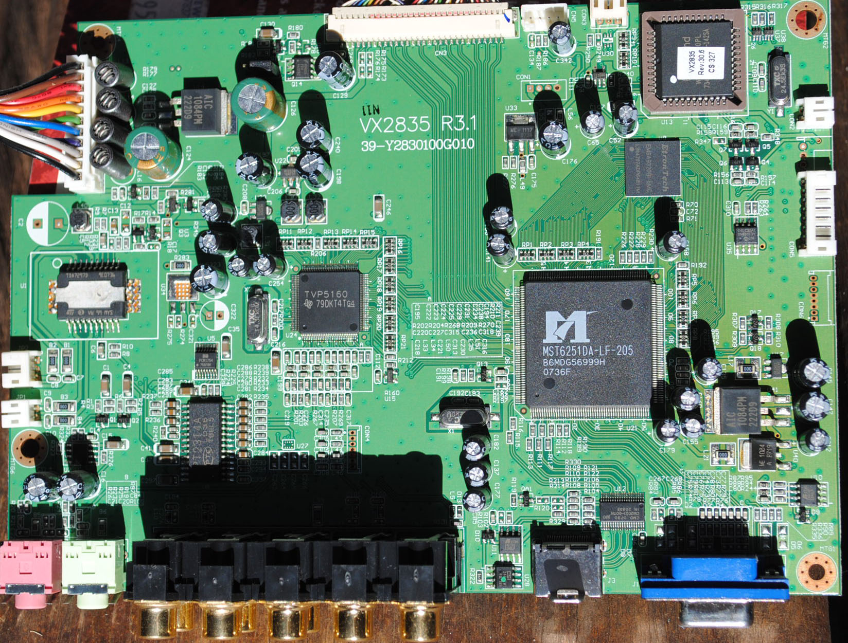

          It's probably a p/s. Sorry I have not been able to find a schematic.
          OTOH, replace the 2 caps on the Main board C124 & C126. They've been know to mushrrom.

                My VX2835wm just failed today with the same issue (won't start).
                I've ordered all the caps for the PSU. No bulging caps, but some discolored ones. I will change all of them and let you know if that solve the issue or not.
                Anyway, C124 and C126 on the video board are both mushroomed.
