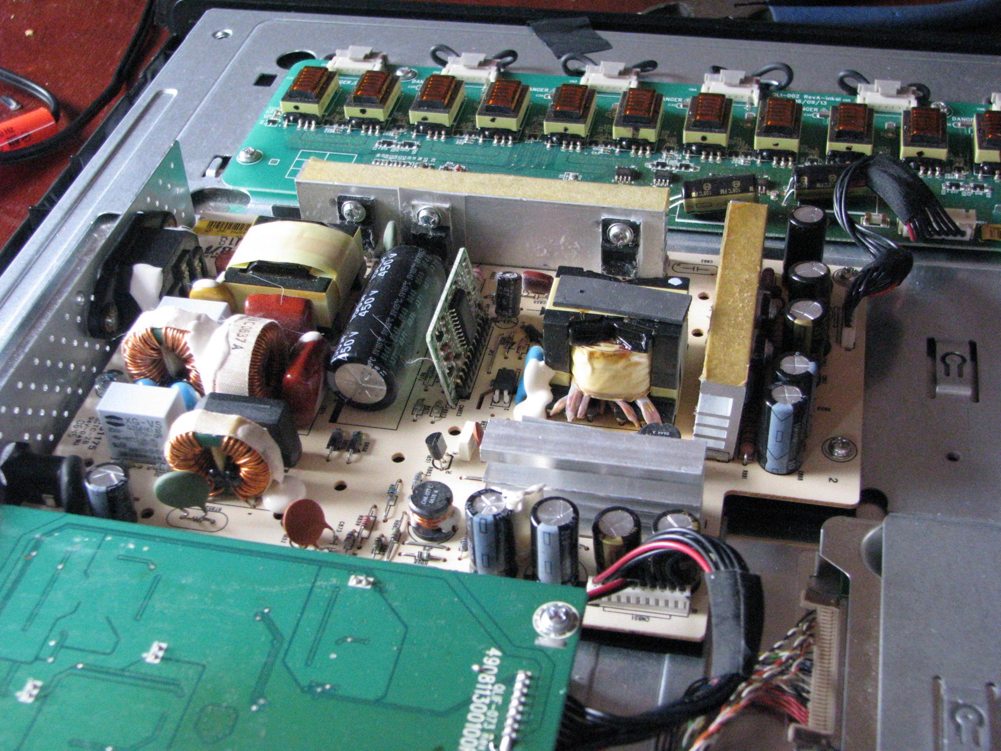

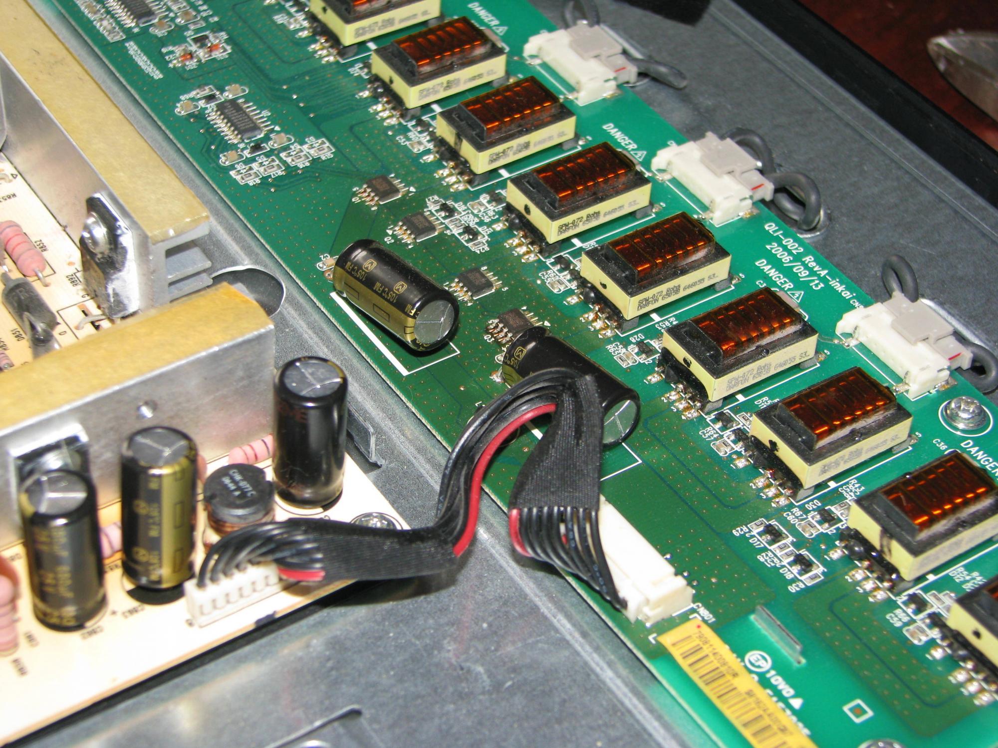

          Re: Gateway LP2407 / FPD2484 Replaced Power Caps and worked, 3 weeks later now it won
          Here's some pics
            There's a little Su'scon 47uF right in the middle of that photo, plus five unidentifiables that don't look like they've been replaced.
            With the power off and the probes on either side of the fuse, a good fuse will test as very low resistance, less than 1 ohm. A meter in continuity mode will beep.
              Originally posted by jsog
              With the power off and the probes on either side of the fuse, a good fuse will test as very low resistance, less than 1 ohm. .
              I suspect you will find F1 open,If it is open what are the part numbers on Q1 through Q4?
                @ jsog, the pictures linked are from another thread of the exact same monitor, not mines. I've replaced all the caps on the power supply including the 47uf with one from a repair kit.
                I touched 1 end with the negative terminal and the other end with the positive, after the lcd has sat disconnected for a few hours, the result is no voltage showing up at all.
                Unfortunately all I have is a rinky dink Cen-Tech 90899 that I borrowed from a friend, which looks really cheap.
                Q1-4 is 9985GM, 635102
