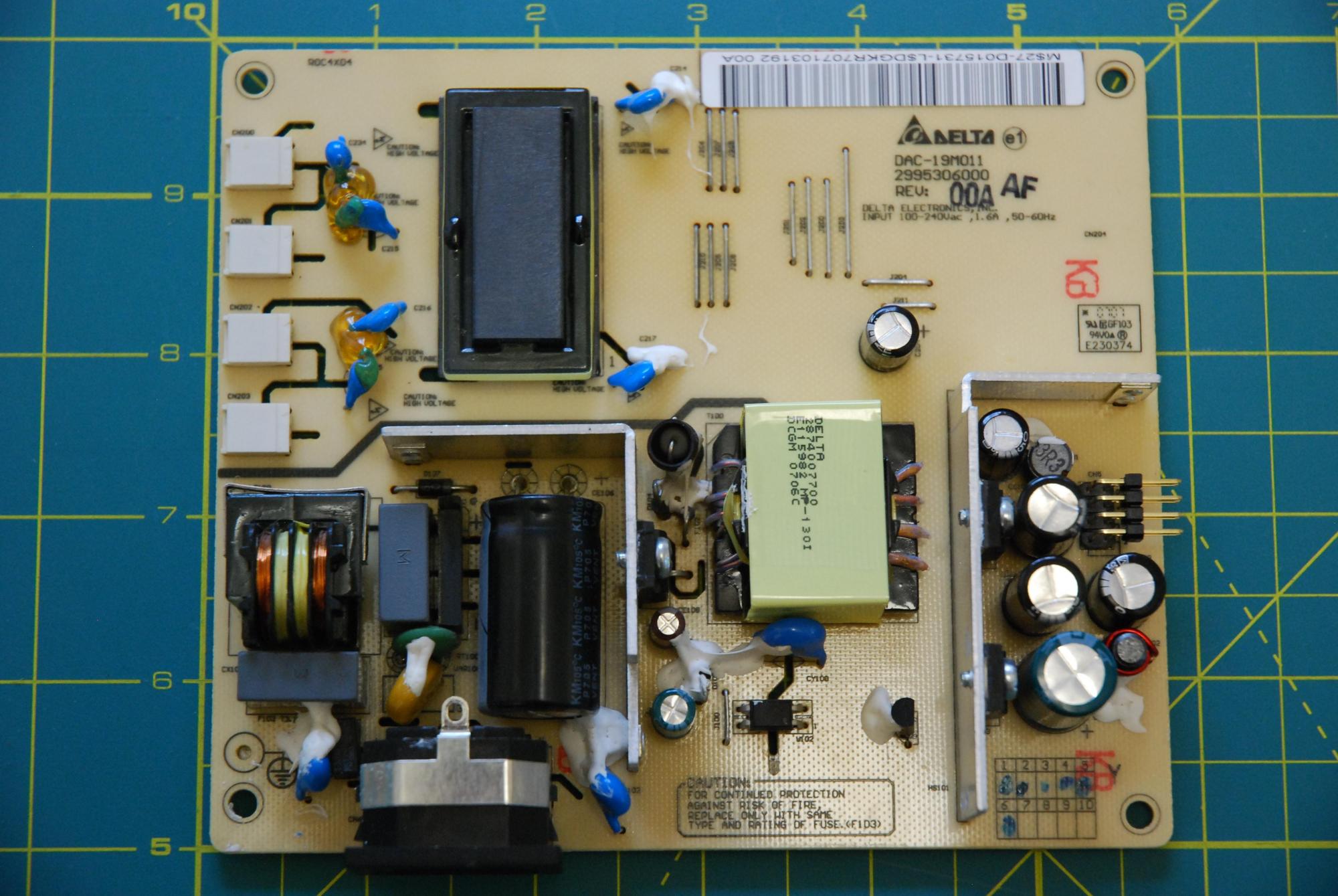

    Hi
    I just found this site and it looks to be a great resource for info about repairing lcd inverters. I'm hoping someone can help me out. I have a Viewsonic VX2255wmb LCD. The backlight is not working. I know the tubes are good because they light up fine with another inverter. I have replaced numerous caps already to no avail. What am I missing?
    I have replaced:
    2 25v 220uf these 2 were bulged
    2 25v 1000uf
    1 10v 1000uf
    I tested the small surface mount fuse and it looks to be ok. I also checked the two surface mount transistors on the back of the board for shorts but don't know what to look for beyond that. Any help would be great.
    Thanks!

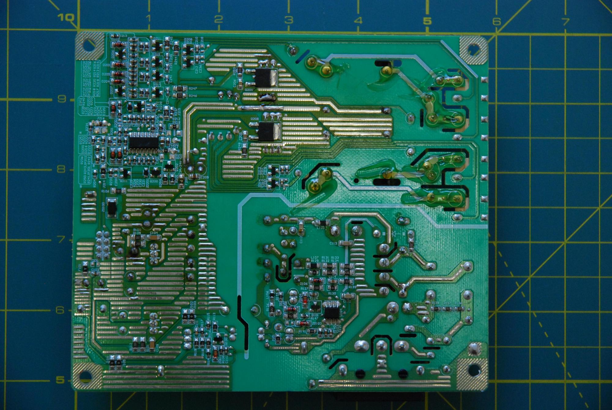

    Re: Viewsonic vx2255wmb inverter help
    I see 2 SMD fuses on the back of the board,F101 and F200
        Thanks for the quick reply. I didn't notice f200. I tested it, and it appears to be open. Would that be because of the blown caps earlier? I know it's not recommended, but can I bridge it for testing?

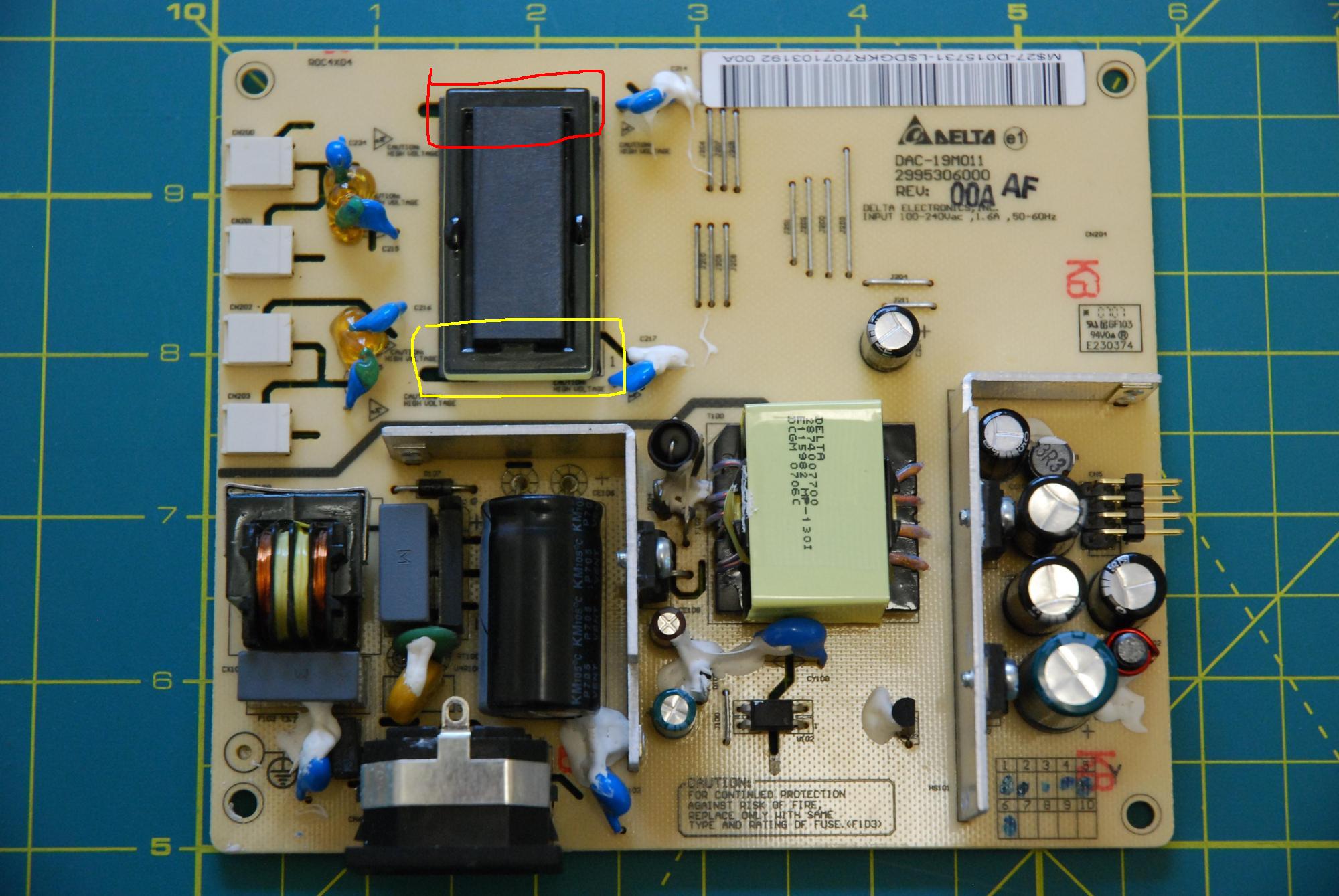

            Check the resistance between the 2 pins circled in red
            Do the same to the 2 circled in yellow and post result they should be within 3% of each other .
            I wouldnt recommend jumping a fuse
            • Snype32
              • Jun 2011
              • 76
              just checked pins indicated in pic...exactly the same.
                    Let me suggest one more thing and then I'll let you guys have it,
                    F200 looks like it feeds the inverter, what comes to mind is the two MOSFETs possibly shorted.
                          So I took the plunge and jumped the f200. It worked! Monitor now works perfectly. I do think that I should put a fuse in tho. Could I de-solder one from an old motherboard I have and use that? I don't know how I would figure out the rating on it. The one on the lcd just has P on it. the one on the motherboard has p 110 on it.
