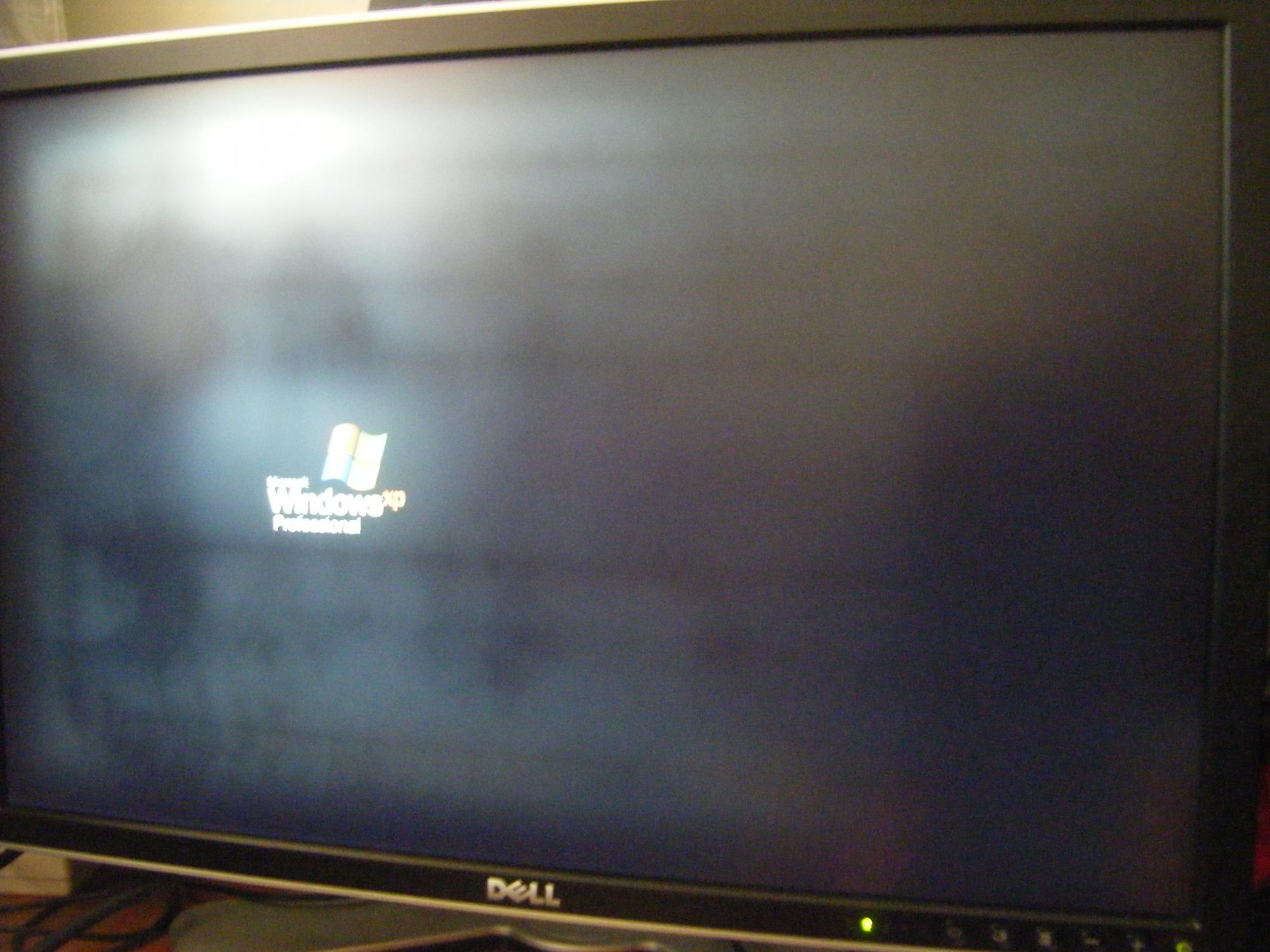

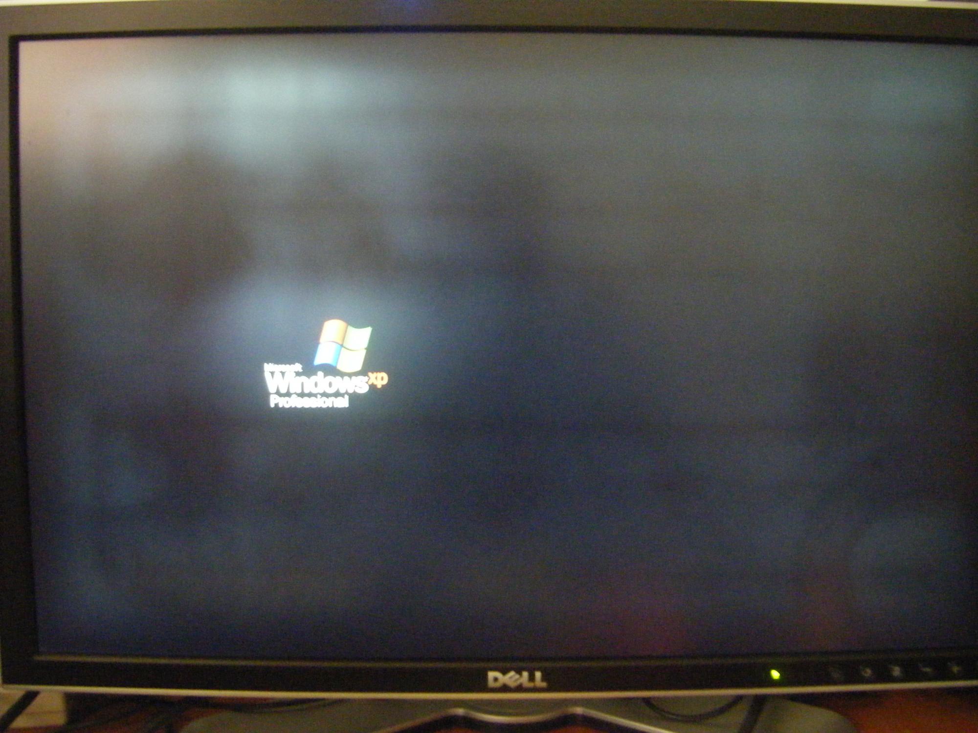

Congrats Tyan.. As for me, i managed to buy a used 20v 3.15A 60w power adaptor but seems like my screen is not performing as well as i hoped for.
jetadm123, i think my panel has massive 'white' patches on a black background instead of the black patches. When the screen is having white background & viewing directly straight at it there isn't any visual problem. But, when it is having black background & viewing at an angle, white patches are plastered all over the screen. I will try to take an image to show what i mean.
But, hey, i am not complaining. After months of troubleshooting, with the $$, sparks, fire, and fireworks it was just pure pleasure looking at the 'D...E...L...L' welcome screen with this modified version of the power adaptor. And I really have to thank AdrianM for it...

It is fine on a white background..
Just note, that my power adaptor connector is a bit loose so once in a while there will be blank/white screen. So you will need to adjust the connector as mentioned by AdrianM.. All the best to you!Comment
