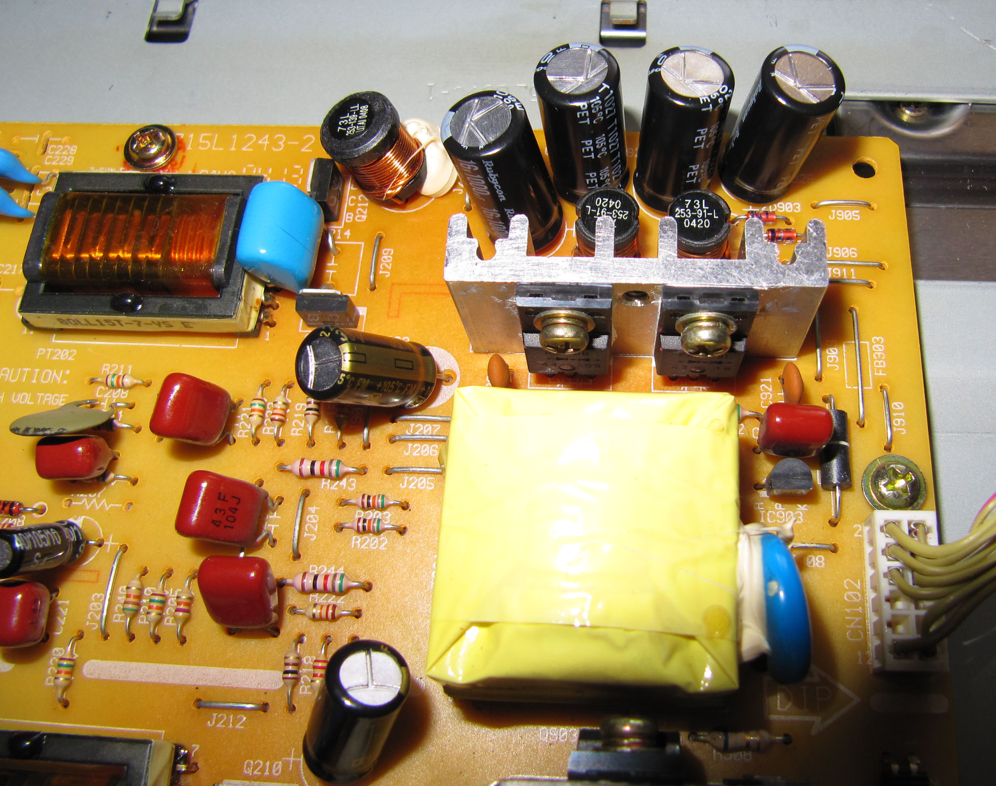

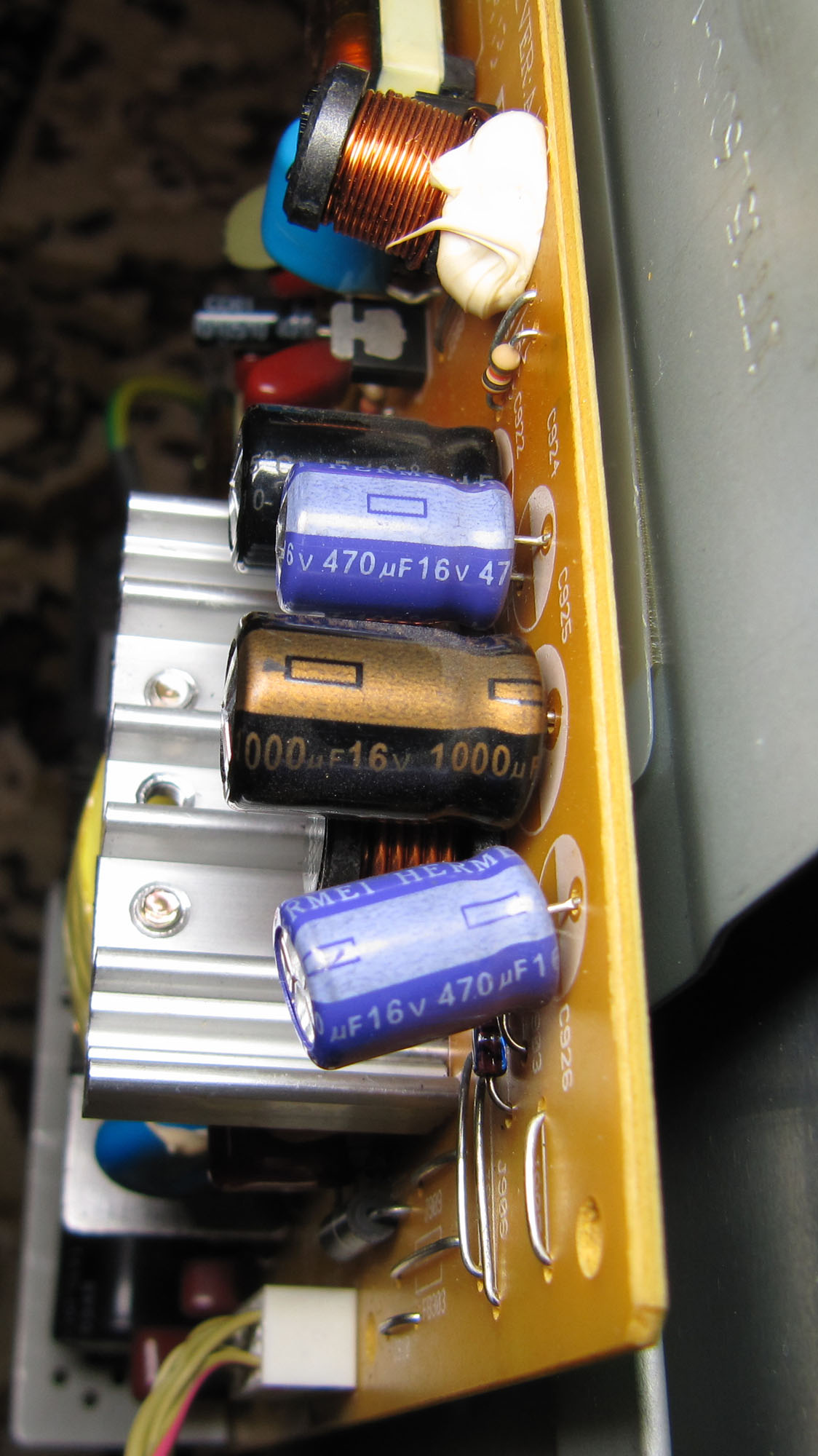

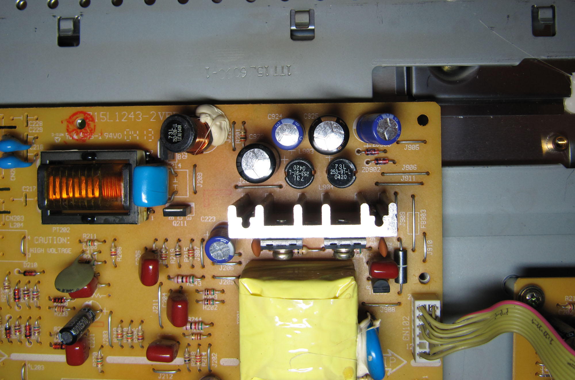

    As you can see there are 3 Hermei caps bad.
    I am wondering if the power supplies of TFT displays in general use same esr caps as computer power supplies.
    Then I suppose I could replace the 2x 1000uF 16V Hermei caps with 2x Rubycon YXF 1000uF 16V or Nichicon HD....
    And another thing that I need some help is about the 470uF 16V Hermei caps. Will it hurt if I replace them with 1000uF 16V ones?
    Thank you very much for your help

    I'd try to keep the replacement caps close to the original values.
    Perhaps Willawake can suggest a supplier in Greece.
    What's the symptom? That design looks vaguely familiar.
    I'd check the transistors in the inverter section for shorts.

      I haven't connected it on ac yet... I found it some hours ago.
      Can you show me the inverter section? I have no experience with tft...
        It is the left hand side of the power board where PT201 and PT202 sit. smason is probably talking about Q209 through Q212.
          There is no harm in doing that. There are filter caps and rising of capacity can't make trouble in this case.
            They do, more or less.
            The only difference is that the power supplies of LCD monitors don't have large toroidal coils on the output rails like PC PSUs do. Therefore, you can actually go with much lower ESR capacitors if needed. I still recommend staying close to the specs of the original capacitors, though. The only exception to this rule is if the original capacitors are rated for 85C - never put 85C caps in a LCD PSU because they just won't last very long.
            By the way, make sure to replace all of the caps, not just the few bad ones. The only cap you don't need to replace is the big 400v one on the primary side because those very rarely fail.

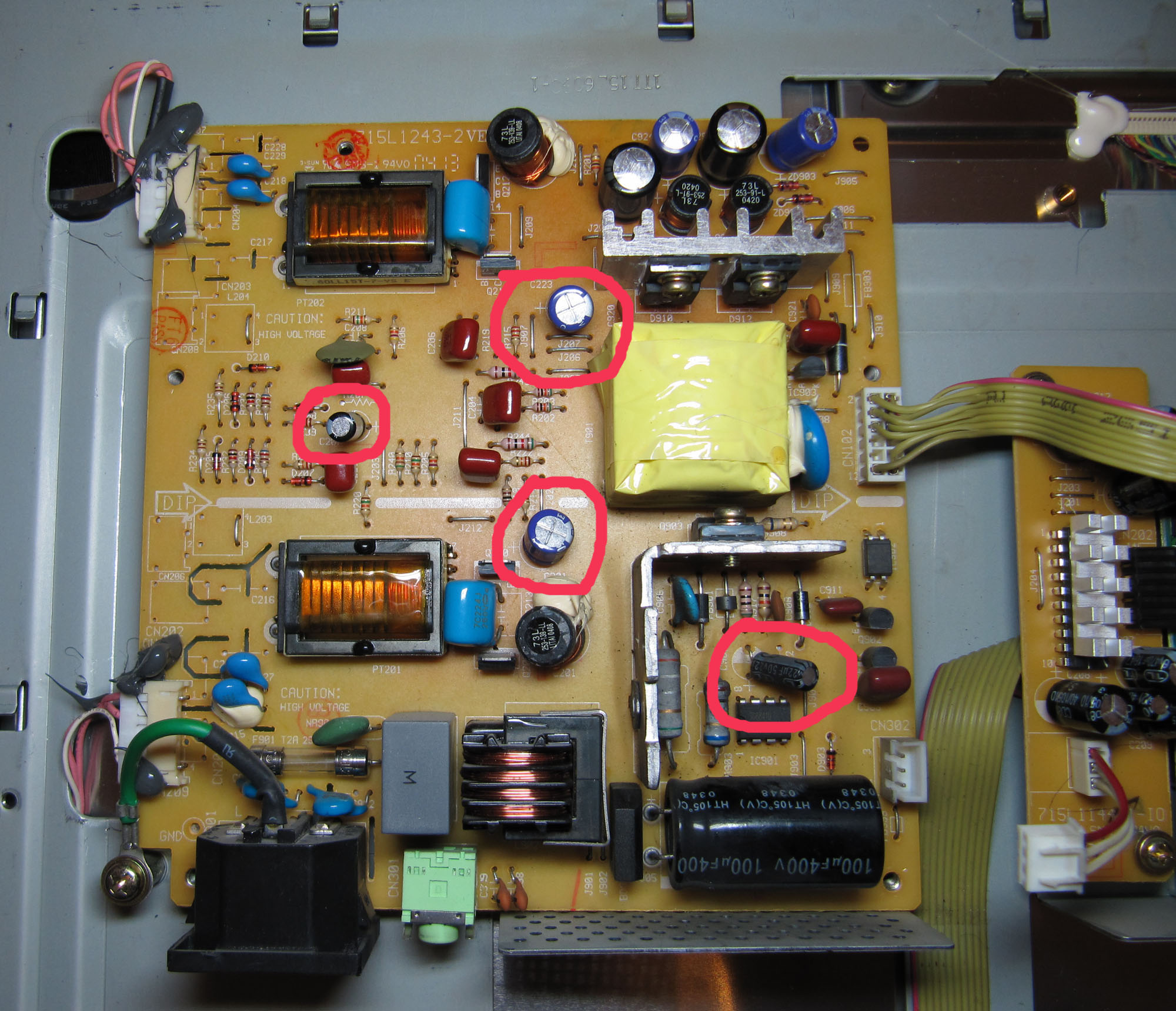

              Re: My first TFT repair - Nec LCD1703M
              I wish I could afford replacing all of the capacitors..
              Judging from the pcb discoloration, the 4 output caps are the ones that get very hot.
              Thank you for your help! I am waiting for replacement caps. I think I'll use Rubycon YXF 16V 1000uF.
                I guess I should have been more specific - replace all of the caps on the PSU only. There's actually only 3 more (1 is the small start-up cap, and the other 2 are the blue ones for the inverter).
                Yes, but the 2 blue ones in the middle of the board (extra filter caps for the inverter input) have also likely taken a beating after the 4 outputs caps failed since they are connected in parallel.
                  I see 4 extra caps....
                  Very useful info! What exactly an inverter does, how many volts it takes as an input and how many volts it outputs? Thanks!

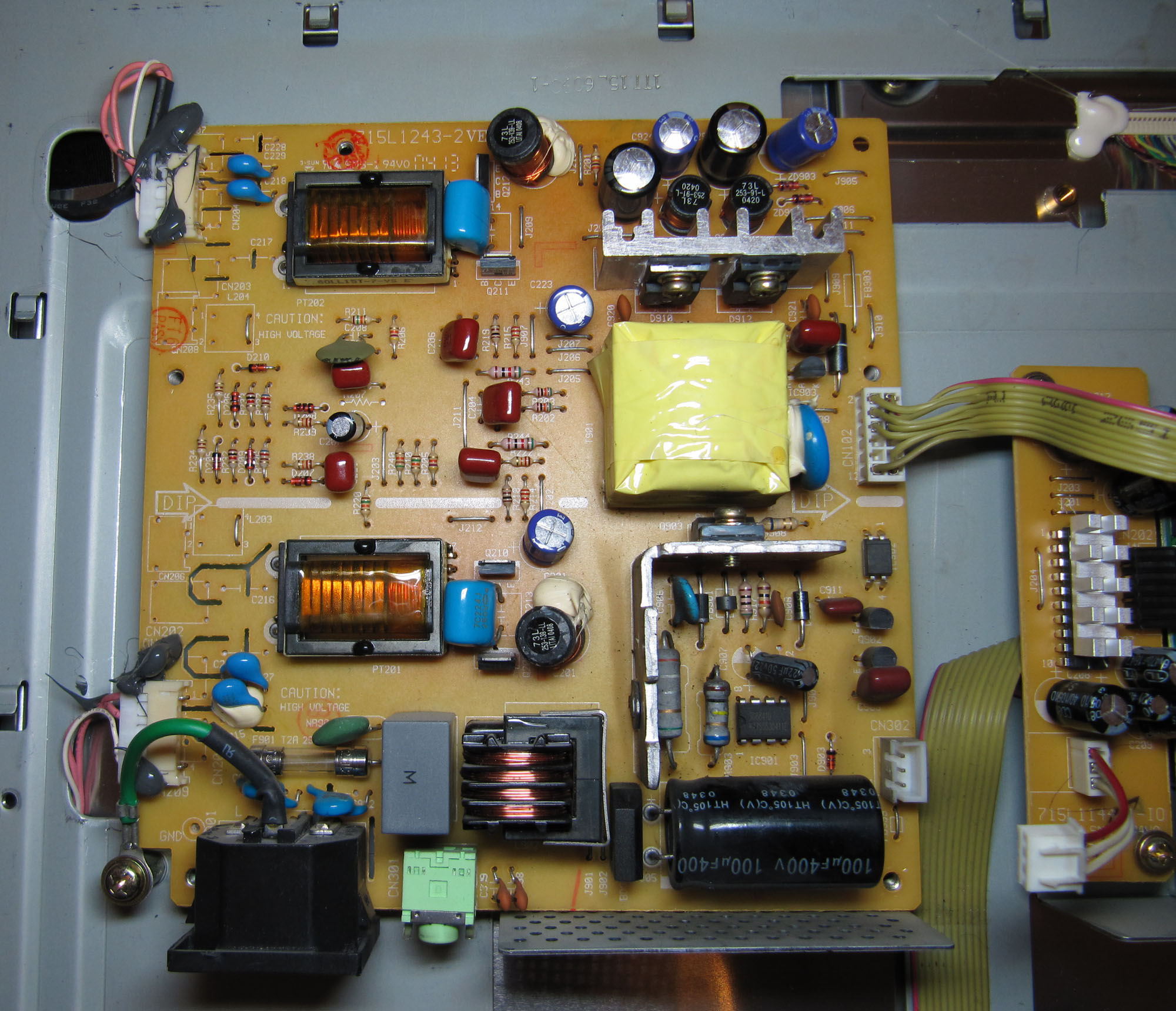

                          You can't be lucky every time...
                          I replaced 6 caps...
                          2xHermei 1000uF 16V LE (General Purpose Low ESR) -> 2xRubycon YXF 1000uF 16V
                          2xHermei 470uF 16V LT (Lower ESR) -> 2xRubycon YXF 1000uF 16V
                          2xHermei 150uF 25V LZ (Ultra Low ESR) -> 2x Panasonic FM 220uF 35V
                          ..only to find out that the lcd is broken
                          Anyway thanks for your help!
                          I consider it a training session for the next time.

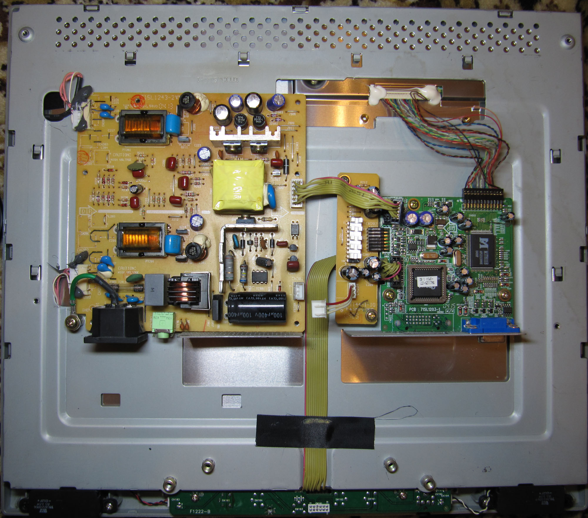

                              i'd still keep it. just wait for another 17" LCD with f*cked up electronics (like some of those Samsungs which always show "out of range" or something) and retrofit the panel into the NEC..
                              i did something like this a dozen times.. always worked fine if the resolution of both panels is the same..
                                Is that possible with Nec LCD1703M and Samsung Syncmaster 710V????
                                  i have replaced faulty screens with panels from othe rmakes and models with no problem,for example 17" to replace a 17" etc.It can be not a simple as that, but it is worth a try if you have a possible replacement,.
                                    And how you do it? Is there a step by step guide? I have no experience in this...
                                      Well, hopefully the whole panel ie the lights and screen are the same dimensions as the original, and the whole unit just replaced.
                                        This IBM L170 monitor was the panel donor that helped me bring this NEC TFT back to life
