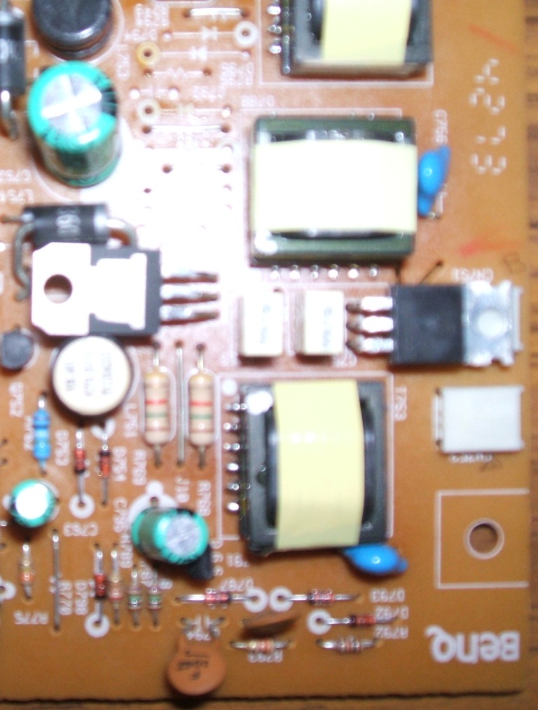

            Re: Dell E172fpb
            Originally posted by banjes
            Hi, thanks for your attentions and hereby I send the board of the picture and a detailed picture of the section with the faulty driver transistor.
            The TFT is a HP1940 and the board number 48.L1G02.A00
            There is a short on Q804 when I use my Digital Multitester. The short is between the upper middle leg and left under leg.
            (as my mother language is Dutch I hope you understand my English).
            It is on this side of the board where the 2sc5707 and FU9024N also were defect. I have replaced them allready but not tested the board because when I was measuring on the two FU9024N I founded difference. So I examined the board further and discoverd the defective Q804 but .... I do not have further information on Q804.
            Regards Frans
            I have a similar board, 48.L1G02.A01 and see some shorts in the C5707 chips and the STD10PF. Also a bottom side Diode, can't read it, D803 is shorted. I have not checked the transistors on the bottom side but I will after finding this thread. Did you have any more information on this board that would be helpful to me? I was just going to replace the whole Backlight Powersupply but I am not sure how to tie in the wiring of the inverter to this board.
            Has anyone wired in an off the shelf inverter?
            It is an HP1940 monitor with a BenQ assembly and a AUO display.
            Mark
              Re: Dell E172fpb
              I have found a pair of 2sd1691 transistors as the core voltage regulator on an old motherboard. I have installed these in place of the blown-up 2sc5707s and the monitor has been running for days now, as cool as can be. Before that I had tried many different types all of which overheated and either died or were shut down by the detection circuit. I think these might be a better choice than the 5707, at least as far as robustness goes. It is foolhardy to try to put something like a 3055 or a tip42 in this circuit as they are just not even remotely suitable. One of the most important requirements in this application is a low VCEsat which for the 2sd1691 is very low at about 0.1 volt. Also, the inverter runs at more than 100 kHz which means they have to switch very fast.
              Don't be looking for bad capacitors; that isn't the problem. This is not a motherboard. If you change the transistors and they get hot, you haven't fixed it. It will blow up again.
              Also, I have attached the circuit diagram for this unit which hasn't been marked up and is readable.
              For those who can't get the monitor apart, there are no screws other than those that hold on the foot. There are catches that just snap together. I slide my thumbnail along the crack on the sides and bottom to pop them open, but I have more heavy-duty fingernails than most. A screwdriver will do it, but you are likely to leave mangle-marks unless you are careful.

                                Re: Dell E172fpb
                                Also completed repair with TIP3055 (MJE3055) from Radio Shack. Replaced all four transistors Q739/Q740 Q759/Q760. Originally checked short at 759/760 (in cct) but upon removing Q760, found only it to be blown. Replacing singly did not help, replaced pair Q759/760 and OK. Replaced all 4 for insurance and reflowed all solder on transformers and transistors in inverter circuit. I used a dremel to cut open the area around just the outer two transistors about 15x30mm so no need to insulate. Checked heat after only a few minutes but OK, monitor burned in now for almost 24 hours. No idea what belw it, hopefully it was just cold joint somewhere or aging of the component based on the design but we'll see. I checked Q743/Q751 and all other components per UMD.
                                Anyway, a friend's monitor so for $7 a good repair and easy too. Great forum and posters, esp. Davmax and UMD_EE both provided great info and UMD pdf is invaluable for anyone attempting this repair, see link below
                                https://www.badcaps.net/forum/showpo...&postcount=120

                                      Re: Dell E172fpb
                                      Hi Guys,
                                      Ive just fixed FP767 which uses the same inverter board as E172fpb with MJE3055 as on the photo,so circuit board sits nicely inside the metal cover never had to cut holes or anything.
