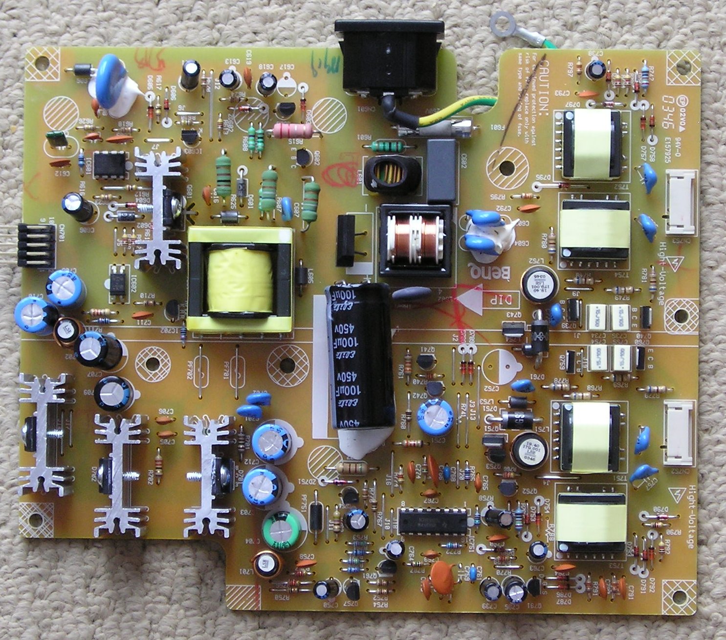

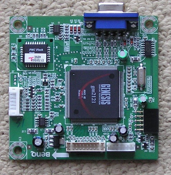

      Re: Dell E172fpb
      post a pic of the inverter and logic.

        Re: Dell E172fpb
        I have the same monitor for repair, pics as requested...

          Re: Dell E172fpb
          This board was a little bit confusing at first to determine which connectors are not at mains potential. CN701 (and CN753) are safe to measure, because there appears to be a blank area of PCB between it and the primary side.
          The first area to make measurements is CN701 (low voltage power supply). Also measure the output on diodes D751 and D761. Take care when measuring CN752 and CN753. You may need to measure voltage between each pin of these connectors, instead of GND.
          • Rainbow
            • Aug 2005
            • 1371
            Re: Dell E172fpb
            CN752 and CN753 are high-voltage supplies for backlight - I'd not mess with that. It either works (backlight lights) or not (backlight does not work but everything other does - if you light it up with something strong, you can see picture).

                Re: Dell E172fpb
                Symptoms...
                If the monitor is connected to a PC (in windows or whatever), when you first power it up, you get a very quick flash of the windows desktop on the display. The power LED then starts flashing at a rate of around 1 flash per second.
                I have taken voltage readings at CN701... Pins 9 & 10 pulse 3.3V, but as i'm using a Digital VM, it seems to fluctuate between 1.5 and 3.3V. Pins 7 & 8 pulse between approx 2 and 5.0V. Pins 3 - 6 are GND.
                If you listen closely to the board, you can hear a "tick" when it pulses... my hearing is not great, so i can't pinpoint where the "tick" is coming from...
                If anyone is interested, I've attached a pic of the under-side of the board.

                  Re: Dell E172fpb
                  The bottom of the PCB is discolored so it certainly runs hot. Maybe some of the caps are dried out. If they're crap brand, they can go fast.

                      Re: Dell E172fpb
                      the ticking suggests the pwm is starting and then hitting the overcurrent limit.
                      or lack of feedback from the opto causing same.
                      i would change out any caps in the darkened areas anyway.

                          Re: Dell E172fpb
                          Ok, on my board, the blue caps are brand new (maybe still crap, limited stockists nearby and not enough time to order over the net), labeled C751, C703, C712 C709, C707, C708 and C710.
                          D701 and D702 are UGF10DCT Diodes (with sinks).
                          Thanks for the link willawake... Looking at that, it looks like the same problem I have, so, does anyone know of a stockist in the UK that has some 2SC5707's (Edit: or equiv) (in lower quantities than 700)? Quick google didn't reveal much...

                            Re: Dell E172fpb
                            you should test them before ordering. guys please explain again how to test fets.
                            digikey will supply if rs/farnell/elfa dont have
                            better to recap also anyway for a final repair, it is not too many caps.

                                Re: Dell E172fpb
                                Thanks all for your help...
                                I tested the transistors Q759 and Q760 were shorted, I have swapped these, and the monitor now works great!
