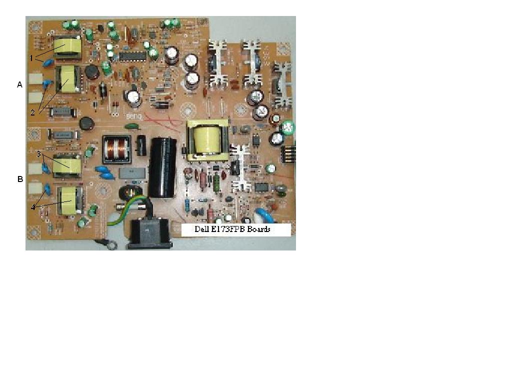

                                  Hi everybody, I'm new to this forum, and want to share my experience with the Dell E173FPb of my daughter.
                                  One day she call me, saying that the monitor has broken, the symptoms: no image, and blinking the power led. The monitor turns on, but the backlight goes off after one second. Pretty much like the symptoms everybody have.
                                  I search in the WEB, and found several entries about Dell E172FPb and E173FPb with similar symptoms, and take the decision to inspect inside, following this two links:
                                  and http://lcdpartsandrepair.com/E172fpbvideo.html
                                  Then disassemble transistors Q739, Q740, Q759, and Q760 and with the help of http://www.kpsec.freeuk.com/components/tran.htm test it, and found that one of them is in short.
                                  Test also the fuse BEL 3A ms 125v (PF751) but is O.K. and the two FU9024N who are very dificult to test. and decide to buy the set of:
                                  4 x 2sc5707
                                  2 x FU9024N
                                  1 x BEL 3A ms 125V
                                  from ebay, the seller "exxpressparts", in this link: http://shop.ebay.com/&_C5707+FUSE+FU9024N
                                  When the replacements parts arrive, I test the new parts and take note how the new transistors measure with the DDM.
                                  I change two C5707 (the pair who I look that one is in short), and test the monitor. And I have the same symptoms.
                                  Again disassemble the PCB, and test again the transistors C5707 and all are good, test the fuse PF751 and is blow, and one FU9024N is in short.
                                  I change the the fuse and the Fu9024N, and test the monitor, the test fail again, image 2 seconds, and black LCD, but the led power don't blink.
                                  Disassemble the PCB, and test again the transistors C5707 and all are good, test the fuse, is good, and the two FU9024N are good.
                                  Resolder the four high voltage transformers, and all that I can't see well weld. AND the SAME, after one second no image.
                                  Then I do the following tests: See attachement
                                  1.- I test the monitor disconnecting the wires to A conectors, the same, 1 second image.
                                  2.- Reconect A wires and disconect B wires, and I don't have the one second image.
                                  3.- Conect the A wires in B connectors, and have 1 second image
                                  4.- Conect the B wires in A connectors, and I don't have the one second image.
                                  The conclusions are: that both lamps are O.K., the problem is in the A part of the board, and B part is O.K.
                                  Then I decided to change the fault from A part to B part, changing the A parts components by the B parts components
                                  Then I number the inverter output transformers and the high voltage capacitors "27J 3KV" (1, 2, 3, and 4 ) and disassemble all of them.
                                  Mount the transformers and the capacitors in inverse order (4, 3, 2, and 1), trying to change the fault to the other side of the board.
                                  Test the monitor with these changes, and what is my surprise that the monitor works o.k.
                                  Conclusions:
                                  One of the solderings has a cold joint, that don't repaired when I resolder ¡¡¡¡¡¡¡¡¡¡¡¡¡ INCREDIBLE !!!!!!!!!!!!!!!
                                  The cold joint can blow up the transistors
                                  I hope that this append can help others that has the same problem.
                                  Best regards - Chema
