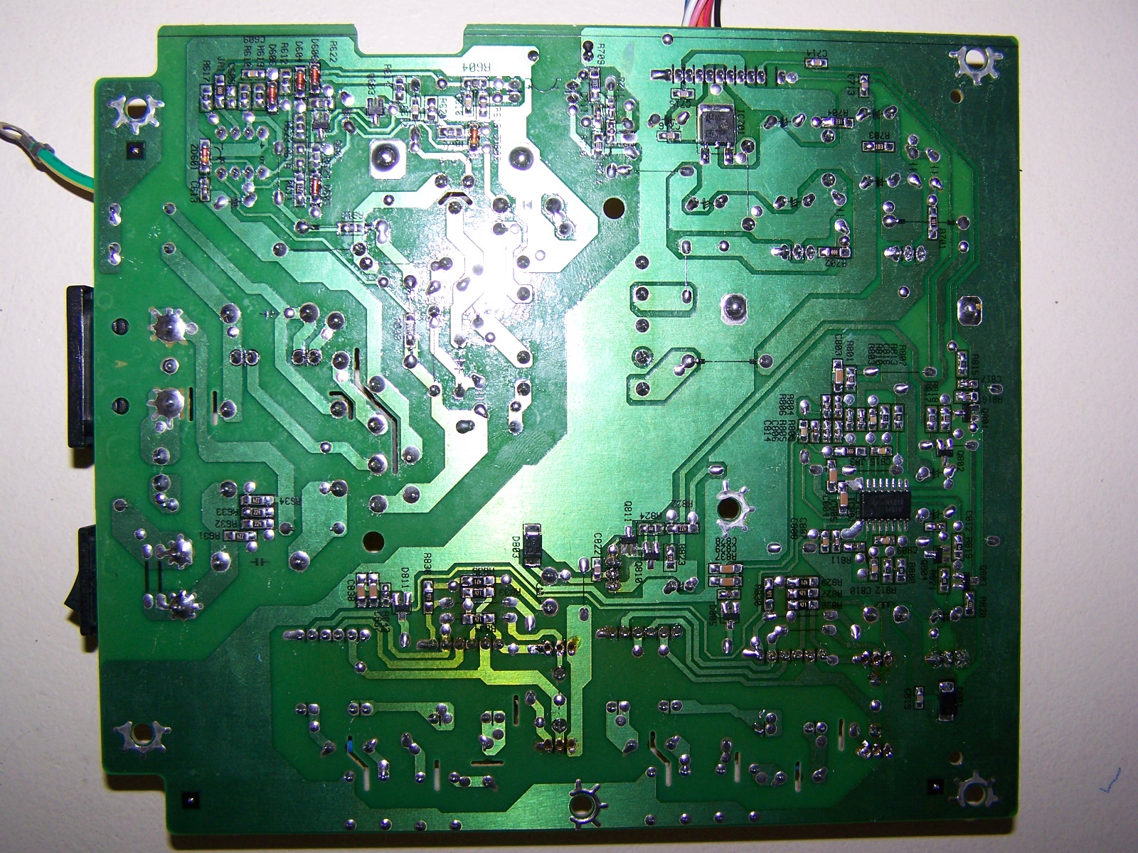

                  you can see on the bottom of the photo where i have removed the tranisitors(waiting with anticipation for replacements). hopefully the pic will give an understanding of how this inverter layout is! thanks guys for everthing and all the help!

                      Re: Dell E172fpb
                      Ah finally all is clear the board my monitor had is a revision (it had SMT FETS for the power off circuit) and yours is an older version (with through hole parts).
                      However I've found some things for you to check in the meantime.
                      First check both diodes under the board I circled them in Red (D803 and D801 I think I can't read the numbers that clearly on that one).
                      Their job is to protect the FET if they measure ok check on.
                      If you trace the lead leaving the diodes (not the ground lead which connects to the ground plane) they both will lead to a 3 pin FET. Measure from source to drain if you get a voltage drop you're fine.
                      Next if you wish you can measure the soft start transistors circled in red however they should be fine if the FET is ok.
                      The IRFU9024N is a MOSFET you can check it with the diode checker of your DMM.
                      Just measure from source to drain you should only measure a voltage drop in one direction. Just follow the pinouts on this datasheet its on page 8 or 9 depending on the type of package they used.
                      As for the TL1451A thats the PWM for the high voltage inverter that should be fine.

                        Just sitting here tracing out the board. Question-Shouldn't Q805(2sk2141) be the same as Q812(FU9024N) and shouldn't there be a left and right side inverter which should be the same?
                          The answer is yes in both cases. The 2SK2141 is a bad replacement for the FU9024N it has ten times the ON resistance, lower DC and peak currents, it is also a 600V device (this is unnecessary) the circuit operates at a nominal 15 volts.(FU9024N is 55V) Worst on all 2SK2141 is N channel, completely wrong the FU 9024N is P channel. REPLACE IT.
                          THIS DOES CONFIRM THAT THE CIRCUIT HAS BEEN REPAIRED BY SOMEONE NOT SKILLED.
                          Are you sure that we are discussing the MOSFET controlling one inverter? The one at top right in your photo.

                            Caution. Make sure the two controlling MOSFET circuits are identical and that the 2SK2141 does indeed switch a +15V or similar supply just like the FU9024N.

                              Let The Truth Be Known!! My Wife Took My Screen To A Repair Shop Whilst I Was Away On Business!! That Explains It All!!!!!!! It Didn't Make Sense Why Some Of The Components Are Different But The Circuits Are The Same! Now I Need To Find A Pair Of Fu9024n's Somewhere Online!! Q805 And Q812 Are Both Fed After The Diodes D801 And D803.

                                Seems like you are on the right track. The repair has been revealed!!!
                                The two diodes are connected in reverse across the 15V supply switched by each MOSFET ie they are on the output side of these transistors and conduct current only when each MOSFET switches OFF and energy is returned to the circuit by the small choke(inductance).

                                          Re: Dell E172fpb
                                          Hey Davmax you were right someone please slap that repair man for me .
                                          Rule one of electronics repair just because its working today doesn't mean that it will work tomorrow.
                                          Subbing a component improperly may allow the monitor to work for awhile but it will just fail again.
                                          Similar to replacing the vertical deflection IC in a monitor and not replacing the VCC resistor. It will just blow the IC again.
                                          It seems like the "repair man" cough just threw in whatever he had in his scrap box to get it working.
                                          If I can't find an exact component (and luckily I rarely need to do this) I painstakingly compare the datasheets of the old component with the possible new one BEFORE I ever solder anything.
