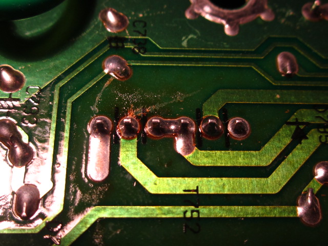

              Some great information and solid advice here. I have a Dell E172FBp that comes on for a short time, and then the backlight shuts down. Green power button remains illuminated. It’s a classic problem for this monitor judging by these threads.
              This one had been opened by the owner as they noticed something rattling inside the monitor when it stopped working. Something fell out when the covers were removed, but they did not believe it was part of the monitor! The 'thing' that fell out was actually
              Q739, a 2C5706... dead no doubt. Extreem example of dry joints! Evidence of heating on component side of PCB and the solder side has a number of dry joints on transformer pins and other transistors. Q739’s first cousin, Q740 was certainly dead short. Q759 and Q760 tested fine (diode checked out of circuit).
              So two 2SC5706 transistors on order! Fuse PF751 was good, and no problems with remaining transistors to my surprise. I have re-soldered all transformer connections. Checked capacitors around the board and all are good (used my trusty ESR meter).

                      One pair of transistors (2SC's) did the trick. Dry joints a major problem for this PCB. There were other components with dry joints not just the traffos. Well worth resoldering.

                          The "standard" advice for Benq boards is to resolder all the inverter transformer pins. It is rare the transformers are bad.
                          If you don't resolder, the board will fail again.

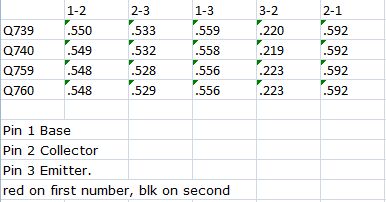

                                    Re: Dell E172fpb
                                    Weill I tested the four transistors as you suggested and my results are attached. I also did the ohm test on the lowest setting and I didn't get a reading on any of them in any position. I assume polarity doesn't matter with an ohm test, right? Nothing seemed out of ordinary, so I tried to just resolder the four transformers as everyone suggested. I decided to try it again in the monitor and it worked!!! We'll see how long it works for, but I have a feeling the issue may be (gulp) resolved. So I wanted to thank all the geniuses on this forum for their help!!
                                      Re: Dell E172fpb
                                      Lesson in dry joints!
                                      The Diode measurements illustrates the problem of interpreting with other components in circuit.
                                      Best diagnostic method is lowest ohms on a digital meter when in circuit. Out of circuit, diode check is useful, identfication of the base, forward drop etc. Polarity can impact, good to always check both ways.
                                      Finally, you might want to consider replacing capacitors as these can be the cause of running hot! I tend to replace caps when they fail specification and always check all of them with an ESR meter.
