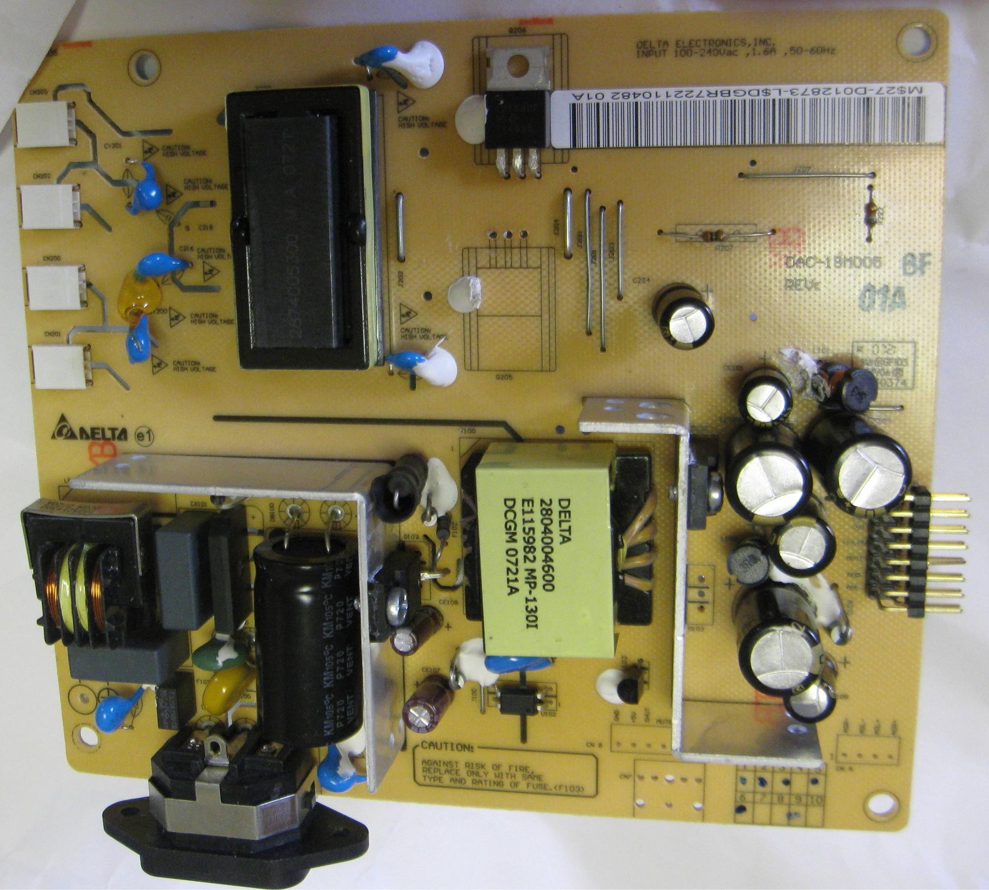

              One request, could you post photos of your board.
              Some questions, when you checked the bridge rectifier did you remove it from the circuit?
              There is another fuse you did not mention, it is F102 it is by the SMPS coil close to Q102.

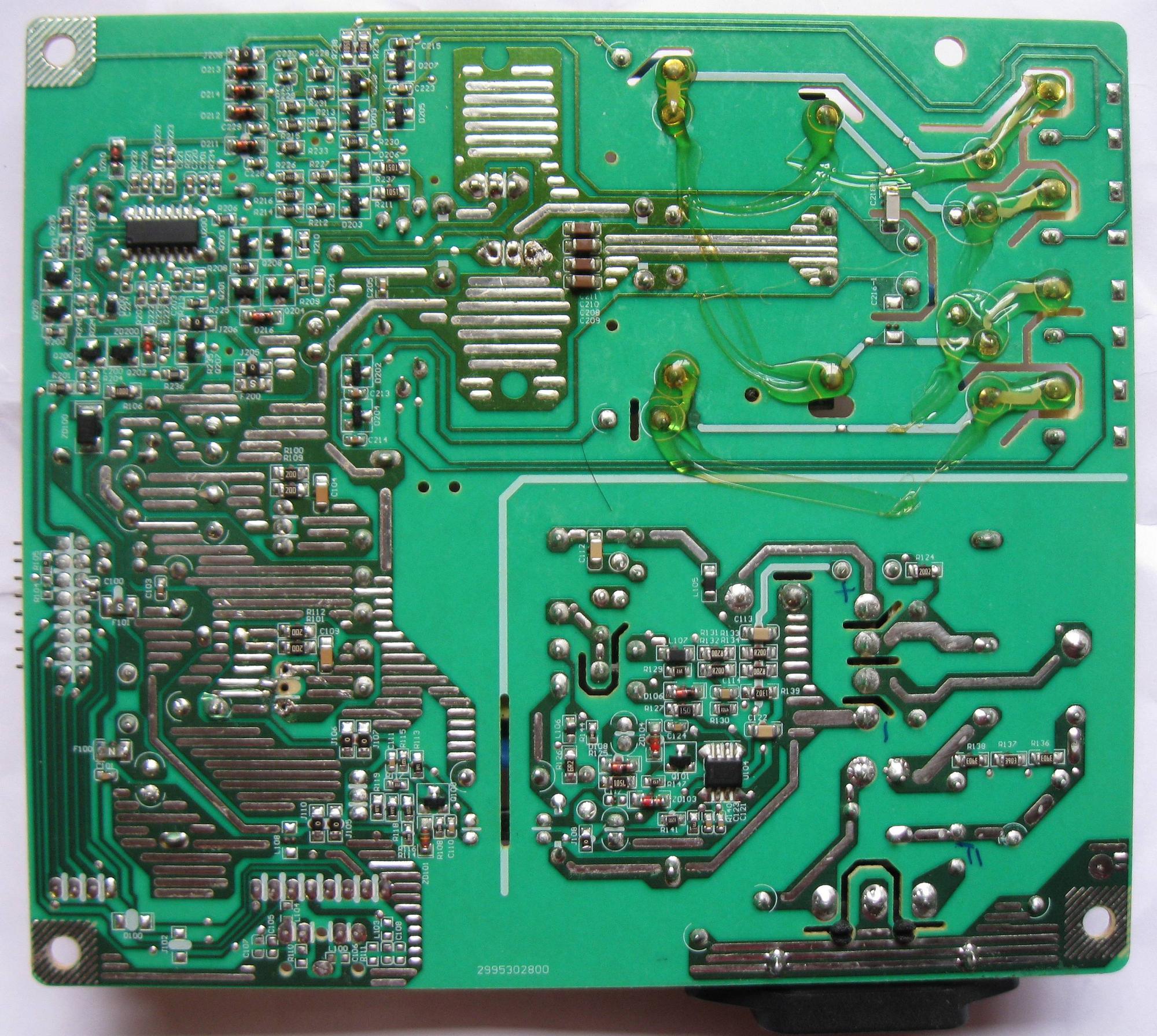

                Note the links in my signature. Pictures of the power supply board, top and bottom. Also, the part number of the SMPS controller.

                      Also for that F102 fuse you asked about, would you please check my pics and point it out...can't seem to find it on my 19M005 board. Thank You !
                        look right next to the center leg of Q102
                        Al

                          Thanks Al, F102 looks like a resistor in my Ver 01A! It measures about 100 ohms...but I can't tell
                          the band colors, do you know the spec ?
                          Did you happen to have found a schematic of this board ?

                            I scraped some of the white glue away, the board is marked F102.The component is gray in color with some different colored bans on it.
                            I guess the board could be mismarked or could this be a fuse resistor?

                              Has 5 bands but the 5th band is black....so I'm guessing a fuse resistor...I think its orange, black, orange w/ gold....but it could be red, green, red ...either way its way more than 100 ohms.
                              What does yours measure ?

                                      I have a good Delta DAC-12m033 board. It has the same gray component next to Q102 it is
                                      Orange- black- orange-gold-black assuming my eyes are correct in the colors and its measuring 98.2 ohms.
