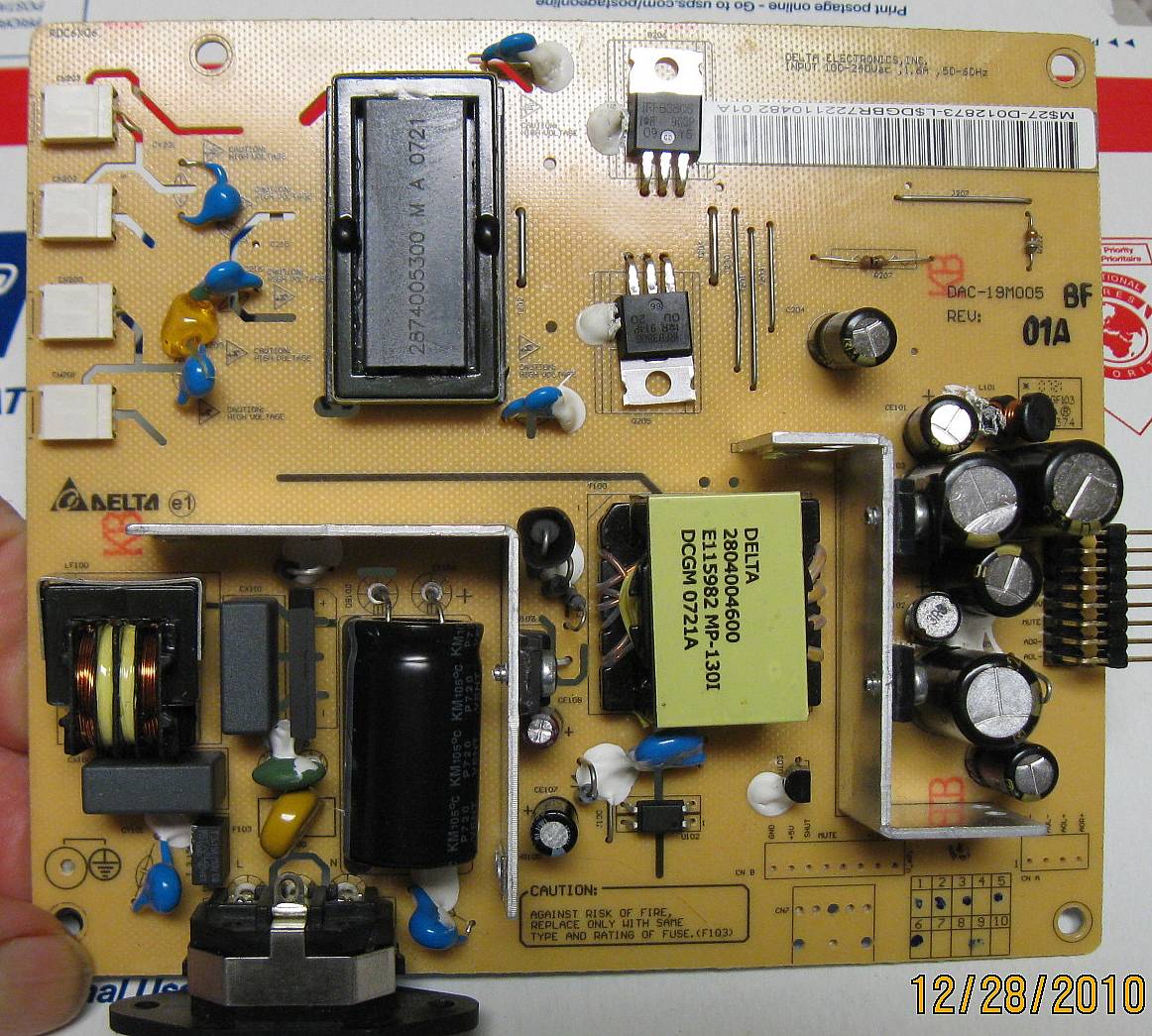

      On that F102, now that I've used another light I think we can agree its a resistor banded orange- black- orange- w/gold, value = 30k ohms. Since both or ours only reads about 100 ohms, does your unit work?
      I will be ordering the 1/2w size from Digikey: P30KBBCT-ND....its like 14 cents.

            Re: that F102 resistor fuse
            Retired...
            Finally dawned on me when I measured that same resistor on a Westinghouse LCM 19v7 I'm fixing and got 100 ohms...that's three in a row the same value.
            Looking at both of mine again I realized our 'orange' is actually brown, which means brown black brown gold is 100 ohms, and all of our F102 'fuses' are good.
            Must be my eyes, or the "Holidays".
            Cheers guys !

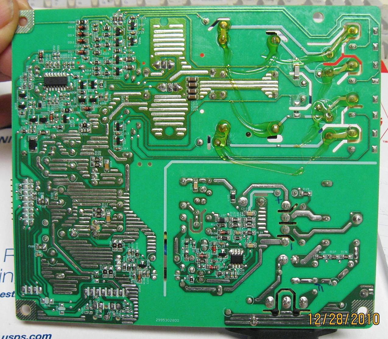

                Re: Fixing a DAC-19M005 Power Supply - new pics
                Here's the new pics after the restoration attempt

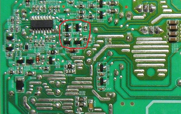

                      Definitely check the ccfls and the inverter transformers as retiredcaps and Rtech, suggested.
                      Check out post # 299 of this thread. https://www.badcaps.net/forum/showth...1975nw&page=15
                      I wouldn’t think you f200 would be faulty because you’re seeing a flash of the back lamps, but transistors can fail in other ways besides a short.
                      the area I have circled is the area that I think Kahless was talking about.
                      Personally I don’t have any experience of these failing, It’s just something I have read

                                  Al....> If you look back to my thread opening pic at post #10, it shows that CE 109 as the 'big' mistake I made when I first tried re-capping. This now is months later and my pic at post #27 shows the correctly installed new cap.
