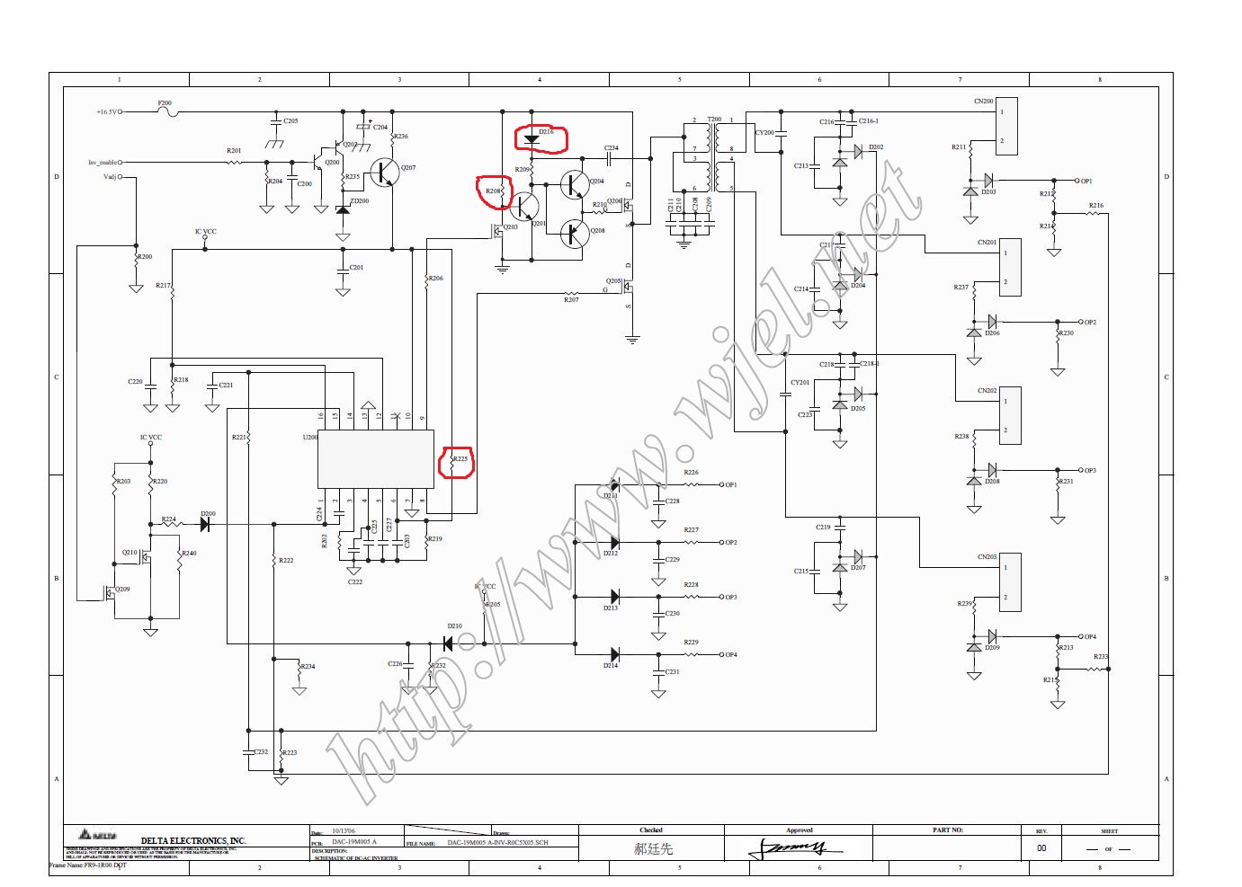

      Iยดm glad to hear about it. I hope this schematics help you guys (and me too) understanding and fixing this faulty boards.
      Thanks.

        Here's where I'm at.
        Before the schematic was available, I removed the controller to see if the pad of pin 13 that was going to ground or there was a problem with the controller. After I looked at the schematic it obvious that pin 13 is tied to ground. I substituted another controller when I reinstalled it. There was no change the power supply would still shut down.
        I have tried to separate the circuit to see if I could get an idea on an area to concentrate on.
        Removing resistor R206 that is tied to pin 9 of the controller made no difference, The PS shut down.
        Next I removed R208 and D216 from circuit at that time the 5v and 13v does not shut down.
        I have checked all the Q items and d216 for a shorted condition and I am not finding any.
        Any ideas on thing to do or check next?

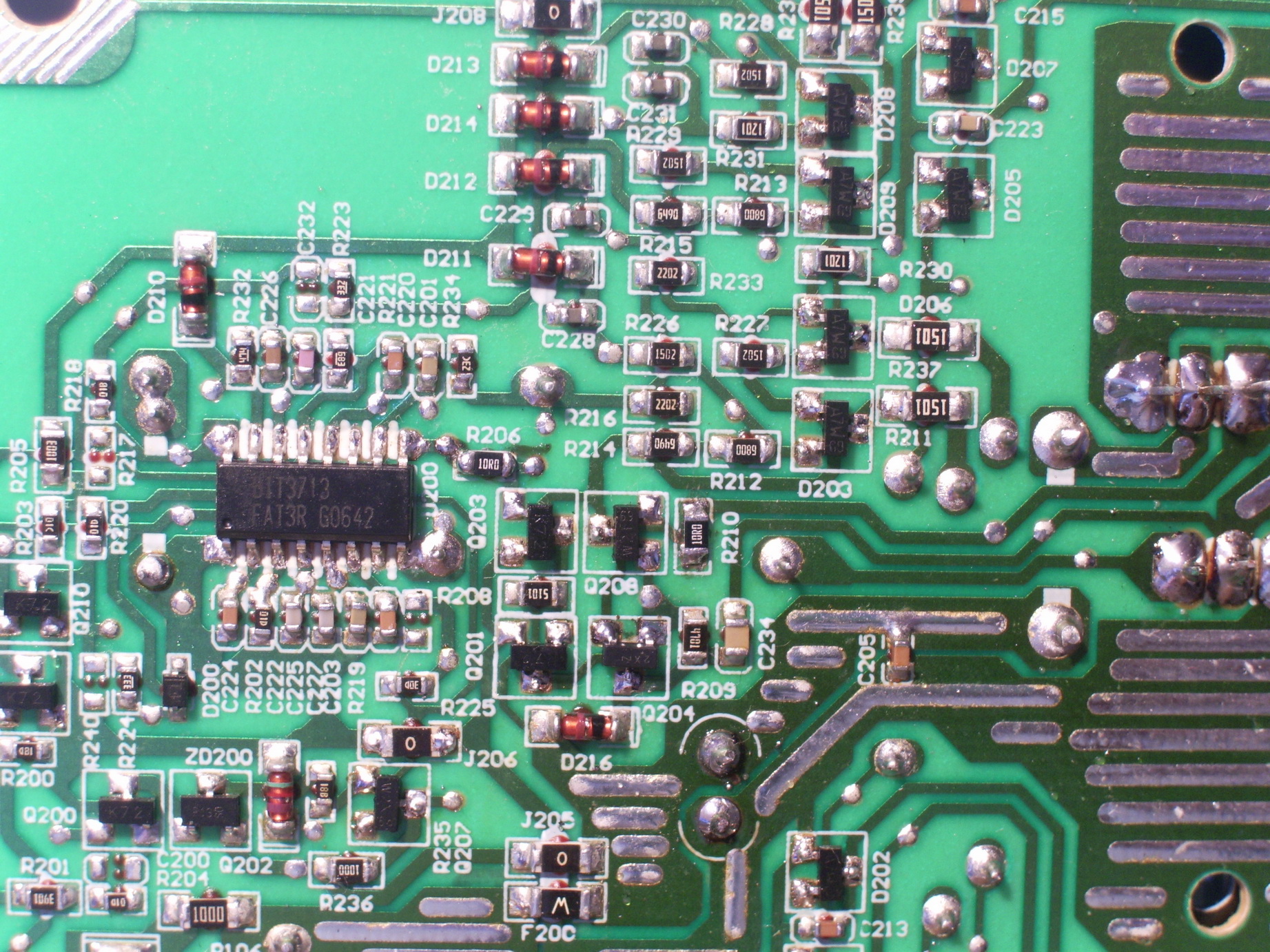

          Iยดm having same experience. Recapped all the caps, changed Q206 and Q205, replaced F200 (although it was ok. I did it a continuity test. Why you guys do a GND-ONE TO OTHER SIDE test?) Replaced Q204 (it was burnt), Q208 (Not neccesary but I ordered them too), R210 and R206 (they were ok too)
          All fuses seem to be ok (continuity test), I have 5V and 13,8 V at logic board connector (CN5).
          All jumpers ( 0 SMD) are ok.
          And I get video but no backlights,when I turn it on, backlights are flashing for a while (less than 1 second) and thatยดs all.They keep on flashing from time to time, when I press any key on the frontal pannel.I have green and orange led working too.
          I can hardly see the Menu Screen when pressing the Menu key, but thatยดs all.
          I want to test pin 9 of the U200 and see what vcc is on it, but I need to dissambling the 2 boards and turn them back to do it ( or solder an little wire on that pin).
          Should I test all the Diodes (Q201,Q203,Q204 and Q208)and resistences close to the 4 transistors?
          Any idea?
          By the way,sorry for my English if I made mistakes.

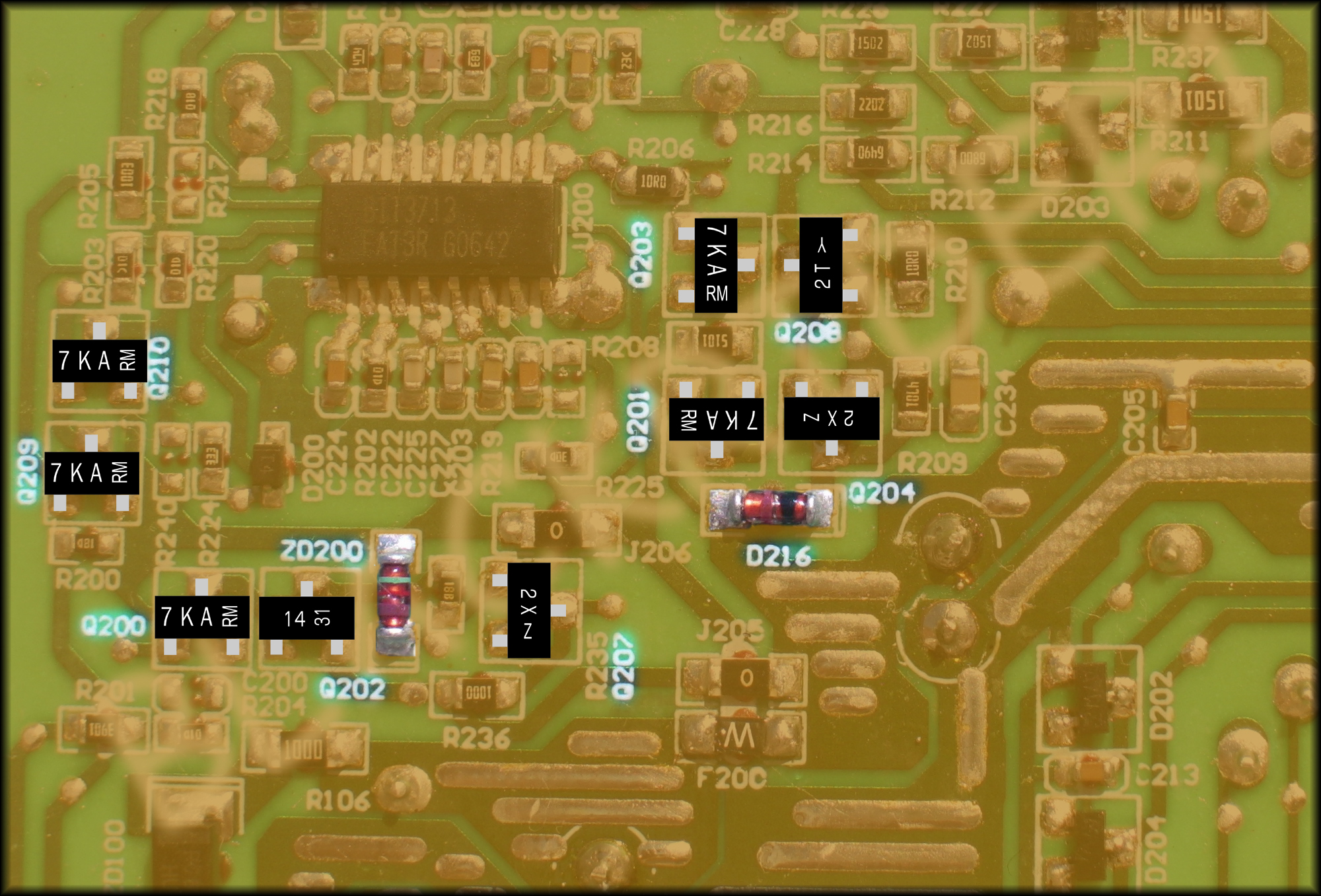

                          The very common failures of this board were capacitors, 2 Mosfets on the front of the board and the inverter fuse. Have you done anything with those?

                            Yes (#84):
                            "Recapped all the caps, changed Q206 and Q205, replaced F200 (although it was ok. I did it a continuity test. Why you guys do a GND-ONE TO OTHER SIDE test?) Replaced Q204 (it was burnt), Q208 (Not neccesary but I ordered them too), R210 and R206 (they were ok too)
                            All jumpers ( 0 SMD) are ok. "
                            Thatยดs all Iยดve changed.
                            Remember that my board hadnยดt any blown fuse, just Q204 lokked like burnt.

                              #94
                              Re: Fixing a DAC-19M005 Power Supply - check my DX:
                              Well, finally I got it working. According to the DAC-19M005 datasheet, I decided to follow the line from 16,5 V to the backlights transformer (from F200 ahead), and replaced Q204 (it was burnt, as you can see in the first picture),Q201,Q203 and Q208 ( Q203 and Q208 were okay but I replaced them too).
                              And Q200,Q202 ,ZD200 (weird meassures when testing),Q207 and D216 (They were okay too).
                              And finally, not necccesary but I did it, Q209 and Q210.
                              And now, itยดs working.

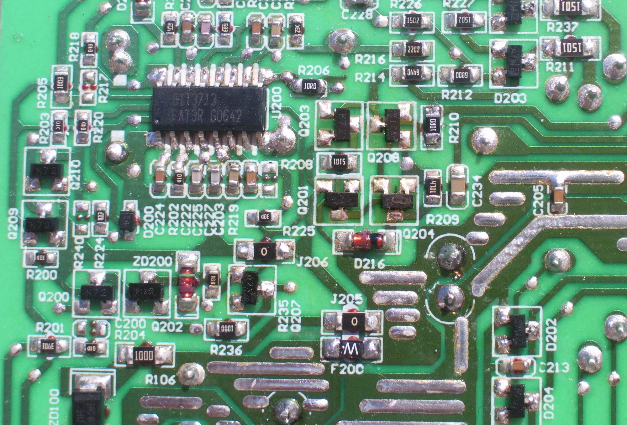

                                I have success to report also. I replaced Q201 Q203 Q204 and Q208,And this solved the problem.
                                None of these components Showed up as a short when they were tested.
                                I'm definitely not to try to analyze the inverter circuit, but I am wondering if one of the transistors or FETs was holding the circuit on to long causing a problem.
                                Thanks blackrider 1 for the schematic it did help me to find a problem area.

                                  Good work! I suspect you tested Q201,03,04 and 08 while they were still in circuit? It would be interesting to see how they test out of circuit.

                                    Iยดm glad to ear you fixed it too. I got different datas when testing the new ones out of the PCB and when they were soldered to it. Thatยดs because I replaced components that seems to be ok. I had them, so, why not?
                                    Iยดm sure that one ( or more) of the last I replaced was causing the problem. I kept them, so, Iยดll try to test them and find out wich one is wrong.

                                      Yes I did measure these when they were in circuit, when I removed them from the board I used a pair of side cutters to cut the leads so there is no way I can measure now.
                                      I wonder if this inverter circuit is similar to the royal oscillator we see in some of the Dells, and one half of it was staying on to long causing excessive amperage?
                                      Maybe if PlainBill has some time he could give some idea what may have happened.

                                        I'll have to look into it further, but at first glance it's not a Royer oscillator. At first guess, I'd suspect some sort of parasitic oscillations that weren't damped because the filter caps were bad.
