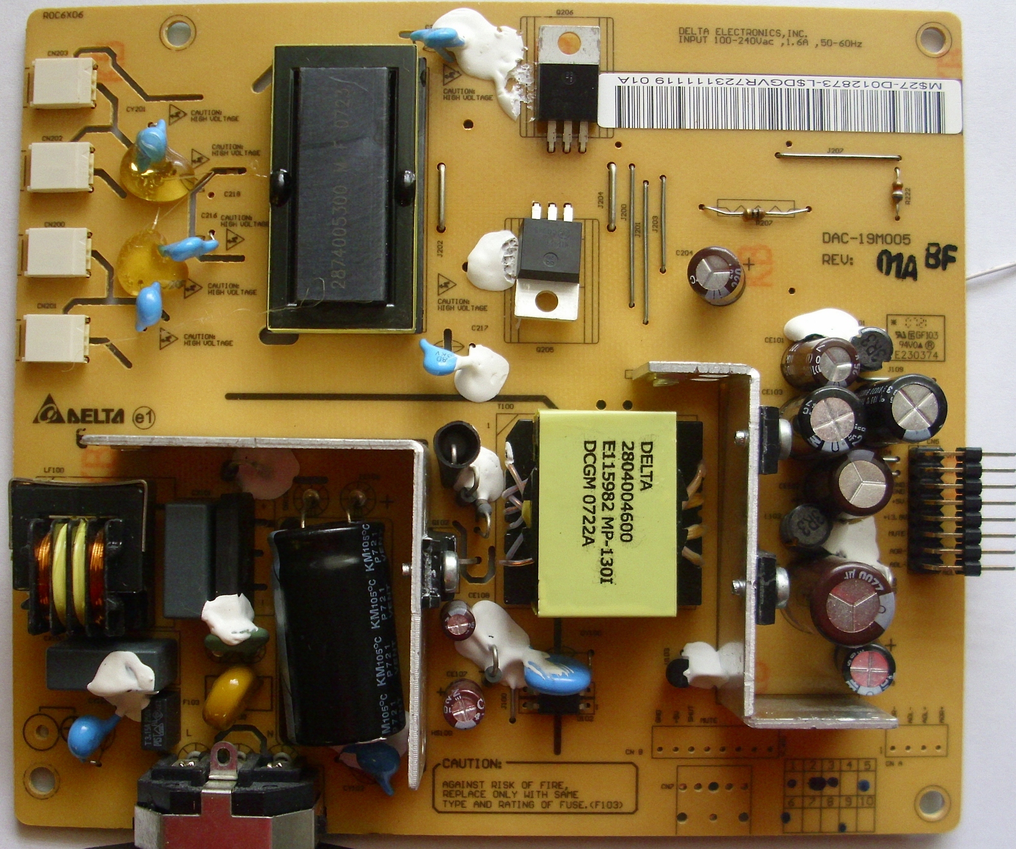

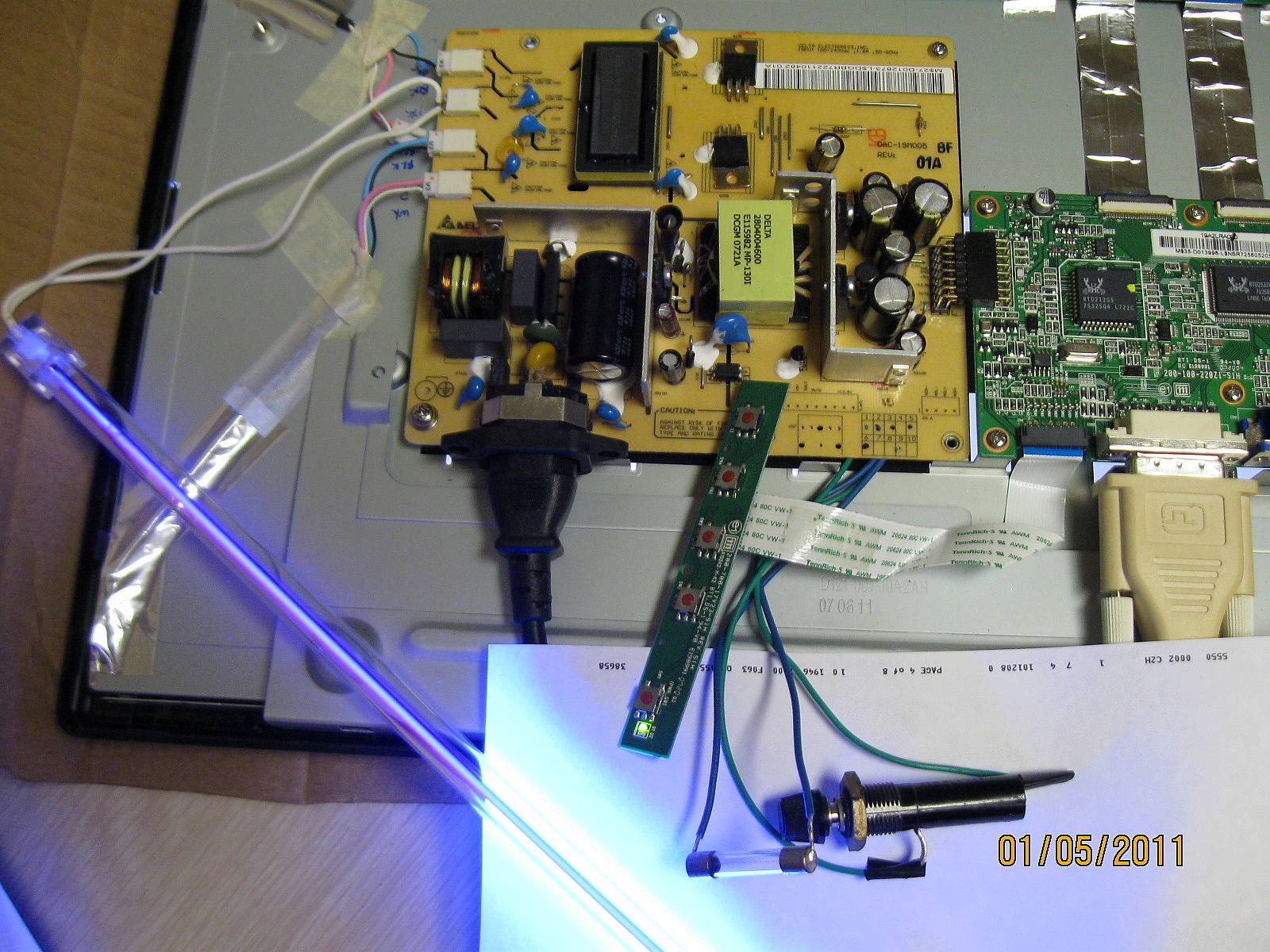

                #67
                Re: DAC-19M005 Power Supply - using temp fuses
                Ok... I Got It Running !!
                I rigged up some more homemade tools to re-test this power supply board, and found it was repaired correctly with the 7 caps and then the 2 mosfets, except that either I blew the 2 SMD fuses F100 and F101 during my last lamp test, or way back when I had installed a cap backward one of them blew.
                See pic of my test rigs, one auto type fuse holder, the second fuse soldered to the test wires, and my test lamp in place of the 3rd ccfl....which was the source of the monitor problem itself.
                I am using this supply board on an Acer 1916WA monitor so its ccfl lamp is the problem now. Before I do this lamp, anyone have repair experience on such Acer lamps ? Does the connection fail on these, or is it more often the lamp itself, or was it the power control failure/fuse/cap ?
                Any tricks to doing these Acer ccfl's?

                  #68
                  Re: Acer AL1916WA.. final problem...the CCFL
                  Looks like I won the battle but lost the war on this one. I found the bad ccfl had a burned off wire. I did my best small wire splice and tight solder on the lamp end...three times...and it tested bright before reassembly and again after...BUT when connecting all 4 ccfls the monitor does the 2 step. When I replug my spare test lamp in place of the repaired one the back-lights stay up. The repaired lamp did not look any worse than the others, and lit up to the same degree as the others.
                  Questions for you on repairing lamp problems...
                  1). Since all 4 lamps need to work in the circuit, am I right assuming that my 'repaired' lamp is still 'bad', and drawing a voltage that upsets the balance, and a regulator and shuts the light down?
                  OR...>do I still have some other inverter circuit problem?
                  2.) My 'repaired' lamp still works on my test circuit since it doesn't care that its lighting one lamp or two and its voltage can be down to 10 Volts ..true ?
                  3.) Do lamps suffer 'hidden' damage though not burned out ?
                  4.) Do you ever successfully repair lamp solder failures, or do you automatically replace lamp while in there?
                  I my case I successfully repaired the power supply, as in prior posts, and found open fuses, and found the bad lamp, and go to see the steady desktop. I got the experience, but now some extra parts, since the dis-assembly and reassembly of the LCD those several times, somehow I stressed the edge and it splintered and ruined the screen.
                  Thanks for your feedback on lamp repair, and all the earlier support too.

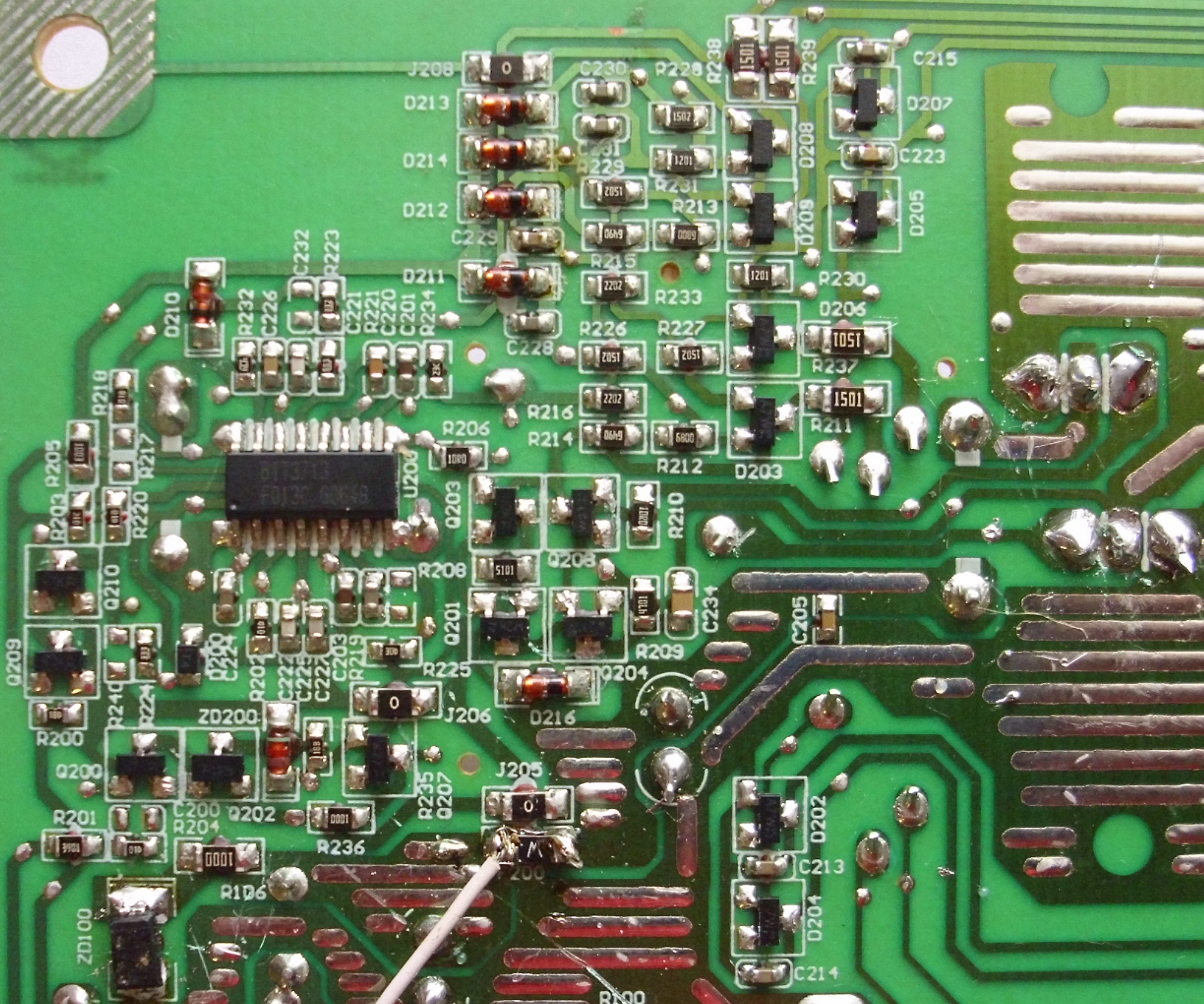

                    Re: Fixing a DAC-19M005 Power Supply - check my DX:
                    I wonder if anyone has found a common cause, After Mosfet replacement as to why the 4 amp inverter fuse would blow.
                    All the capacitors have been replaced, and I am not finding any transistors or diodes in the inverter are shorted.
                    I do not recommend anyone doing what I have done, but out of frustration I have substituted a 5amp ATC type fuse for the 4amp fast blow inverter fuse hoping I would get some indication of something being shorted[in other words I wanted to let the smoke out]
                    With the 5amp fuse substituted, I get a very brief flash of all the backlights of about the same intensity. But the power supply is smart enough to shut down before any damage is done.
                    With the inverter fuse removed, the 12volt rail is able to light an automotive 1157 bulb brighter filament so I know the power supply is able to perform under a load.
                    The inverter controller is a BIT3713
                    I feel this may be a common problem on this DAC-19m005 power supply
                    I have a feeling that everyone will want to refrain from getting involved in this, but I thought I'd ask.
                    Whatever I do, I consider it a success, if in the end I am breathing, seeing, feeling and hearing!

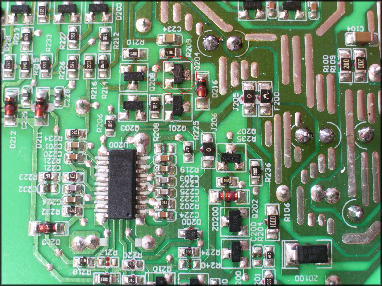

                      Below the F200 fuse are 4 transistors: Q201,203,204 and 208. Check these for shorts. Also, check diode D216 for a short. And finally, check the vaules of resistors R209 and R210. All components are below the the F200 fuse.
                      • alexanna
                        • Mar 2010
                        • 1346
                        #71
                        Q201-3-4 and Q208 do not indicate a short.
                        R209 is reading 4.7K ohms and R210 is 10 ohms

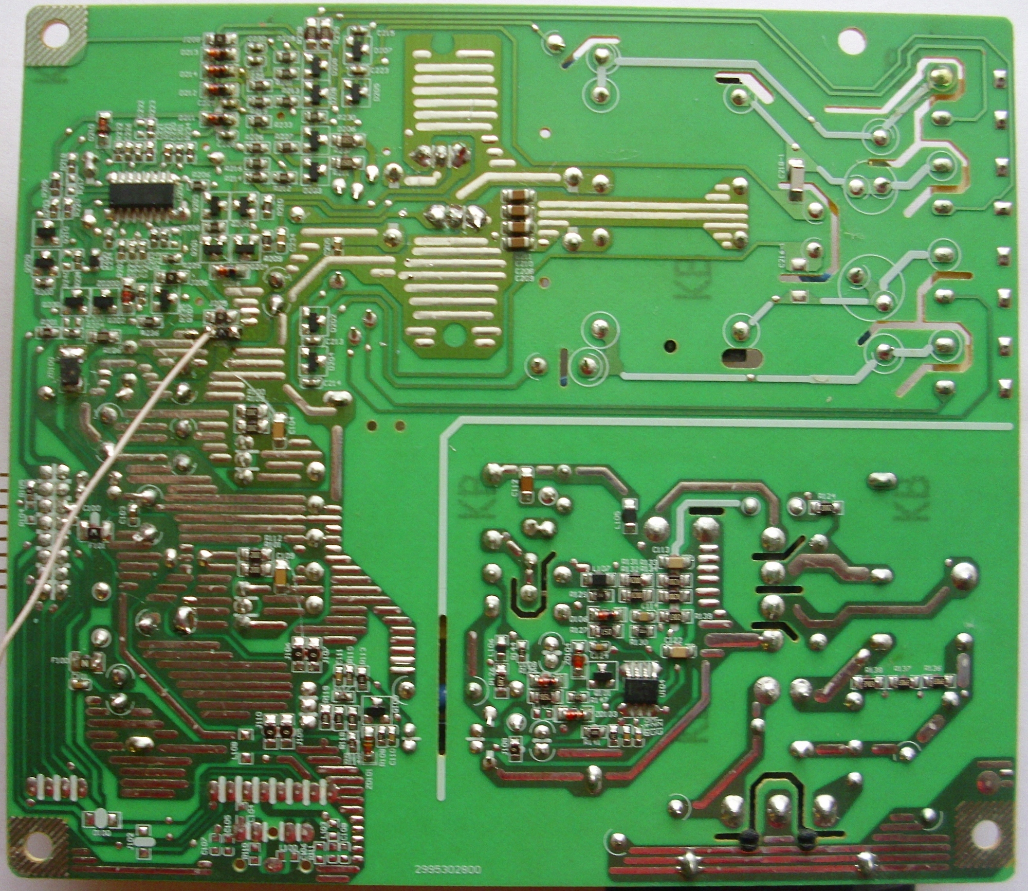

                          Pin 13 of the Bit3713/Bit3193 shows it's connected to ground.
                          As long as the logic board is not connected the power supply continues to work.
                          http://pdf1.alldatasheet.com/datashe...C/BIT3193.html

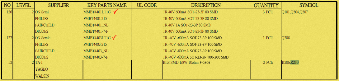

                              Helloo, although I posted on the Westinghouse thread yesterday, I think it willl be fit here too.
                              I post the datasheet of this powerboard, so It could be usefel to correctly identify the components.
                              For instance, the fuse F 102 is a RES MF Fusible 1/2W 100ohm J SAMLL.
                              IΒ΄m having problems with my ACER 2017 (Just 1 video input, DSUB,no DVI input) with revision CF of this board.
                              This monitor, after recapping all (bulged ones and others), still keeps on showing me images on the screen but no backlights. All the fuses were OK, instead.
                              Here is a copy of my post on the Westinghouse thread:
                              "Hello,although this post was started several years ago, it still keeps alive, so, after reading the whole tread, I think I can help a little.
                              When trying to fix an ACER 2017, I used this dac-19m005 datasheet I found on the web.
                              http://www.megaupload.com/?d=YJWEDABQ
                              Here you can see schematics and components. Although it is a different LCD model, is has the same power board: DAC-19M005 CF REV: 00A, (plus it has just DUB conector, no DVI, but still the same board too), so: same problems and same fixes, I guest.
                              After recapping all (same 2 bulged caps as every faulty board), I can see images on the screen but no backlight. You only can see it taking a light close to the screen ( I didnΒ΄t read anybody in this situation, everybody has no light but nobody has mentioned about dark images with no backlight)
                              All the fuses on the backside are OK but I can see a damage transistor: Q204, on the backside, right close to the F200 4A fuse, so probably this is what I need to fix.
                              According to Kahless (on post #299 and # 301) and billy 66 ( #320) I can see Q2004 burnt ( probably thatΒ΄s because F200 fuse didnΒ΄t blew up), but I checked R210 and I got about 11 Ohm, so I think itΒ΄s Ok. Anyway, I ordered replacements for the whole components:Q204,Q208 and R210.
                              IΒ΄ll post the results when I get it working here or in a new thread refering ACER 2017 (only DUB, no DVI conector)"
                              • blackrider1
                                • May 2011
                                • 28
                                #75
                                You can see, depending on board revisions, some minor changes, like F200, changed from 2A to 4A, or caps CY 2001-218-216-200 (close to the backlights connectors), 4 of them on the front side in one revision and 3 of them on the front side and one on the back side (C218-1) in another versions, but everything else looks like equal.
                                Anyway, I hope this datasheet to be useful for you guys.
