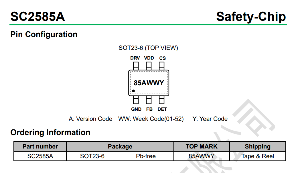

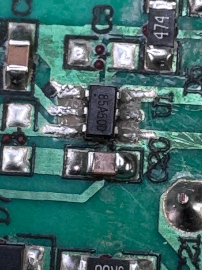

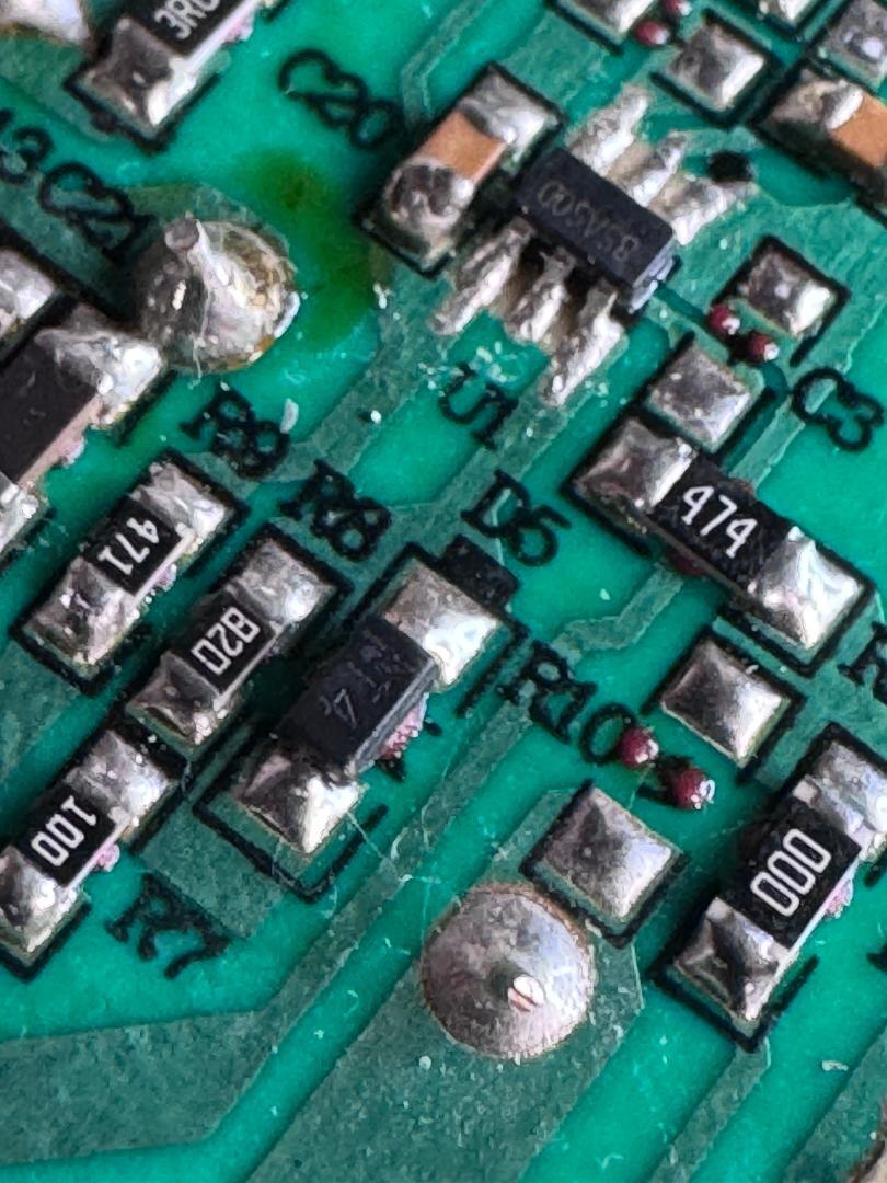

    I also need help identifying another component 85A50D 6 pin IC has a U under it. There is a picture with the voltages on a live circuit. There is diode voltage drop between ground and pin 1,2 and I think 3? I looked for it and could not find anything. It's from the same power supply as above. I really appreciate any help.

      85A50D = SC2585A

          Yes, it's a tough case, I gave you full information on the chip (SC2585A) that you are looking for in post 3.

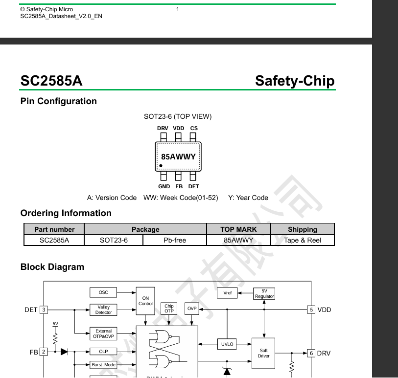

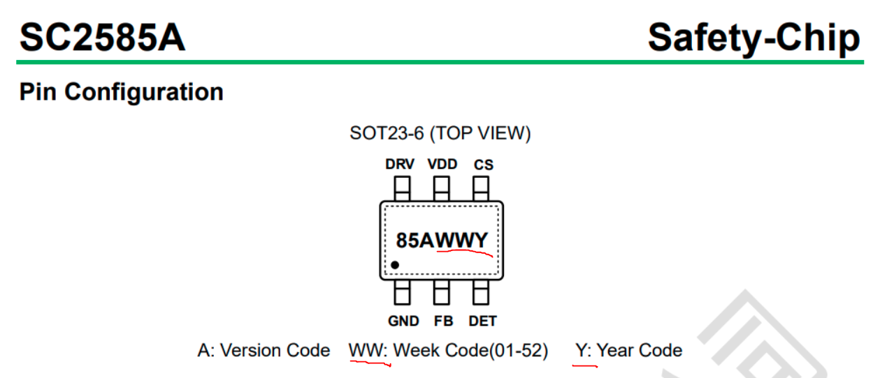

            Ok I am trying to learn how you found the chip. In the description it mentions Top Mark 85AWWY. So it's an 85A chip. I see that 50 is the week of manufacturing and D is the year. The chip you found is SC2585A.

              Originally posted by gica69
              What about the 50D does it mean anything and is there a place to identify these top marks. The chip you found is SC2585A.
              It says that it is the production date.
