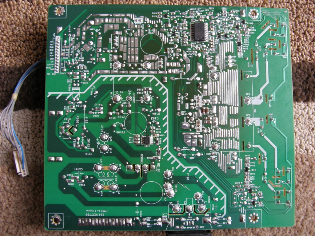

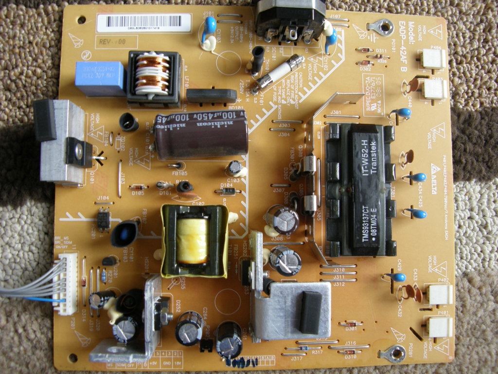

Last night, my screen went dead during a movie i was watching, doing the whole on for 2 seconds, then off for several minutes, and after searching around the internet, i came upon this website.
Being at least a little knowledgeable, and always wanting to learn new things, i took it upon myself to start pulling this guy apart to take a look at the board.
The first thing i noticed is the burn marks on the Q305 Transistor, and checking the ohm value, it came up as 126 and 72. Shouldn't they be the same, or depending on what type they are, will the NPN junction show two different values?
Checking the capacitors, they all look like they are in good shape, and all built by reputable companies, Rubycon and Nichicon. No identifiable expansion or leaking, and no signs of heat or electrolyte.
When I checked the high voltage transformer, there was a huge difference between the two secondaries, with one being 1798 ohms, and the other being 971 ohms. Is this a clear indication that the transformer is cooked?
I checked the other transistors on the board, and none of them showed a short, and the ohmic value seems consistent, so i don't think there is an issue there. The diodes seem OK, except for one, D105, which shows ohms both ways, but may be due to the resistor in parallel to it.. R113?
Hope this is a good start. Any more ideas before i pull the transformer and get a new one?
