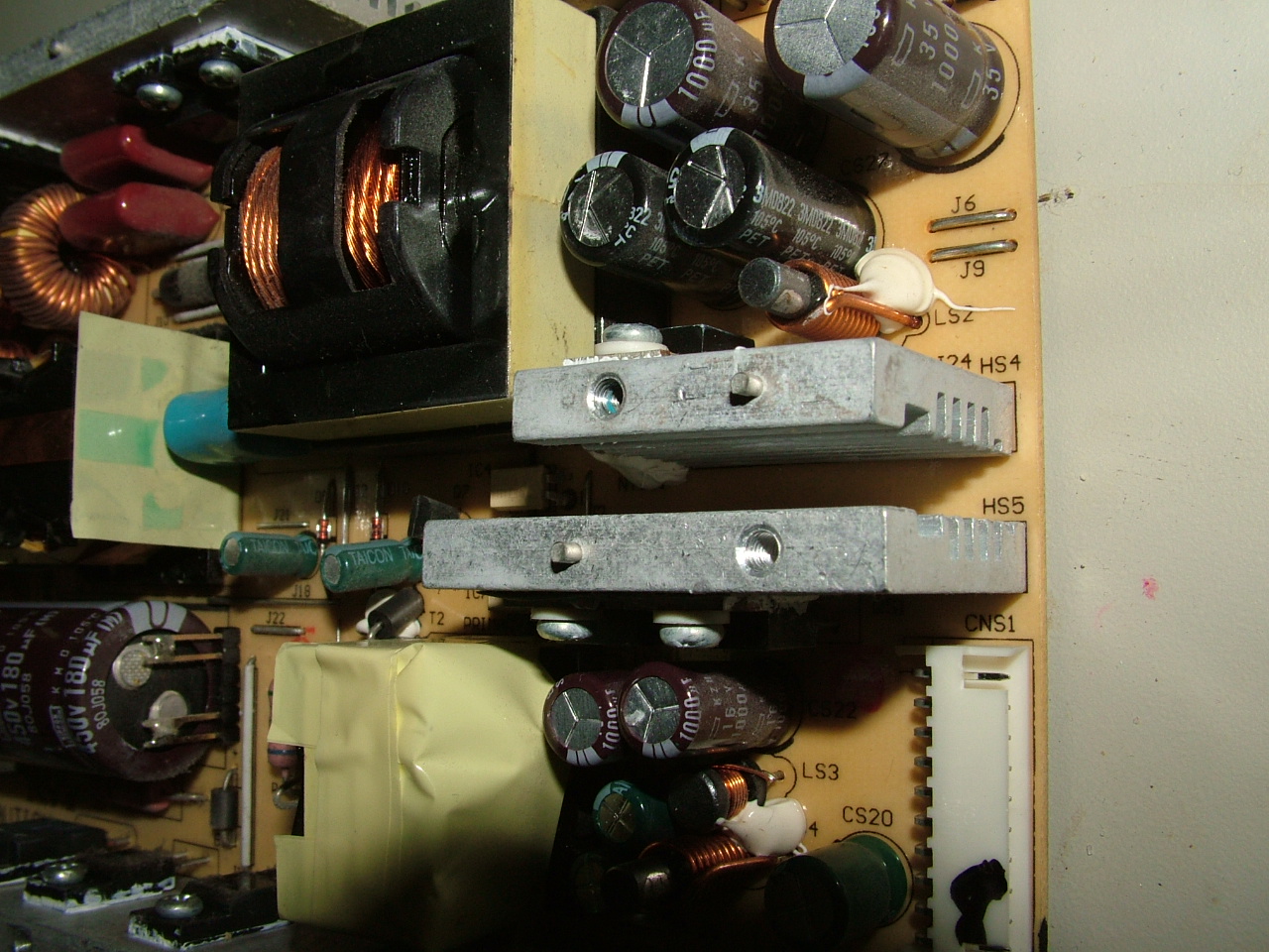

Re: Hanns-G HG281D, LCD Monitor no power
We rarely provide lists of caps as we have no idea what version of any particular board might be in your set. The manufacturers sometimes make amendments to the values they use even on the same board versions.
The best way is to simply list the caps you have on your board and then look up the datasheets and see what is available at digikey. You need the same voltage and uf value and same or better esr. You should also make sure they will physically fit.
If you look a few posts up there is an example of this -
Just one more for the list...but I have one symptoms I didn't see anyone else mentioned. First I have the blackout problem. It stays on for a few minutes and then shuts off, no blue or amber light on. If I reboot it comes on but the same thing happens after a little while. I looked at all the compositors, no bulges and no leakage. I have tried low resolution, same thing. Now the thing I noticed is while the screen is off and I disconnect the HDMI cable and plug it right back in, the screen comes back for a few minutes. I forgot to take pictures of the logic board, but all of those capacitors also looked like the ones on the power board. Any suggestions?
