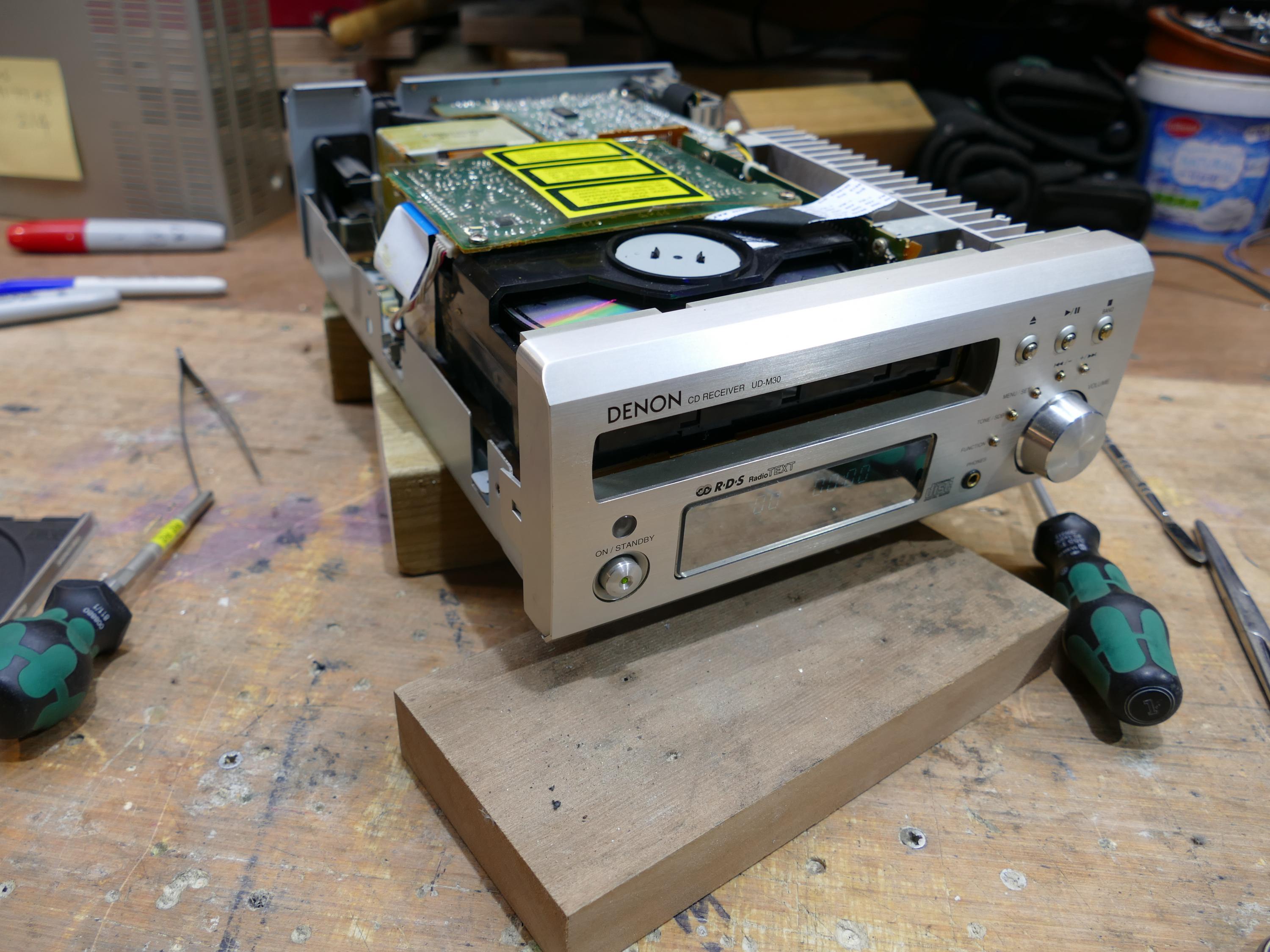

    I'm try to repair a Denon UD-M30 which is a compact all in one CD/Amp/Tuner and the service manual calls for the above test CD.

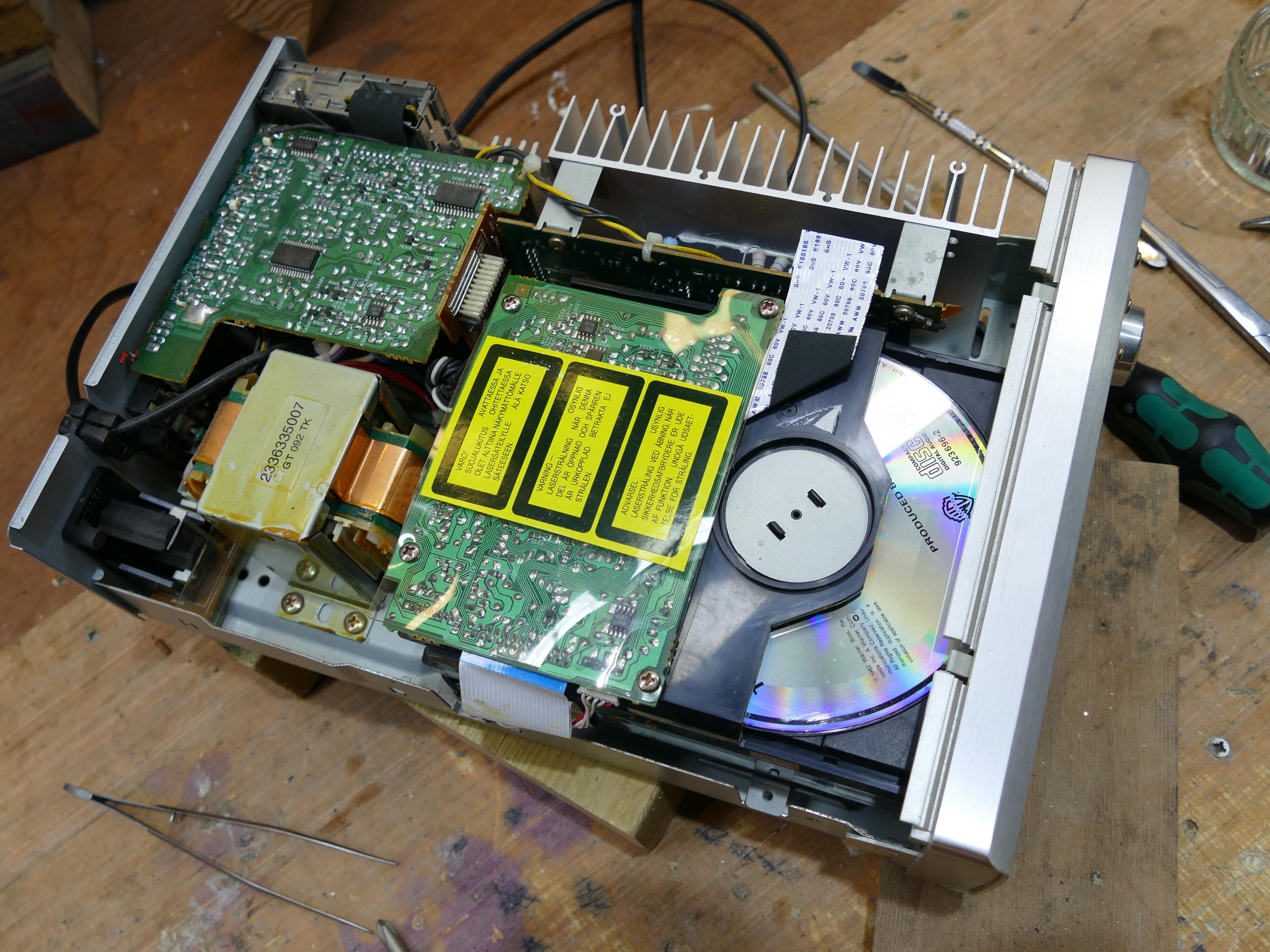

        Re: Denon TCD-784 (ABEX) Test CD ISO
        Thanks both.
        I've just opened the box and after the tray loads the CD it's doesn't spin up.
        I've cleaned the lens with ipa but it still won't spin up.
        Any thoughts?

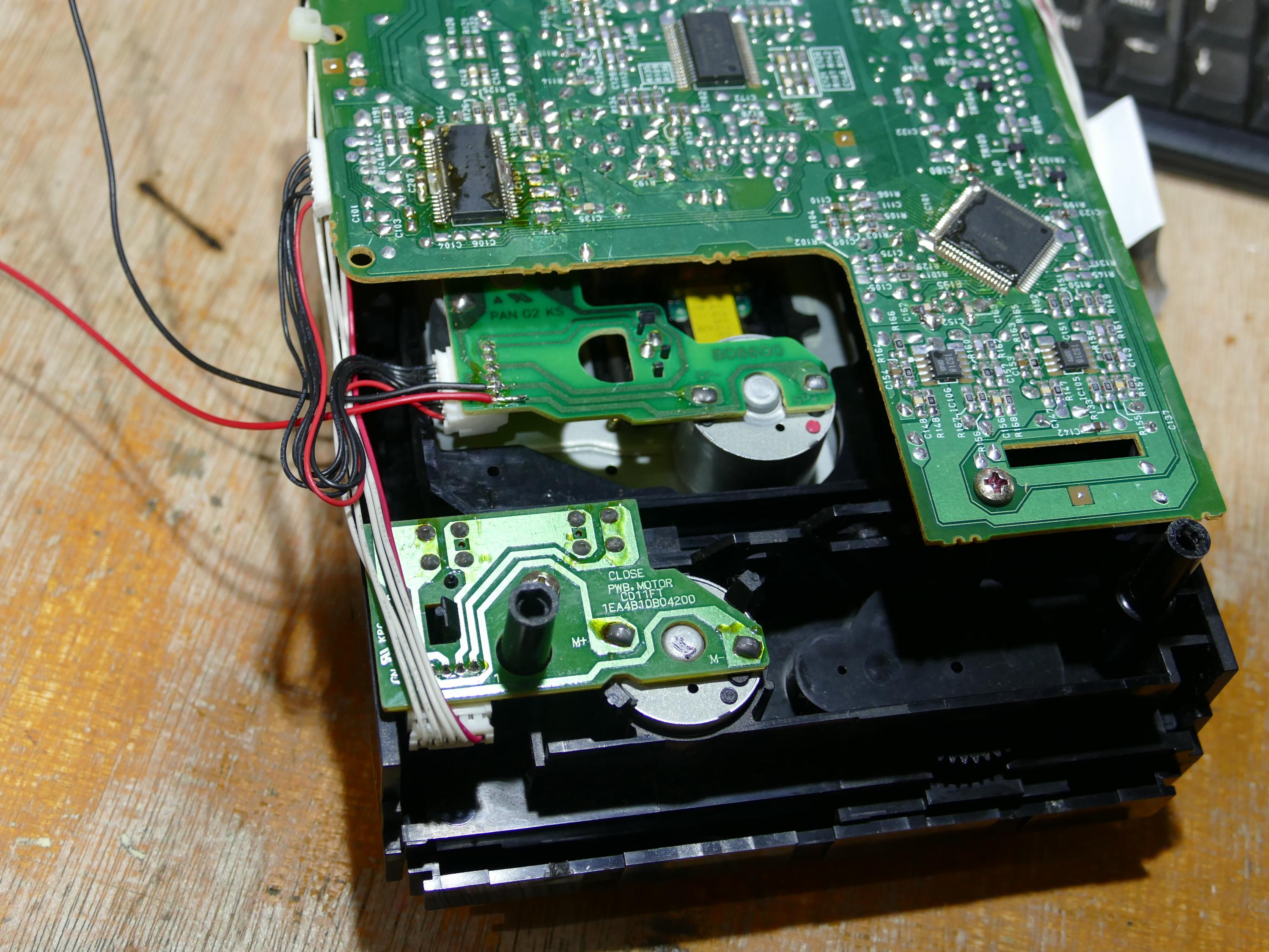

          The difficulty is that in order to get to the CD PCB (which lives on the underside of the drive) you have to disconnect it from the rest of the circuitry. So I'm not sure I can take measurements with the CD drive powered.
              If you close the tray without a disc, can you see if the optics are moved to the inner part of the disc, Does the laser light? does the lens try and focus (move up & down)?
              When there is a disc in the tray, does it spin freely? or is the spindle motor sticky.
              If you can operate the mechanism manually (turn the sled motor gear) to move the optics to the center of the disc, then load a disc and see if the optics move to the inner part of the disc. This will check some of the operation.
                After taking the CD deck out I can confirm that the in & out limit switches work at the appropriate time.
                The motor that spins the disk does not turn on when the tray loads the CD.
                The motor itself works when powered with 5V.
                  After taking the CD deck out I can confirm that the open & close limit switches work at the appropriate time.

                    Do not hook 5 volts to the motor with it connected to the drive board, you can damage the driver ic.

                      Thanks for that.. I disconnected the motor/switch board before i powered the motor. The red/black wires were principally to measure V across the motor when in use.
                        Q: does the laser briefly switch on to check for a disk before the motor spins?
                        Or does the laser power on after the disk spins?
                        • R_J
                          • Jun 2012
                          • 9594
                          Usually the sled drives the optics to the inner stop, the laser will light, the lens will focus and the disc should spin.
