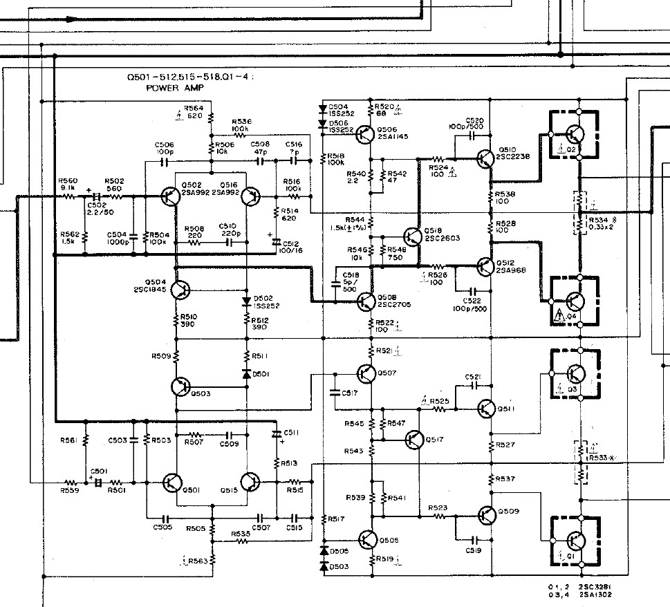

                    Can you be a bit more specific and take a look at the circuit diagram, just to point me in the right direction as to where to start to look?

                        If you get a chance to take a look at the schematic that would be awesome....whenever you would have time of course......

                          basically look up the power amp section and go from Q1-4 backwards. Q1 and Q3 is one channel and Q2 and Q4 is the other channel. One of them channels has DC on the output. Once you find the channel that has the DC, follow it back through the individual amplifying stages... Page 9/31 on the service manual.

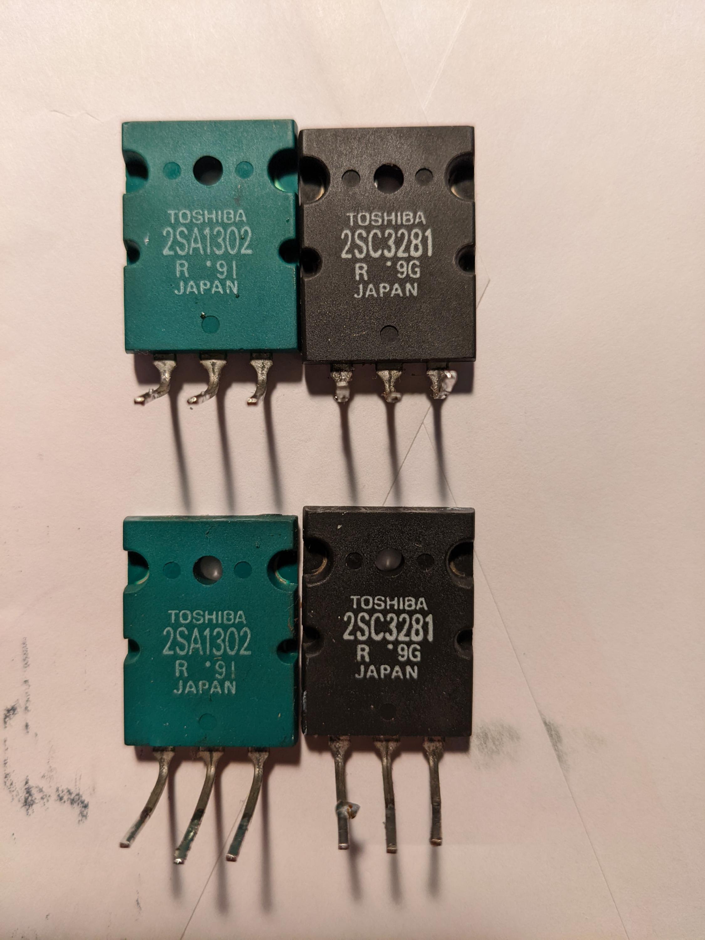

                            So I tested out the 4 main transistors and all 4 are shorted out...... I removed them from circuit just to check all of them, and they are all indeed shorted out.
                            Then I plugged it in and pressed the power button, the relay/circuit protection clicks in....
                            but im also assuming I'll have to follow the circuit further back to see if other transistors in the driver stage and pre driver stage, or other components are fried.....

                              The relay doesn’t matter now with the finals out. All 4 of them finals shorted? That is not usual. Usually it’s just one channel, but not both. However… check the other stages for shorted transistors.

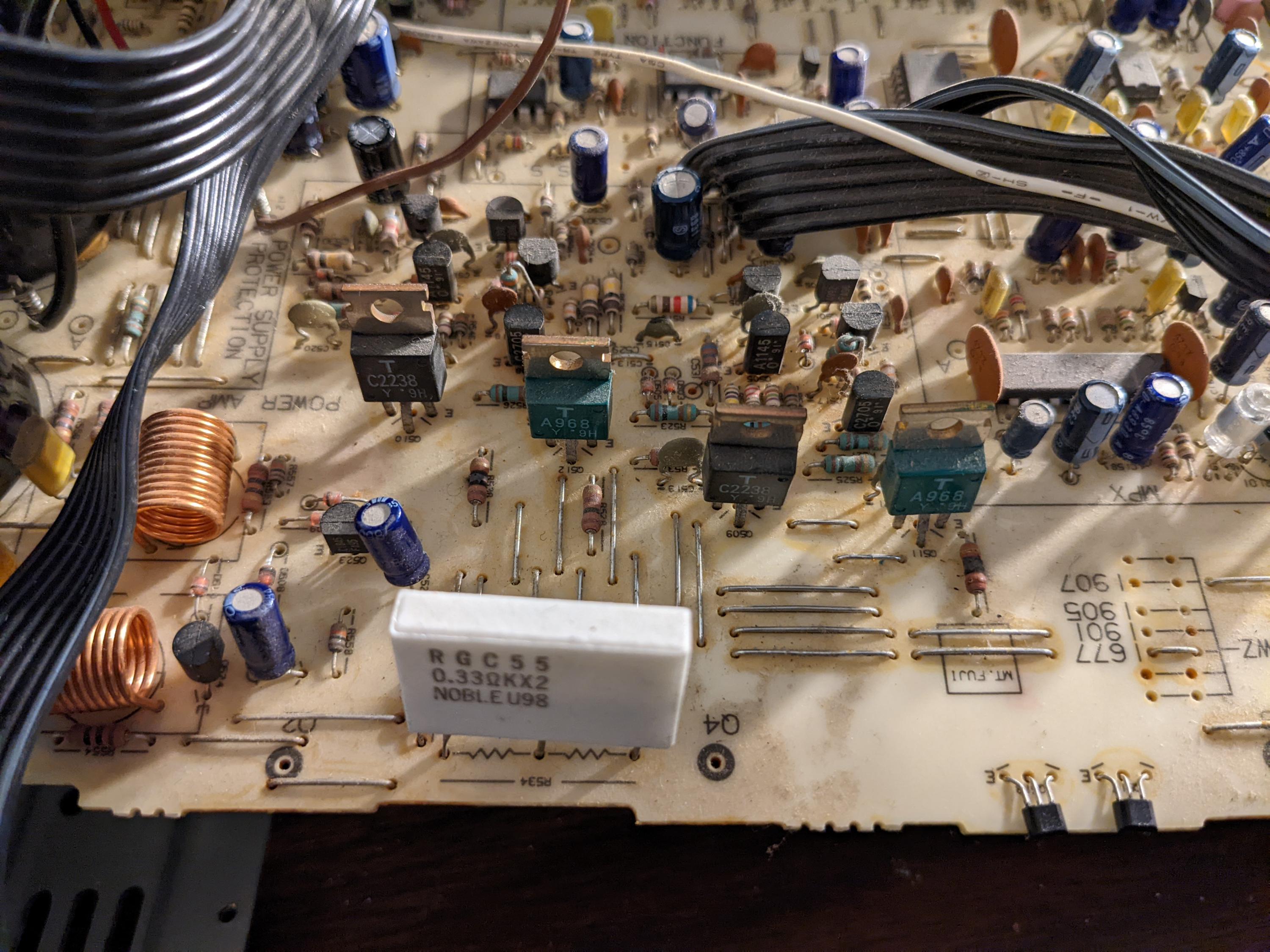

                                Ok, so I am tracing the circuit back and the next transistors for each channel, from what I can gather are Q509-Q512, I took those out of circuit and tested them, two of which are PNP, and the other two are NPN, I tested them and believe they test good....not shorted, and are showing with my DMM to be passing current correctly......do I stop there or should I keep tracing back to Q505-Q508, and then Q501-Q504? There's also Q515 and Q516 too......Thoughts?
                                On a different note, the 4 main transistors are from my research obsolete, can anyone help me with selecting suitable replacements? Typically i've been ordering from Digi-Key.....
                                Pictures are attached for review......

                                  While you are in there, I’d check them all… after all you want to make one order if possible keeping shipping costs down. Also check the resistors, if they are going bad, to 99.999% they go higher in value or open. At the same time, check for bad caps on the supplies…

                                    2SC3281 -> MJW3281AG (On Semiconductor)
                                    2SA1302 -> MJW1302AG (On Semiconductor)
                                    These should be more or less exact replacements.
