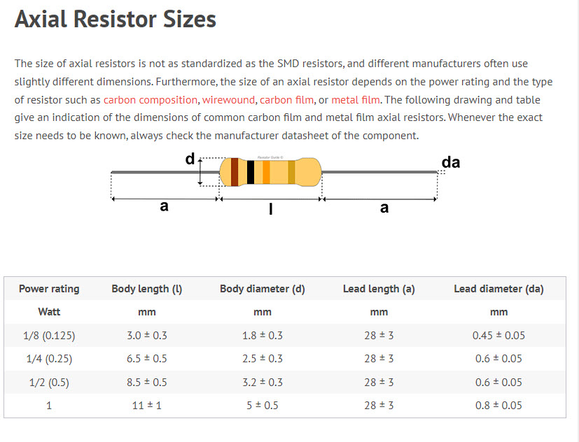

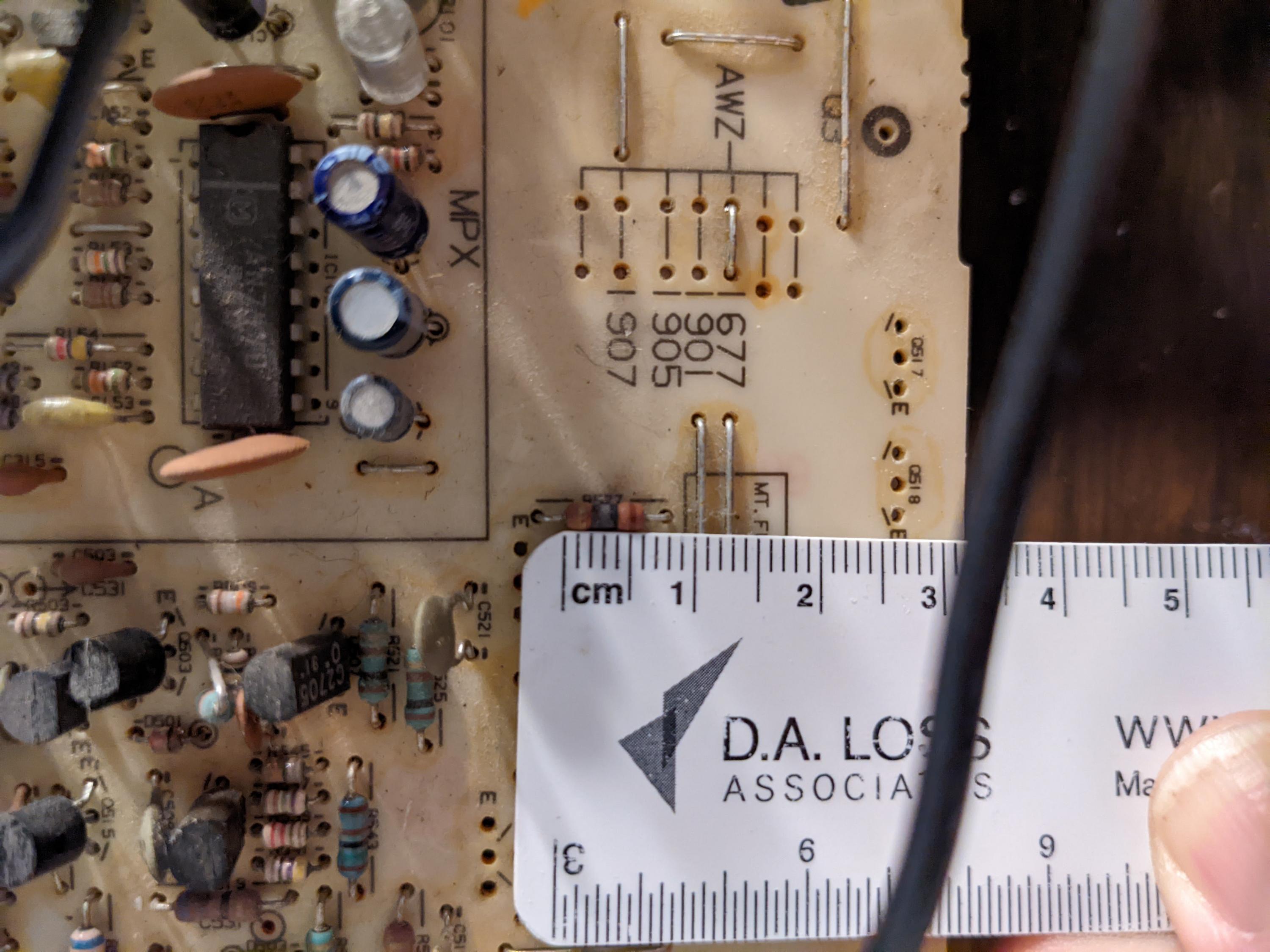

    I think I answered my own question, but just looking for verification, I believe by this picture, measurement, and chart attached, that these should be 1/4W resistors....

      See page 6 of the service manual, under the heading RESISTORS: most are under 1/4 watt or less unless noted ie R533 is listed in the parts list. R544 1.5k (1%) Or R609 marked on schematic as 1watt
      • thetonywarren
        • Feb 2013
        • 169
        #83
        Re: Pioneer VSX-3300 Receiver Wont Power On
        Ok, great, thanks, I ordered a resistor kit and will start replacing them.......

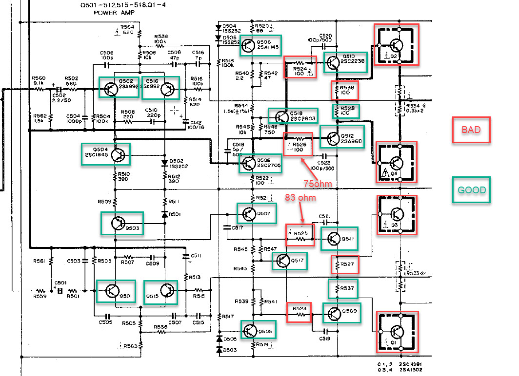

          Can we see some pics? Maybe mark the bad parts in the schematic and attach it too.
          • thetonywarren
            • Feb 2013
            • 169
            #85
            this is as far as I have gotten....See picture for details on good/bad components......im sure you guys can see some sort of pattern or where the source of the issue is/was??
            • thetonywarren
              • Feb 2013
              • 169
              #86
              Any further insight after I posted what I have checked so far?
