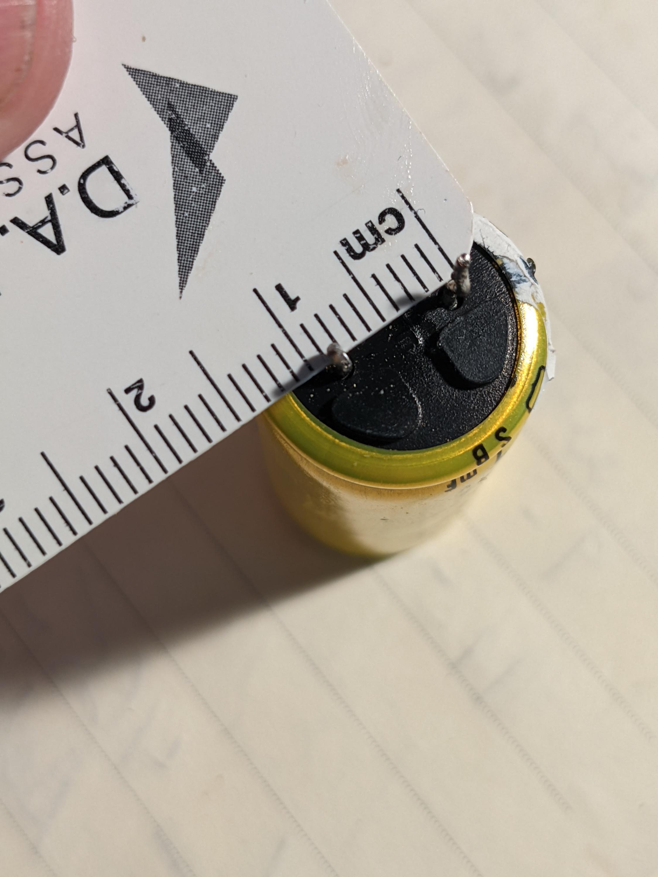

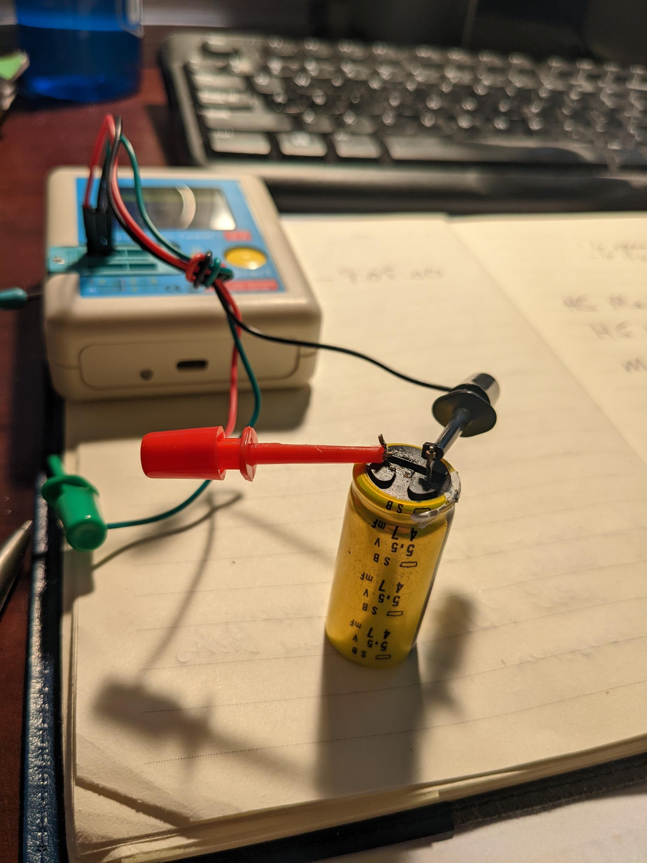

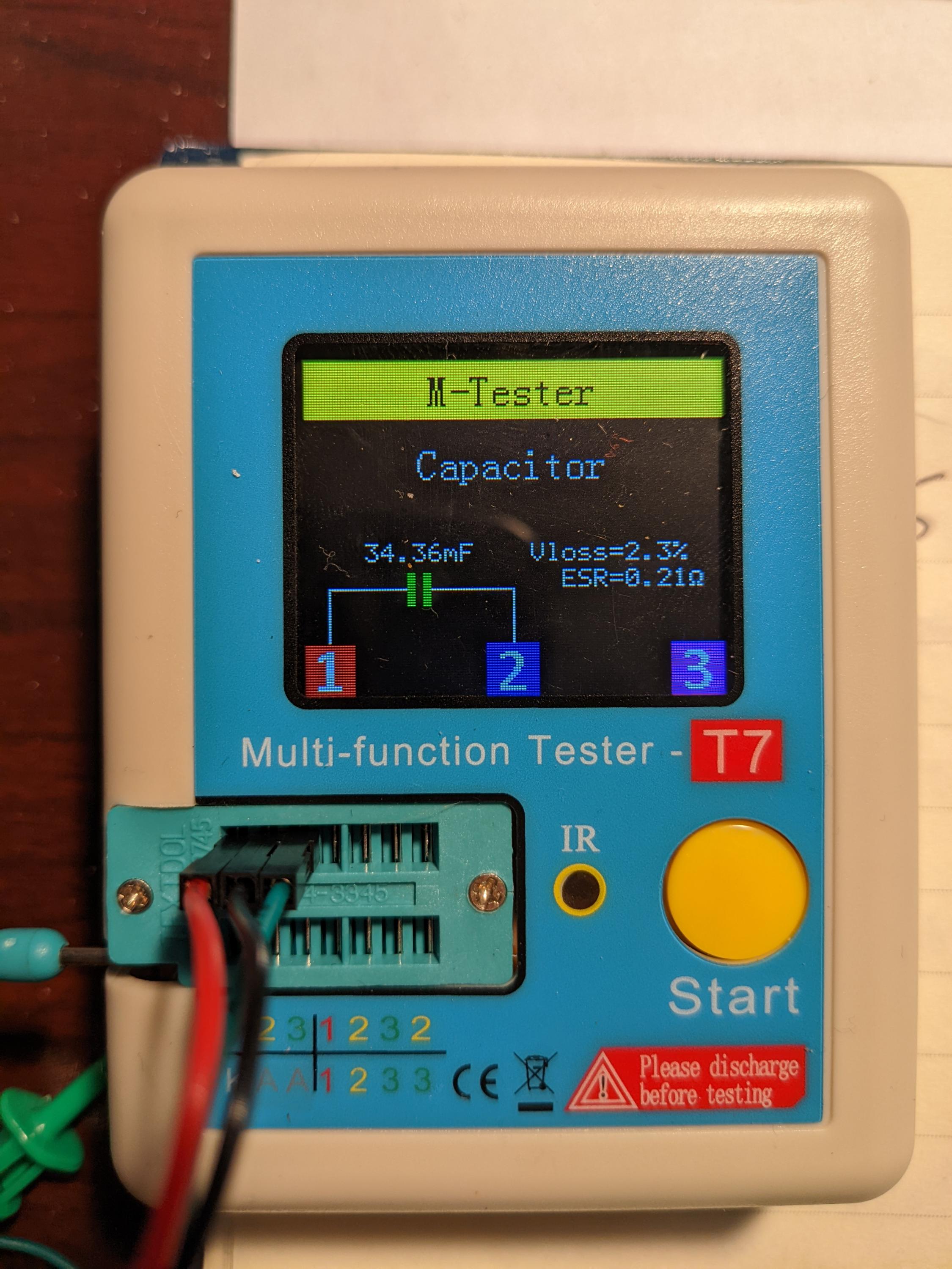

                  I have one of the cheap multi-function testers and you can see what shows on the screen, looks like it's testing at 34mF, seems low to me, but not sure with this size of cap.....when I look for replacments, I dont see any of similar size, all I can find are supercaps? Is that what this one acutally is, they seem to have different physical sizes than the one I have here.......

                    good work... size isn't necessarily an issue except maybe fitting to the board / mount. You might have to do some mod (ie. jumpering, glue, etc). look for something with the same capacitance and move up in voltage... it will likely be smaller physically (also due to advances in technology).

                      This is what I purchased.....see attached screengrab.....I couldnt find a suitable substitute with a higher voltage rating, so hopefully this one should do......

                        hmmm... might not work. I don't see that it is an electrolytic (ie. polarized) which I believe the c617 is. You need to check that.

                          That cap is likely bad, it is a super cap 47mf/5.5v, mille not micro farad used for backup. It is possible the cap has been discharged for so long it won't charge any more and loads the 5v line too much so the micro won't turn on.
                          You don't need to have a higher voltage cap in that position 5.5v is what it should be.

                            Check page 2, and page 7, I think it is polarized, at least from what I can find......Hopefully I picked an ok one, cause I couldnt find any close equivalent on the electrolytic side of selection on DigiKey.......

                              Yes it is a polarized capacitor it acts like a backup battery in the circuit.

                                      That super cap is not really needed for function. It’s probably just to keep settings, time etc. With the super cap c617 removed, the 100 ohm resistor put back in place, the unit should work now fine. Looks like the old cap is “wet” on the bottom?
