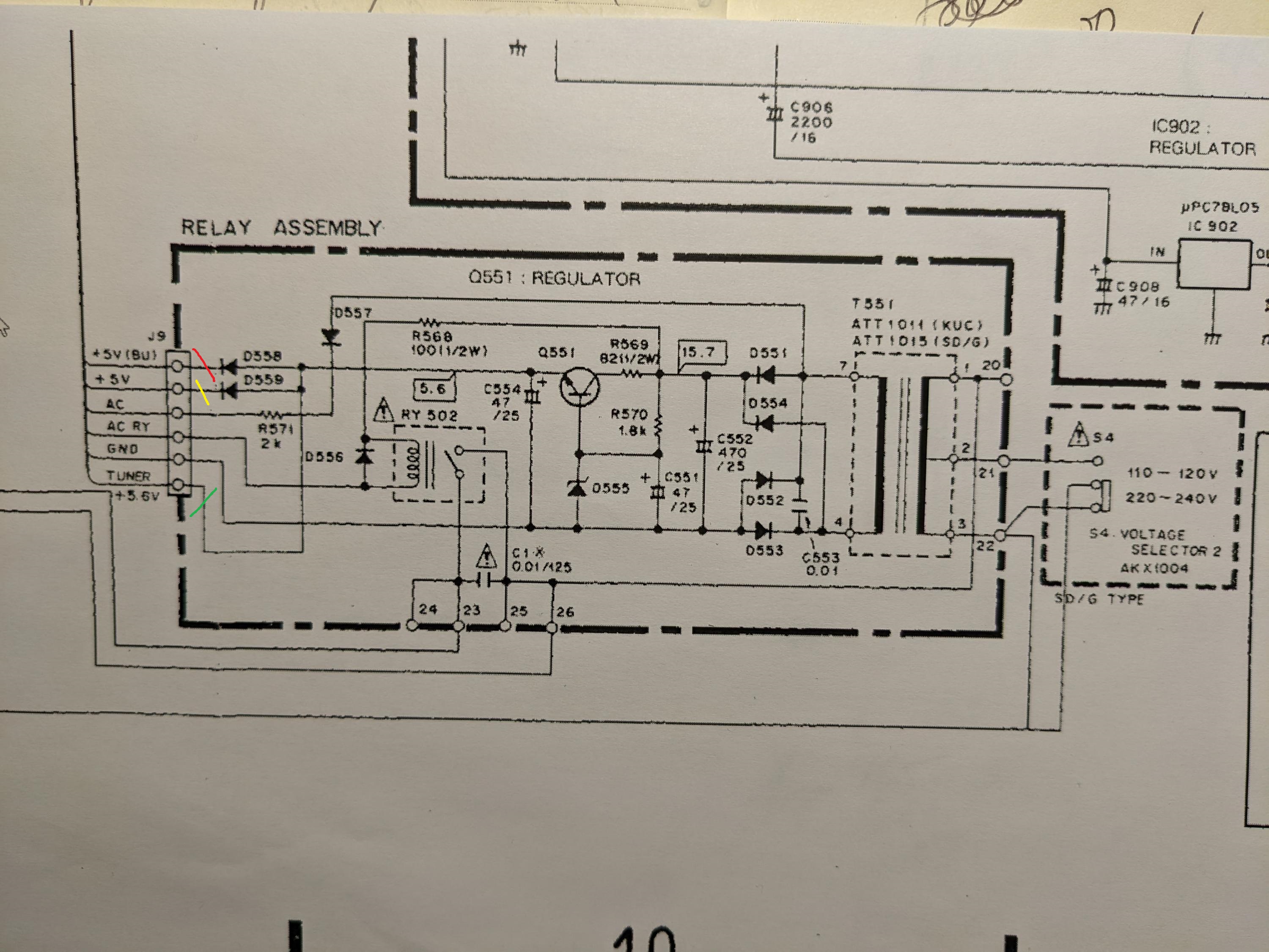

    R569 is very hot, but when I tested it out of circuit it was approx 82 ohms, like it should be. I tested across the capacitor after removing one leg of R569, and the voltage to the capacitor did rise to 15.3V. I checked voltage across D555 and it's only around 3.4V, and when I take C551 out of circuit and test with ESR it is about 46uf.....
    • R_J
      • Jun 2012
      • 9633
      Re: Pioneer VSX-3300 Receiver Wont Power On
      If R569 is very hot, I suspect there is too much of a load on the emitter side of Q551.
      Did you unplug J9 and see what all the voltages are around the Q551 regulator?
      If the 5 volts comes up with J9 disconnected, reconnect it and remove one end of D558 then D559 to see which line is loading down the circuit
        I had to unsolder J9 as it doesnt have a connector, oh well.... when I unsoldered it, I do have 5v on J9. I re-soldered J9 and removed one end of D559 first and checked voltage, it was at around 2.3V, then reconnected it, and removed one end of D558 and checked voltage and its around 1.2V both were checked at J9
            I thought J9 was a plug. anyway, J9 has 6 wires, which wire's did you remove to get the 5 volts to come up?
            You can leave them attached and remove D558 and check the voltage on Q551 emitter, Then remove D559 and check the voltage on Q551 emitter, if the voltage is still LOW, remove the wire on J9 labeled tuner and check the voltage on Q551 emitter.
            Once you isolate the line that is getting loaded down you can track down the bad component
                maybe something is sucking the 5V rail low on that relay board?
                • R_J
                  • Jun 2012
                  • 9633
                  That is likely what is happening and that is why I suggested to lift the components to see which of the three lines has the problem, we'll see what happens.
                    Well there are 3 possibilities. 5v, 5v backup and the 5v for the tuner.

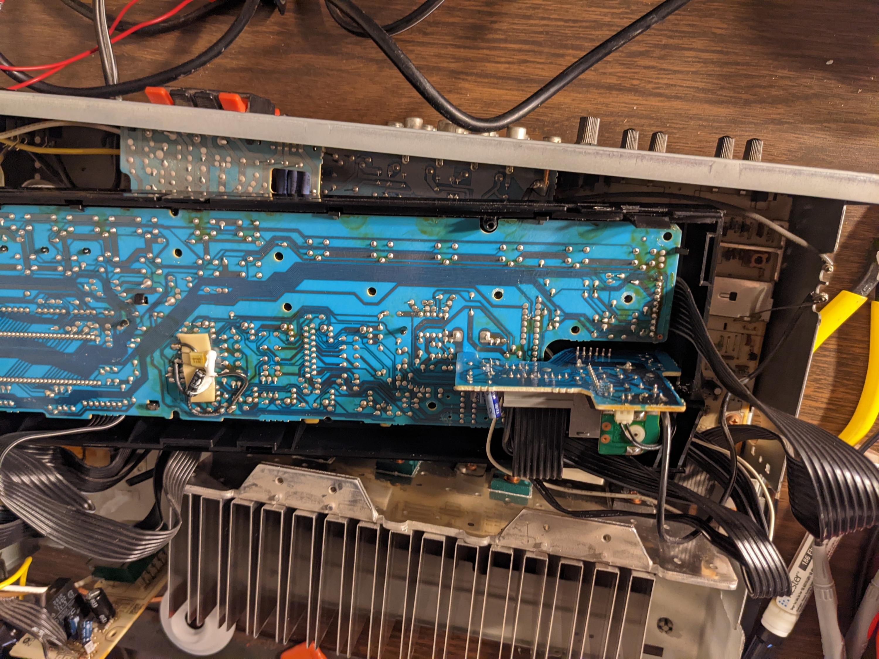

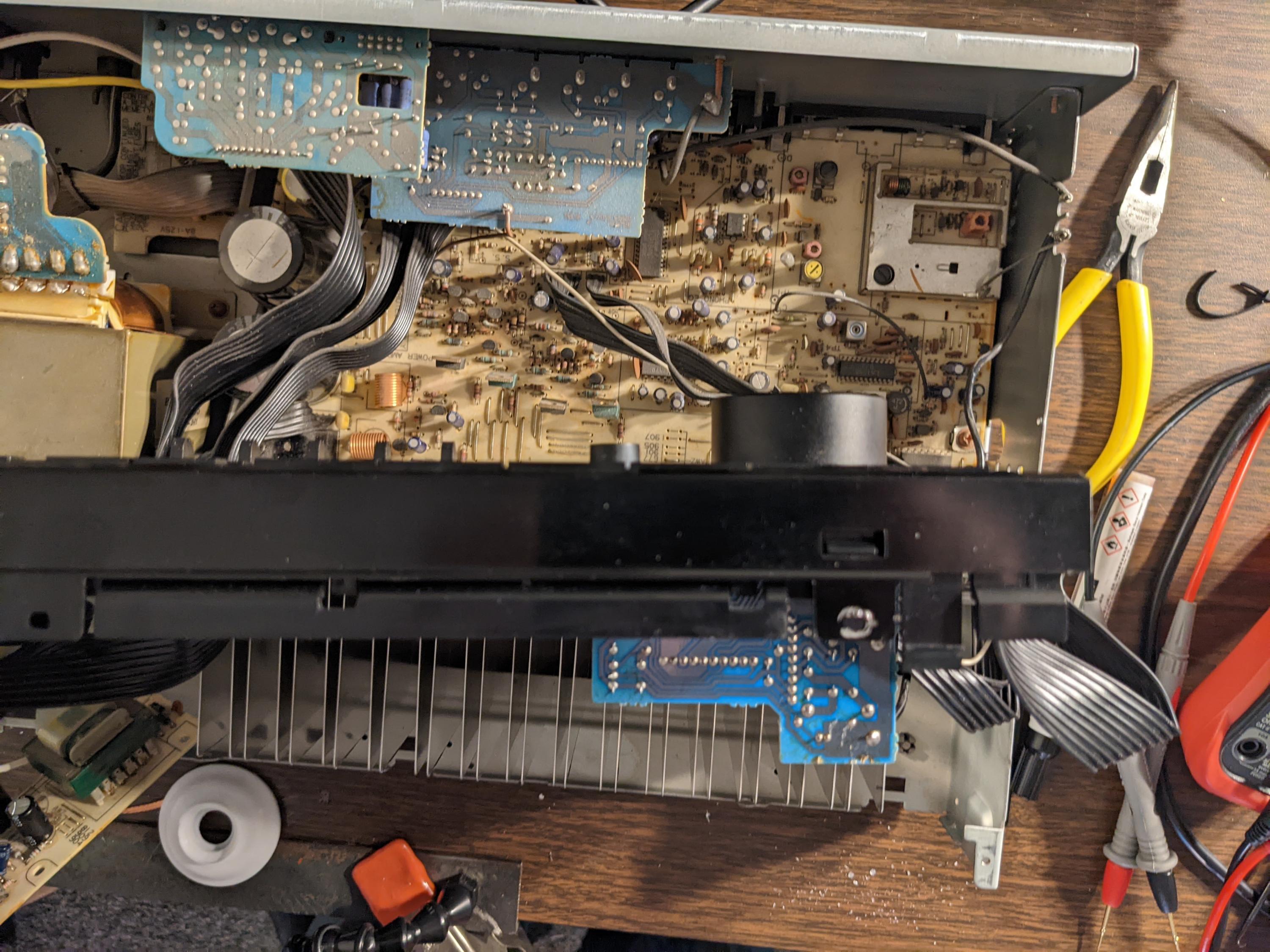

                    • thetonywarren
                      • Feb 2013
                      • 169
                      #30
                      Ok, sorry for being off the grid for a few days, Im back and available to test things further....
                      I did remove the first connector on J9, which is +5V BU, and it looks like the voltage comes back up, when I tested voltage at C552, I now have around 16.8V, so I would assume that's the path that's bringing it down?
                      Let me know your thoughts and next steps.....
                      Again, thanks to everyone for their help and assistance, it's greatly appreciated!

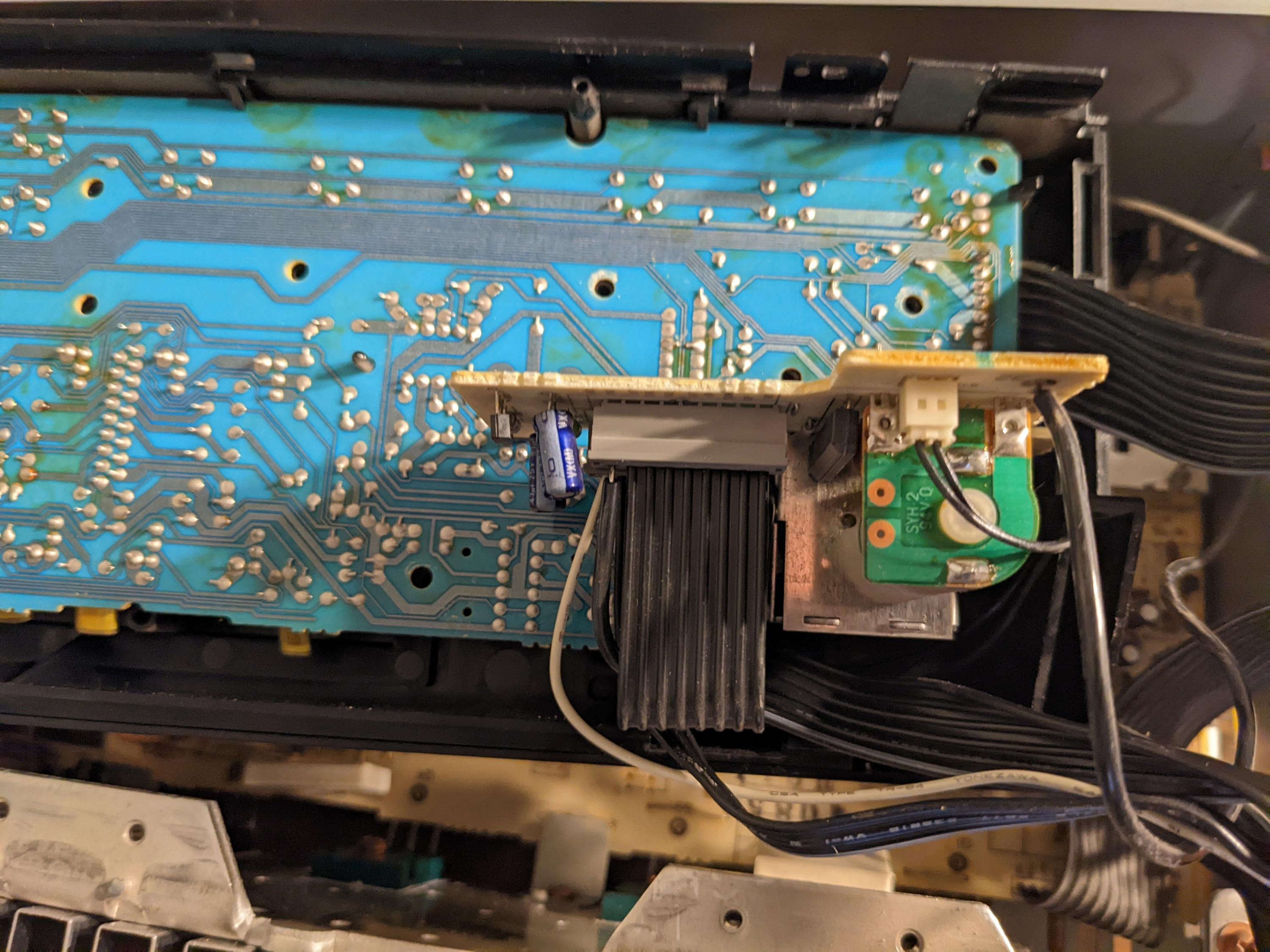

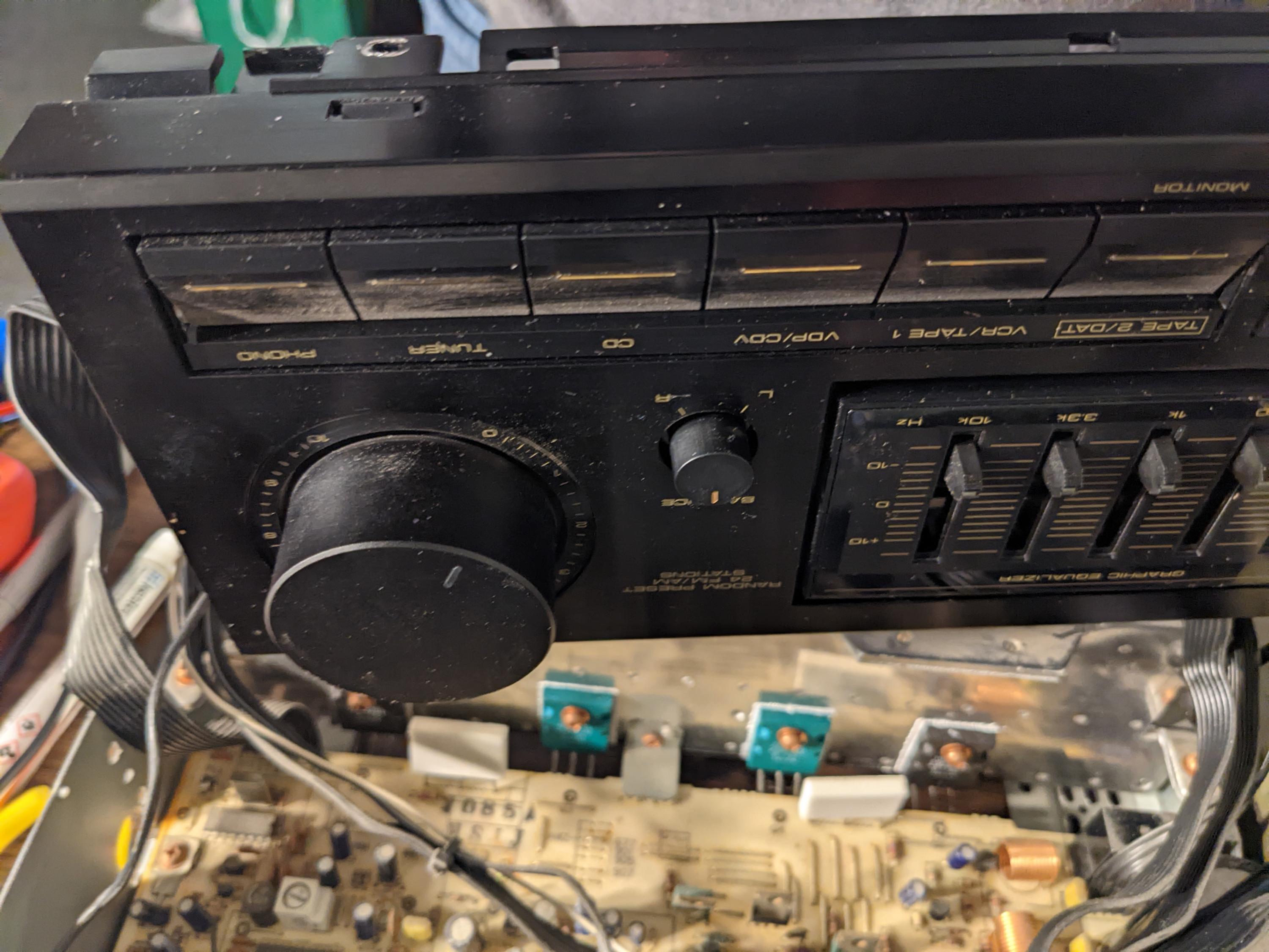

                        so next question, I want to check C617, but I believe it's behind the circuit board thats contained in the front panel.... In order to get that circuit board out to look at it, I need to remove the front volume knob, because there's a horizontal circuit board for the volume knob in the way....does anyone know how to remove this board/volume knob assembly, Im not seeing any obvious connectors or way to remove the knob assembly.....I'll attach some pictures.....
                        • thetonywarren
                          • Feb 2013
                          • 169
                          #32
                          Never mind, I was able to pull the front volume knob off, I wasnt pulling hard enough, just trying to be as careful as possible.....

                                        • thetonywarren
                                          • Feb 2013
                                          • 169
                                          #40
                                          I pulled out both C706 and C708, both of them tested out to be good......
                                          Additional info, yes, all other wiring is intact, although I did need to unsolder the front information screen/panel, to get at C708,
