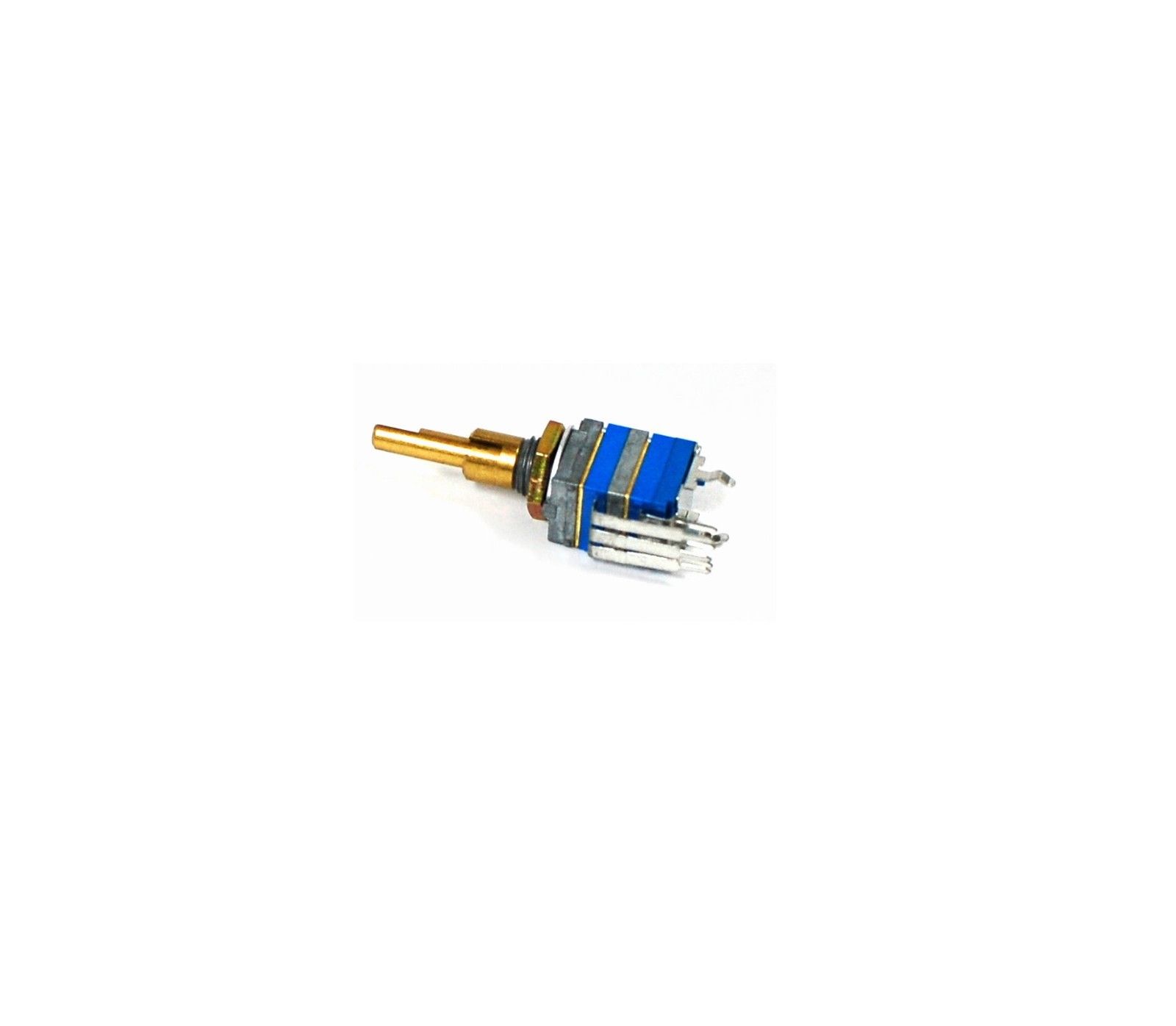

    So I have one of these come in for repair, deaf across all bands I have the service manual for this and will get to that in due course. The radio has had a hard life before coming into possession of current owner / client. I need to locate a pair of rotary encoders (volume main and sub) part number J62800138 its a commonly used encoder across a range of vertex radios.
    There may not be any point in proceeding with the repair unless I can source a pair of these and currently for a part that must have cost pennies the only sources I seem to able to find are in China or the US and are costing upwards of $30 - $40 per unit. See below

    If you order 10,000 units you might get them for pennies but for only a single unit, that's not that bad a price for a dual encoder with switch, at least it is still available.

      Yeah I think the customer is going to feel differently about $60 to $80 dollars just for a pair of encoders that is before I even get started on the repairs to the radio itself and the obvious fees involved.

          The centre shafts have both been broken off

            Well the customer is happy to pay for replacement rotary encoders so now all that remains to do is establish why the radio effectively has no receive across all five frequency ranges. Although the set produces a decent amount of static noise, just no modulated rf signal. So its going to be a common stage to all five bands probably around the front end, one of the obvious commonalities looks to be the PLL.
